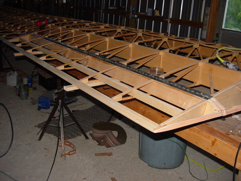

Message 13
| Subject: | Re: Aileron Hinge |
I don't have many pictures. I cut a 1/16" groove in the edges and epoxied 0.060
hinges in the groove. Then I put a pins through it to have an extra margin of
safety just in case the epoxy wants to turn loose. I also made those members
where the hinges go 1/2" wider(front to back) to accommodate cutting the groove
in them. It probably wasn't necessary but if I wear suspenders I wear a belt
also. Thickness is the same as the drawings. I got the slot cutters at Harbor
Freight for use on a router but wound up using my drill press with a fence on
the table so I had better control over it. I will drill the ends of the hinges
and use cotter pins to secure the hinge stainless hinge pin. I tried drilling
the pins but that stainless is hard as woodpecker lips. Don't ask how many
1/16 drills I broke until I finally woke up! There is also angles sawed on them
so they don't bind when moved. Set the saw on 15 degrees and the fence so it
leaves about 1/4" flat. That will let you have 30 degrees movement each way from
center.
Jerry Dotson
59 Daniel Johnson Rd
Baker, FL 32531
Started building NX510JD July, 2009
wing, tailfeathers done
using Lycoming O-235
http://forums.matronics.com/viewtopic.php?p=325055#325055
http://forums.matronics.com//files/elev_close_8x6_652.jpg
http://forums.matronics.com//files/elevator_hinge_8x6_124.jpg
Message 14
Thanks Jack on your advise on the full span piano hinge serving a dual purpose.
Just to clarify, the wings were built by someone else who started the project
and he had used the strap hinges and welded the loops closed causing distortion
and poor alignment of the hinge half's. A gap of 3/8" was maintained between
the aileron beams as per drawings, so to replace the strap hinges with a continuous
piano hinge, I would have to mount the hinge on the flat similar to what
Jerry has done in order to keep the trailing edges of the wing and aileron
aligned due to the existing gap.
Although I would prefer the method used by Mike Cuy (as per his pics on Westcoast
Piet) and I think yours Jack, would there be any structural integrity differences
between the two?
Jerry could you give me the opened size of the hinge if you know it off hand
Thanks again in advance for you inputs.
Adrian M
Winnipeg, MB
Canada
http://forums.matronics.com/viewtopic.php?p=325057#325057

ose. Just to clarify, the wings were built by someone else who started the
project and he had used the strap hinges and welded the loops closed causin
g distortion and poor alignment of the hinge half's. A gap of 3/8" was main
tained between the aileron beams as per drawings, so to replace the strap h
inges with a continuous piano hinge, I would have to mount the hinge on the
flat similar to what Jerry has done in order to keep the trailing edges of
the wing and aileron aligned due to the existing gap.
tcoast Piet) and I think yours Jack, would there be any structural integrit
y differences between the two?
d
Adrian M
Winnipeg, MB
Canada
The hinge is 1 1/2 inches wide with a 1/8" pin. I turned the rounded part down
so it would be smooth on top and that made for a 1/4 gap underneath.
Jerry Dotson
Baker, FL 32531
http://forums.matronics.com/viewtopic.php?p=325061#325061
