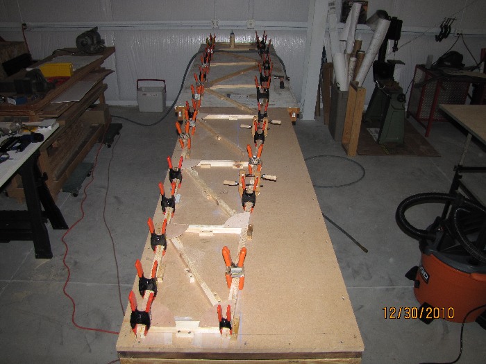

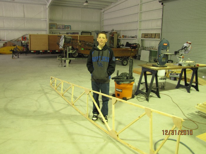

| Subject:  | Got My Fuselage Started |
      I'm really excited now.  Spent last week at my grandpa's (Captain) hangar and started
      building the fuselage.  OK, it's just the mock-up fuselage, but we are
      building it to specifications with the correct size longerons and braces.  That
      way I'll get more practice fitting the joints and discovering any problems before
      we do the real thing.  Here are a couple of pictures.
      Tucker
      http://forums.matronics.com/viewtopic.php?p=325331#325331
      > and started building the fuselage.  OK, it's just the mock-up fuselage,
      > but we are building it to specifications with the correct size longerons
      > and braces.  That way I'll get more practice fitting the joints and
      > discovering any problems before we do the real thing.  Here are a couple
      > of pictures.
      > Tucker

      Wow, have never seen a full length fuselage mock cockpit, but its just scrap
      wood, why not? As I have said one of the best things about building a mock
      fuselage besides testing seating size and angles is learning how the whole
      thing goes together before you start cutting up the expensive wood. Off to a
      great start Tucker.
      And one other thing, turned upside down it makes a great landing gear
      building jig (I tack welded my parts which were bolted to it and if it
      started  to burn I just dumped some water, or beer on the wood and keep
      welding), so don't throw it away too soon.
      rick

      Yep.  Tacking the landing gear is the #1 reason that we are building the mock-up.
      Captain said that whole fuselage only took $24 worth of 2x4's, which we ripped
      on the tablesaw, and we already had some scrap 1/8" & 1/4" plywood.  Can't
      wait to sit in it.
      Tucker
      started building the fuselage. OK, it's just the mock-up fuselage, but we are
      >  Tucker

      Great job, Tucker.  Appreciate the updates.
      You do such nice work, Jack!
