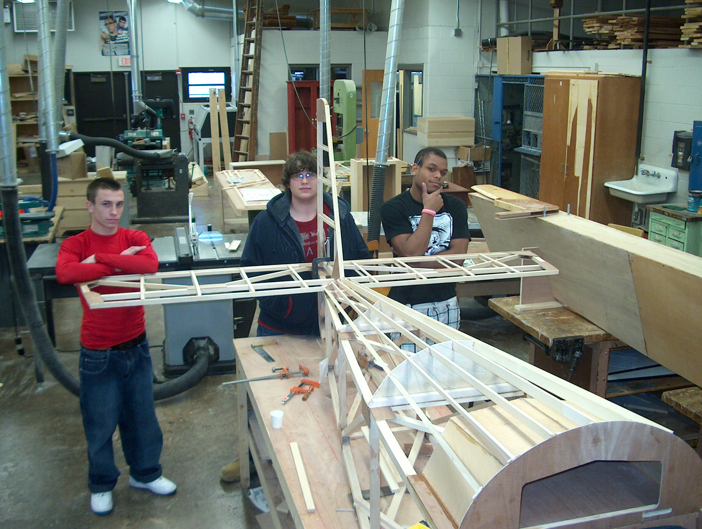

I'm a new guy, woodshop teacher, building a Piet with 12 students. Our fuselage
is making progress. What tailwheel is recommended for the Piet. We plan on
using 600-6 tires and springs instead of bungee cords. Would appreciate any help
possible. Flyboy from Berwick PA
http://forums.matronics.com/viewtopic.php?p=325805#325805
http://forums.matronics.com//files/pontoon_project_055_881.jpg
