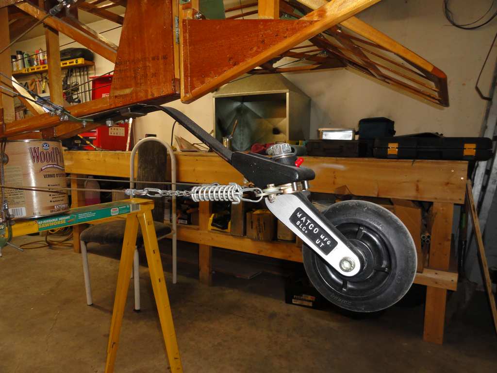

The setup I used was a Matco tailwheel AS&S PN# 06-01615 and single leaf spring
PN# 06-14500. Untested but I think will work fine and relatively inexpensive.
Adrian M
Winnipeg, MB
Canada

Thanks Adrian, kids love the project.
________________________________________
From: owner-pietenpol-list-server@matronics.com [owner-pietenpol-list-server@matronics.com]
on behalf of pineymb [airltd@mts.net]
Sent: Tuesday, January 11, 2011 8:03 AM
Subject: Pietenpol-List: Re: Tail wheel
Adrian M
Winnipeg, MB
Canada
http://forums.matronics.com/viewtopic.php?p=326471#326471
http://forums.matronics.com//files/dscn0057_988.jpg
http://forums.matronics.com//files/dsc00081_959.jpg

Rick Holland
Castle Rock, Colorado
"Logic is a wreath of pretty flowers, that smell bad"

> That's the same one I have Charles. Used with a used J3 two piece leaf
> spring I got off ebay.
> rick

Message 68
Flyboy wrote:
> I'm a new guy, woodshop teacher, building a Piet with 12 students. Our fuselage
is making progress. What tailwheel is recommended for the Piet. We plan on
using 600-6 tires and springs instead of bungee cords. Would appreciate any
help possible. Flyboy from Berwick PA
Hey Teach,
can you hit
enter every
once in a
while? :D
Blue
http://forums.matronics.com/viewtopic.php?p=326621#326621
