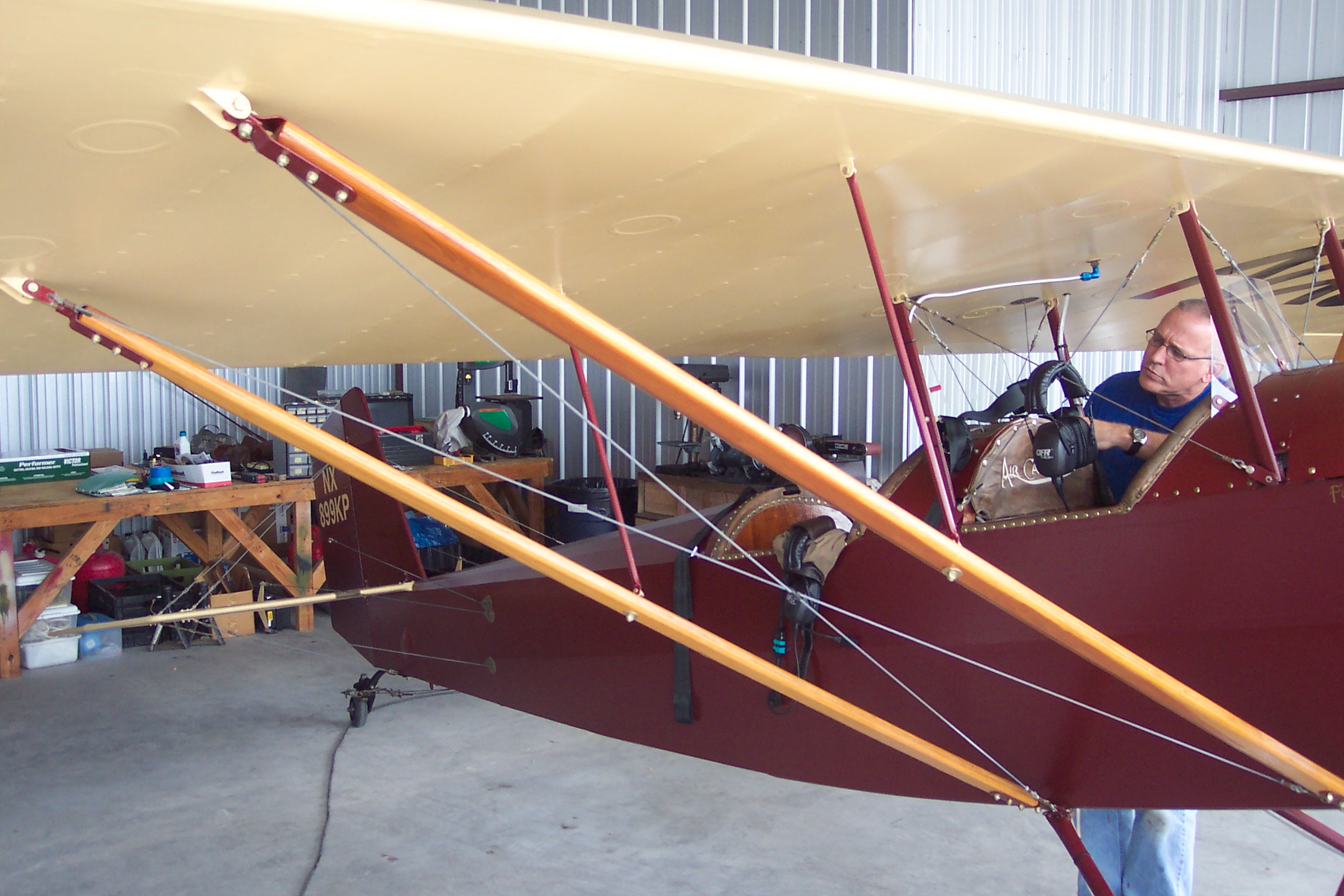

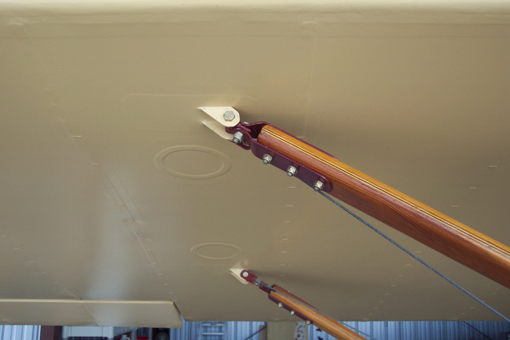

Message 5
| Subject:  | Re: Adjustable Wood Wing Strut Fitting |
      In response to some of the comments re the bolt pattern, embedded
      steel, etc.  Michael said this was a preliminary drawing and I take it
      as such, but the concept is sound, I think.
      As for embedding steel in the wood strut, unless you were going to do
      that the entire length of the strut and use only the steel for
      attachment, what would be the point?  Would not short lengths of steel
      be as prone to tear-out as the bolts?  You could epoxy them in I
      suppose, but I've never been that impressed with the bonding strength
      of epoxy to steel.  If you went with full length steel, what's the
      point to wood struts except appearance?
      As I stated in my original post asking bout this option, I'm making
      laminated struts with embedded carbon fiber running the length of the
      strut and additional fiber running 90 degrees to that at the ends.  Of
      course there will be jury struts.   Laminations will probably be done
      with West System epoxy.  Does anyone find fault with that approach?
      KIp Gardner
      On Jan 11, 2011, at 9:05 PM, Michael Perez wrote:
      > For whomever it was asking, here is a simple drawing of a simple
      > idea. There is a lot of room for change and improvement here, this
      > was what I came up with right off the bat.
      > Michael Perez
      > Karetaker Aero
      > www.karetakeraero.com
      > <Adjustable Wood Wing Strut Fitting.JPG>

Message 7
      Kip wrote:
      "If you went with full length steel, what's the point to wood struts except appearance?"
      Well, IS there another reason to go with wood struts, other than appearance?
      Don't get me wrong, I really like the look of wood struts, and I have an idea that
      I think will work, but need to prove it out before sharing it with everyone.
      I just don't know of a reason why anyone would use wood struts rather than
      steel, other than for appearance.
      Bill C.
      http://forums.matronics.com/viewtopic.php?p=326666#326666

Message 17
      Michael,
      Here are some photos of Kevin Purtee's Fat Bottom Girl that may help.
      Curt Merdan
      Flower Mound, TX
      http://forums.matronics.com/viewtopic.php?p=326700#326700
      http://forums.matronics.com//files/100_1161_113.jpg
      http://forums.matronics.com//files/100_1160_203.jpg
      http://forums.matronics.com//files/100_1145_100.jpg

Message 20
      Thanks Curt!
      Kip G.
      On Jan 12, 2011, at 12:00 PM, Piet2112 wrote:
      > Michael,
      > Curt Merdan
      > Flower Mound, TX
      You mean like these two? The first flew for many
      years didn't it? There was an article way back then
      on the construction of these struts. Wood is just
      as much an engineering material as steel, aluminum,
      carbon fiber or anything else. You just have to
      work within it's strengths. Which means you have
      to know them. In this case it's "shear parallel to the
      grain" in the chart I've sent. Bolts in wood tend to
      pull a plug the width of the bolt out. This means
      you have two surfaces to calculate for. This means
      that if you have a bolt 1" from the end of a board
      and it's 1" thick you have 1X1+1X1 surface area.
      In Sitka that means it will take 2,240 lb to pull
      that bolt out, West. Hem.=2,340 lb and DG fir,
      only 2,280.
      If you're going to be doing your own thing with wood
      then please cut+paste this chart and use it.
      It always seems incredible to me that we trust ourselves
      to wood spars without a thought but can't get heads
      around anything else made of it. :-)
      Clif
      Hey Clif
      I know its late and I'm rubbing my eyes but are those horner wingtips on
      N3513 if so do they really make a difference?
      Kim
      I just found the March 1970 Sport Flying mag with the
      article on this plane. It's Clyde Buckley's. It appears
      that the tip bows have been left off leaving a flat tip.
      There's no plate there. I've never liked those things.
      I think they're supremely ugly and I notice nobody
      is using them. There are other things that are, like
      drooped tips and winglets. It makes me wonder why.
      Even flat tips like these look, to me anyway, kind of
      sawed off, unfinished.
      Oh, by the way, has anyone ever heard of  "cellulose
      reinforced lignin composite"?
      Clif
      > Hey Clif
      > Kim
