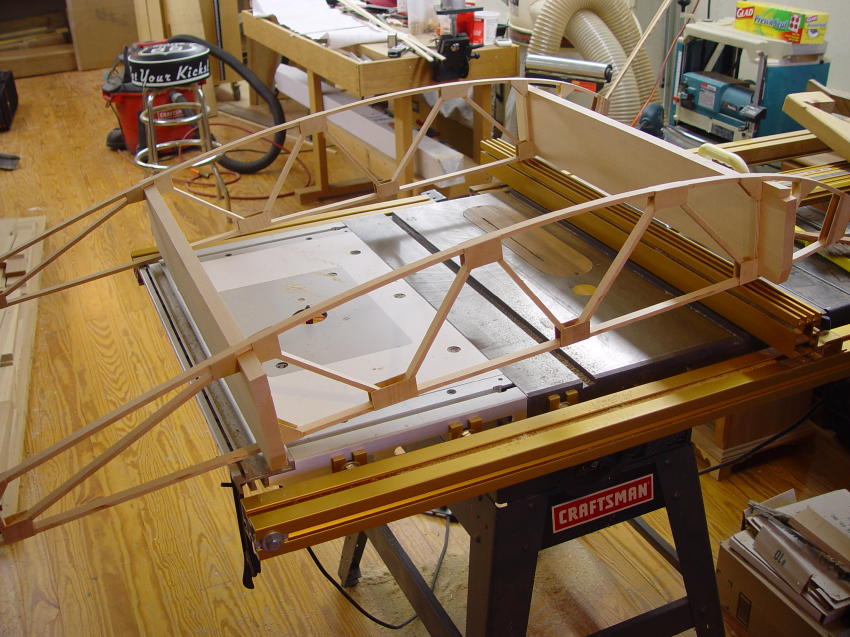

Message 7
| Subject: | Center section butt ribs |
On the three piece wing center section ribs, I see nothing in the plans to indicate
that they should be sheathed on one side with plywood or receive extra diagonals
and gussets as the wing end ribs call for. However, in looking at all
the pictures I could find, it appears many do so. What's up with that?
John
http://forums.matronics.com/viewtopic.php?p=327537#327537
Message 8
| Subject: | Re: cloth used for Fiberglass fuel tank |
I wonder what other builders of 3-piece wings have done on what I call
the center section joint strap/cabane fittings problem? I just don't
see how Tom is going to put that subassembly in place without
practically destroying the butt ribs.

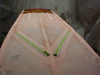

Message 11
| Subject: | Re: Where to locate rear bottom inspection plate |
I plan on using a method called out in the Boredom Fighter plans by Don Wolf.
Sew Dacron tape to each side of two 18-inch zippers with excess protruding past
each end (to be trimmed at installation). Cover the teeth with masking tape
and install during tape application of the covering process. When cover and
painting is done, remove masking tape, open zippers and cut fabric underneath
with a razor blade.
I found that Polyfiber remained flexible enough not to crack after numerous annuals
(or condition inspections) and this provided plenty of access. I tied the
two zipper pulls together with rib-lacing cord during operation.
I did no engineering or calculations and no numbers were harmed during application
or use. Use at your own peril.
http://forums.matronics.com/viewtopic.php?p=327551#327551
http://forums.matronics.com//files/zippers_108.bmp
Message 12
| Subject: | Re: Center section butt ribs |
The wingtip end ribs need the extra verticals to keep the covering from
warping the rib down when the fabric is stretched. I put a 2 inch wide
strip of 1/16 in plywood sheeting on the flight surfaces of my center
section end ribs to keep the covering from pulling them outward when
stretched. I still got a little bit of a warp on the top of the wing
after the fabric was fully stretched. The butt end of the wing I just
covered in fabric, and put the verticals in there too, but dont think
they are necessary.
Ben Charvet
NX866BC
Nearly time for my first annual condition insp.

Message 16
Thanks Ben, that's pretty much how the plan looks. Do you glue the uprights to
the spars? The plan shows nails only. If they are glued it would look to me
to be a pretty messy job being how they have to slide on and the tight fit.
John
http://forums.matronics.com/viewtopic.php?p=327603#327603
Message 17
I added 1/16-inch plywood to the center section end ribs in case I use it as a
storage locker instead of a fuel tank. I did not use it on the wing panels.
I added braces to the end ribs like the plans show.
Also, I glued the ribs to the spars because I didn't know some people say not to.
I'm not sure the correct answer.
Chris

Message 18
What are the pros and cons of putting a fuel tank in the wing or using it for storage?
What are most doing?
Attached a couple of pics of my progress.
John
http://forums.matronics.com/viewtopic.php?p=327610#327610
http://forums.matronics.com//files/progress_007_2_218.jpg
http://forums.matronics.com//files/progress_001_2_692.jpg
Message 19
Pros: 1) Center of Gravity does not change as fuel is burned. 2) You can
always have a nose tank (header tank) in addition if you want extra range
or put your storage area in the nose.
Cons: 1) Any fuel you spill goes directly into the pilot's seat where it
lies in wait; 2) You have to have a ladder to get the fuel up there. 3)
Unsightly hoses, valves, fuel guage, etc. hanging down below the wing (and
directly over the passenger's head.)
Hum, that seems to come out in favor of putting the tank in the nose which
is probably why I chose to put mine in the center section.
Stinemetze
>>> "Kringle" <Mrkringles@msn.com> 1/19/2011 3:32 PM >>>
for storage? What are most doing?
Message 20
Hey John
You may have thought this through already, but just in case: drill before
gluing.
It's a lot easier to drill the center section spars for the straps and other
hardware BEFORE you glue the ribs and other bracing in place. I drilled
after glueing and it was hard to measure and drill accurately with all that
stuff in the way.
Ken
> John
Ken Chambers
512-796-1798
Message 21
Good point Ken. That was my plan but I was trying to see how things were going
to fit together. Kinda fun actually putting some parts together!
John
http://forums.matronics.com/viewtopic.php?p=327617#327617
