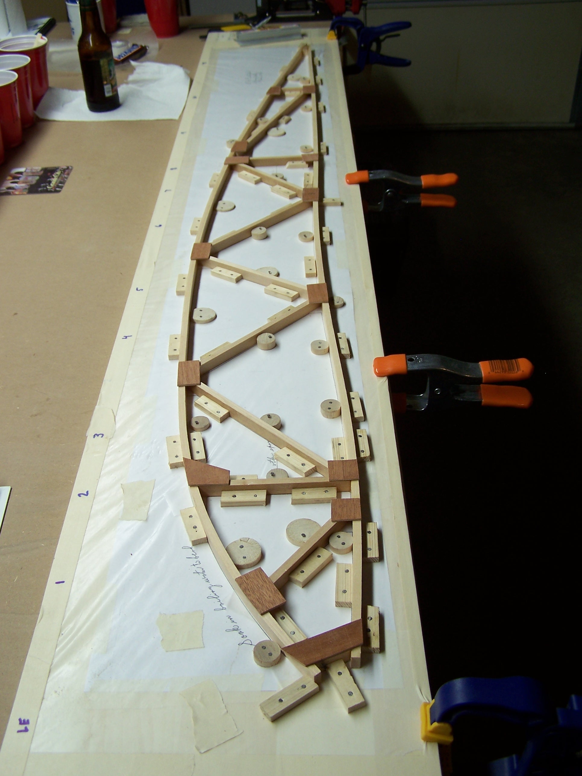

      Gary, I averaged one rib per day when I was in the rib mode.  Of course I'm
      retired (retarded).  I had kind of an assembly line going.  First, I took
      yesterday's rib out of the jig, took the top rib cap for today's rib off the
      prebending jig and put it in the rib jig, then the bottom rib cap, then cut
      the connecting members per a prearranged plan, glued the members and
      installed the top-side gussets (precut).  I then put the gussets on the back
      of yesterday's rib.  Last I took a rib cap out of the soaker and put it in
      the prebending jig.  Last I put another rib cap in the soaker, left the shop
      and closed the door.  It was really the most enjoyable part of the project.

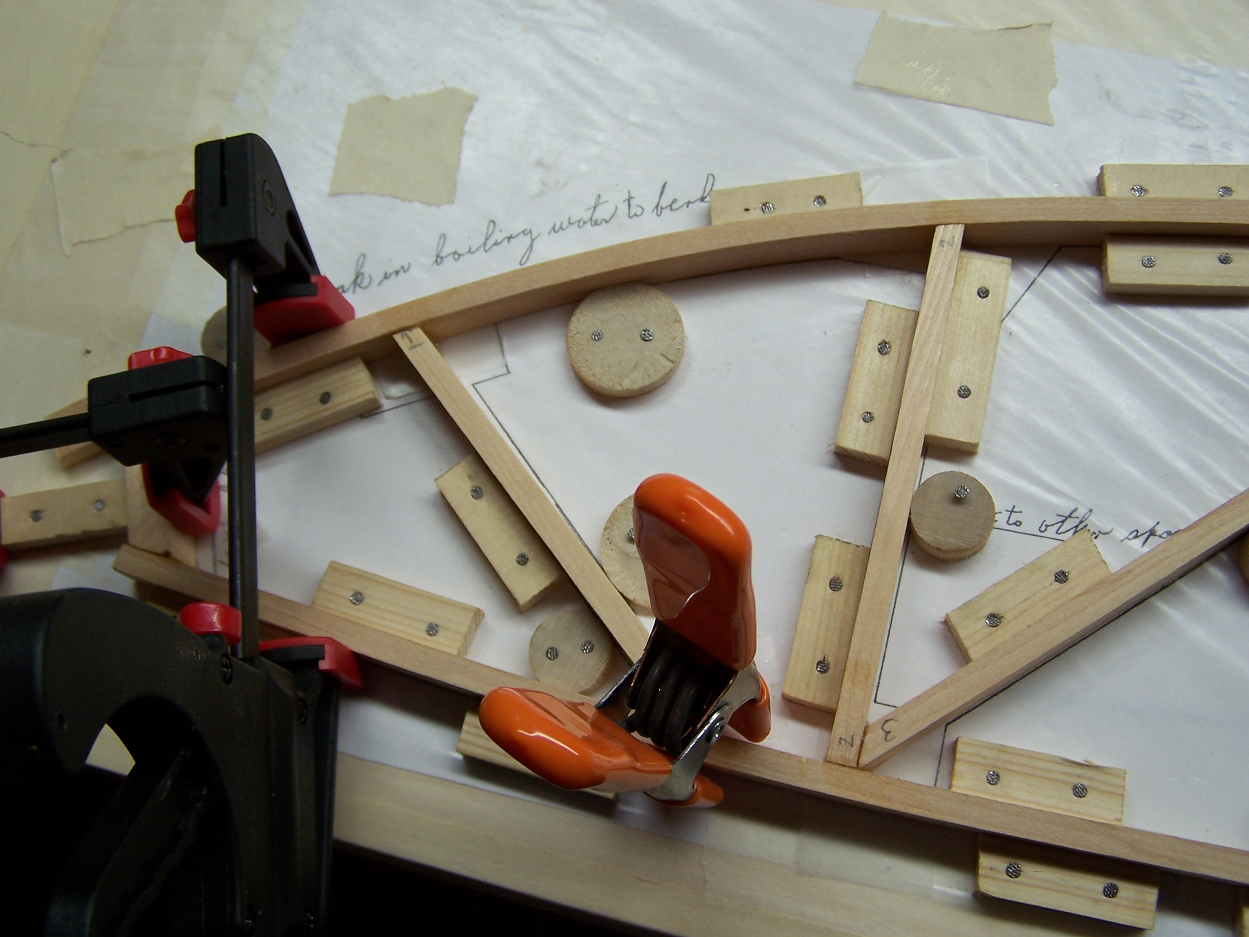

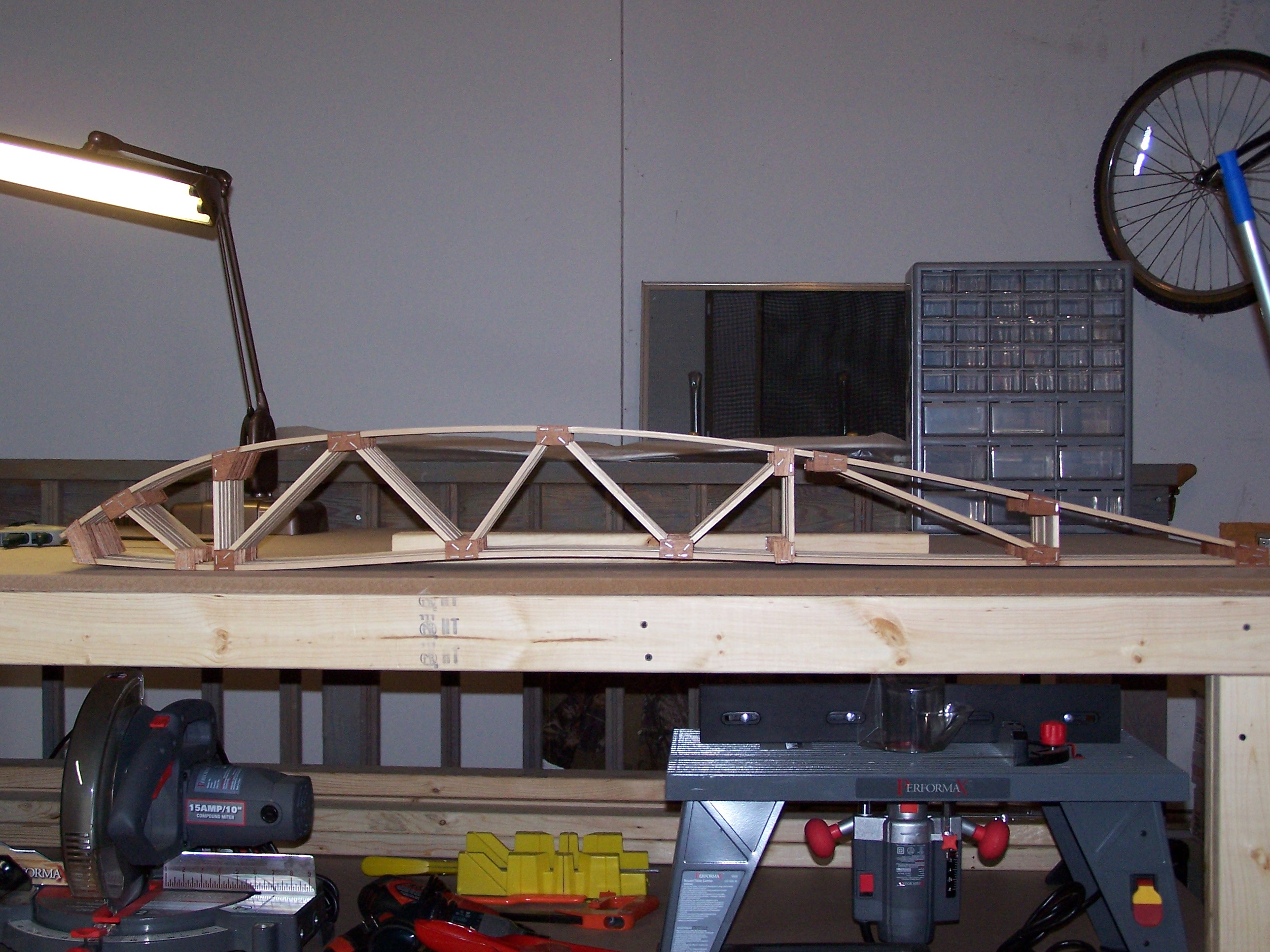

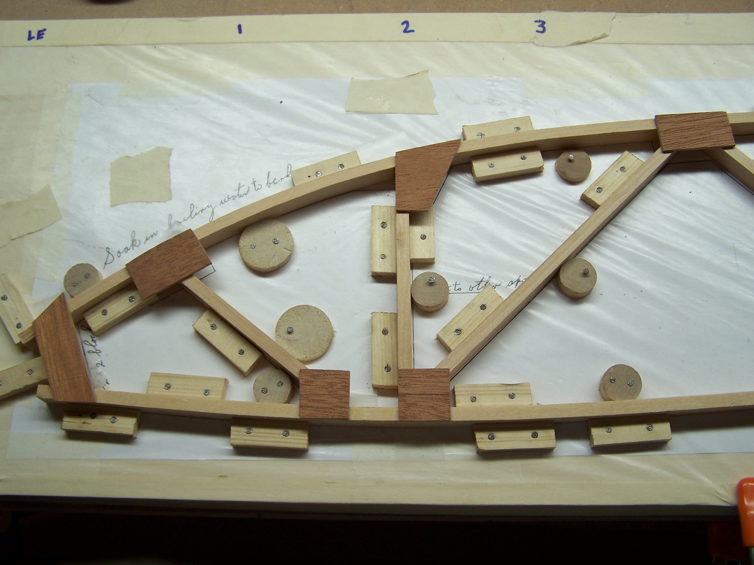

      I've added a few pictures--nothing that hasn't been seen before dozens of times
      on this forum, but since you've asked.
      Maybe when the weather warms up I can swing up and take a look at your progress.
      I'm still interested in that Corvair engine. . .

      Very nice, Tom.
