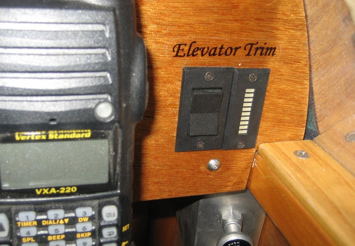

| Subject: | Re: Trim set ups |
What kind of car did the mirror motor come out of? I'm definitely
interested. Chuck
----- Original Message -----
From: "Ozarkflyer" <lragan@hotmail.com>
Sent: Monday, January 24, 2011 11:34 PM
Subject: Pietenpol-List: Re: Trim set ups
> Hopefully this link works
> http://krbuilder.org/Trim/index.html
> http://forums.matronics.com/viewtopic.php?p=328357#328357

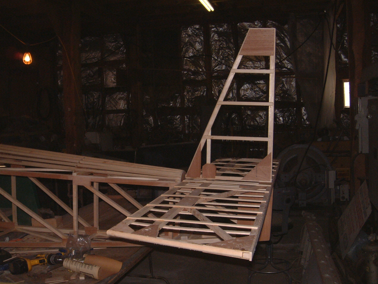

| Subject: | Re: 1932 vs. 1933 empennage? |
Tom,I don't know the difference in flight characteristics but I built a combination
of the two empenages,a squared off 33.I don't see why you couldn't just cut
the mid spar and braces then assemble it with the stuff you already cut.You'd
just have an improved 32.Dave
Covering Piet
http://forums.matronics.com/viewtopic.php?p=328379#328379

Message 6
I would think you would definitely want to add the bracing, for some extra strength.
The longer fuselage would not need as much horizontal control surface as
the shorter one, because of the leverage moment being larger, so it might be
a little more sensitive on control input from the elevator, than it would be
with the short fuselage. I read someone's comment that the elevator was a tad
sensitive on someone's airplane, but I don't know which elevator they used. The
"New Improved" elevator sounds like it is larger than what you have set up,
so I would think you would be good with what you have. I would definitely add
the diagonal braces, though, as I mentioned at first. My 2 cents worth.
Since horizontals are being discussed, are the horizontal portions of the empennage
mounted so they can be removed when the airplane is moved from the house
to the airport for final assembly? I don't have plans (again) yet, and at the
rate things are going, it will be a long time before I have to be concerned about
this, but I was wondering.
HOMEBUILDER
Will WORK for Spruce
Long flights, smooth air, and soft landings,
GliderMike, aka Mike Glasgow
http://forums.matronics.com/viewtopic.php?p=328394#328394

Message 13
The FGM plans have about 8% more surface are on the horizontal stabilizer and about
the same less on the elevator so the total control surface area is pretty
darn close between the two plans. The ratio of movable to fixed is a bit lower
so you might need a bit more elevator movement to provide the same authority.
The diagonal braces may help stiffen the stab to take the reactive force when the
elevators are moved. They also might be belt and suspenders since the stab
is attached to the fuselage in a manner that would keep it from going parallelogram
and if you rib laced the fabric on, that would also help keep things in
alignment.
Putting in some sort of diagonals shouldn't be too much aggravation if you haven't
glued the thin strips on both sides yet. Even the narrower strips are pretty
strong so the FGM plans should be good for them. They keep the leading and
trailing edge parallel and are structural primarily in compression. If there's
any doubt as to strength, take 2 scraps about a foot long, glue them into
a Tee and start piling weight on them.
My $.02 and I'm an electrical engineer.
Dave Aldrich

Just a quick comment on Rick's trim switch.
Rick, are you forgetting that the Pietenpol is a 1930's aircraft.
The font you used to label the digital trim switch doesn't quite look "period".
I'll shut up now.
BC
http://forums.matronics.com/viewtopic.php?p=328433#328433

Don't tell Dan...
Gary
-----Original Message-----
[mailto:owner-pietenpol-list-server@matronics.com] On Behalf Of Bill Church
Sent: Tuesday, January 25, 2011 9:22 AM
"period". :)
I'll shut up now.
BC
http://forums.matronics.com//files/trim_switch_161.jpg

Now you have really stepped over the line Bill!
Labeling a 21st century technology switch with a 1929 period correct font
would be like installing "Pimp my ride" still spinning after you stop hub
caps to a perfectly restored 1932 Ford coupe.
But of course my Piet isn't perfect like yours.
rick
> "period". :)
> I'll shut up now.
> BC
> do not archive
Rick Holland
Castle Rock, Colorado
"Logic is a wreath of pretty flowers, that smell bad"
Elevator Size. On the Piet that I bought (NX29NX) has a large elevator that
comes close to the ground. I personally feel it is too large a surface
area, and is overly sensitive in the ground effect (t.o. and landing).
Everyone who flys it for the first time gets a surprise on its sensitivity,
and has to remind himself to use very small and light elevator inputs. If
I were ever to build the elevator again, I would make it about 1/4 to 1/3
less area. Brad Williams

Message 30
Couldn't you also use a shorter bell-crank to provide less elevator
deflection?
On Tue, Jan 25, 2011 at 12:06 PM, bradandlinda tds.net <bradandlinda@tds.net
> that comes close to the ground. I personally feel it is too large a surface
