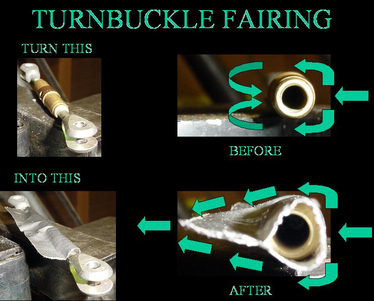

| Subject: | Re: Brace cables, pulleys, wing supports |
While working on streamlining your Piet, don't forget turnbuckle fairings. Here's
an example of a simple installation.
http://forums.matronics.com/viewtopic.php?p=328682#328682
http://forums.matronics.com//files/turnbuckle_fairing_176.jpg
All of my turnbuckles are in line with the slip stream - not crosswise.
What can we do to reduce the drag on those?
----- Original Message -----
From: "BYD" <billsayre@ymail.com>
Sent: Thursday, January 27, 2011 10:22 AM
Subject: Pietenpol-List: Re: Brace cables, pulleys, wing supports
> Here's an example of a simple installation.

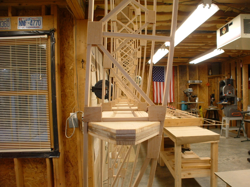

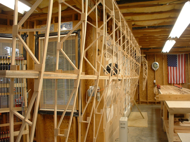

Message 25
| Subject: | Wing Construction |

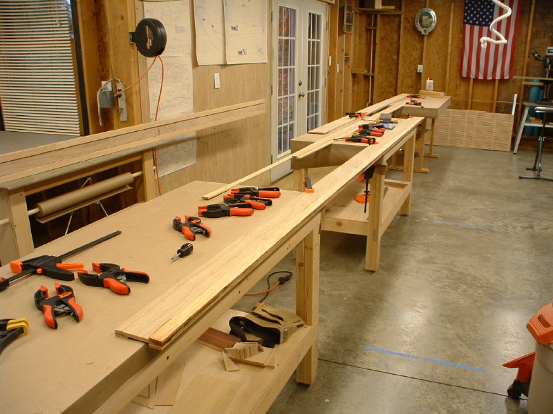

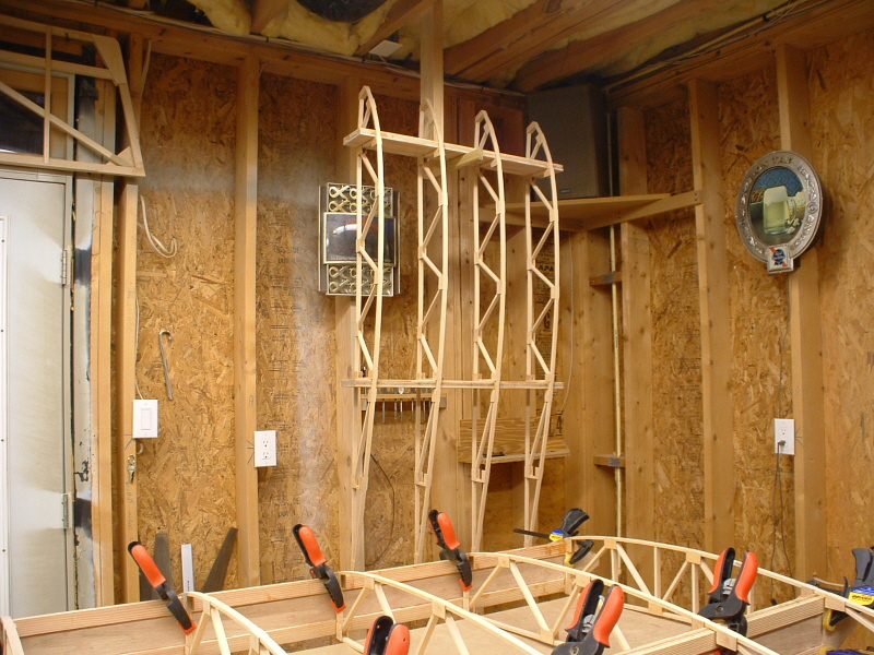

Making progress on my Piet. Wanted to share some pictures.
Chuck
Raleigh NC
http://forums.matronics.com/viewtopic.php?p=328752#328752
http://forums.matronics.com//files/left_wing_1_s_138.jpg
http://forums.matronics.com//files/center_section_s_177.jpg
http://forums.matronics.com//files/right_wing_3_s_160.jpg
http://forums.matronics.com//files/right_wing_2_s_137.jpg
http://forums.matronics.com//files/right_wing_1_s_193.jpg
http://forums.matronics.com//files/left_wing_4_s_219.jpg
http://forums.matronics.com//files/left_wing_2_s_214.jpg
http://forums.matronics.com//files/spars_005_s_112.jpg

| Subject: | Re: Wing Construction |
Looks tremendous Chuck! Thanks for sharing,
Ryan
Nice... very exciting when all those ribs start to look like a wing.
Mark Chouinard
Very nice, Chuck! I see the obligatory view down the center of the ribs, and
old license plates affixed to the wall...very important! A bonafide shop...
Gary Boothe

How about covering the gap between the fwd and aft lift struts with fabric,
like a wing, better yet clear mylar as to not disturb the visibility from
the cockpit.
ha ha
Shad
Don't archive
--- On Thu, 1/27/11, Ryan Mueller <rmueller23@gmail.com> wrote:
From: Ryan Mueller <rmueller23@gmail.com>
Subject: Re: Pietenpol-List: Re: Brace cables, pulleys, wing supports
We must not forget our big fat heads sticking out of the cockpit. Should pi
ck up one of these to reduce the drag:
The aerodynamic effectiveness of streamlining the turnbuckles with duct tap
e is increased if the pilot can look just as stupid as the aircraft.... -
Ryan
On Thu, Jan 27, 2011 at 1:49 PM, Charles Campbell <cncampbell@windstream.ne
t> wrote:
ream.net>
All of my turnbuckles are in line with the slip stream - not crosswise. Wha
----- Original Message ----- From: "BYD" <billsayre@ymail.com>
i look forward to that day... it looks great
what size plywood web is that if you don't mind me asking ??
jeff
http://forums.matronics.com/viewtopic.php?p=328769#328769

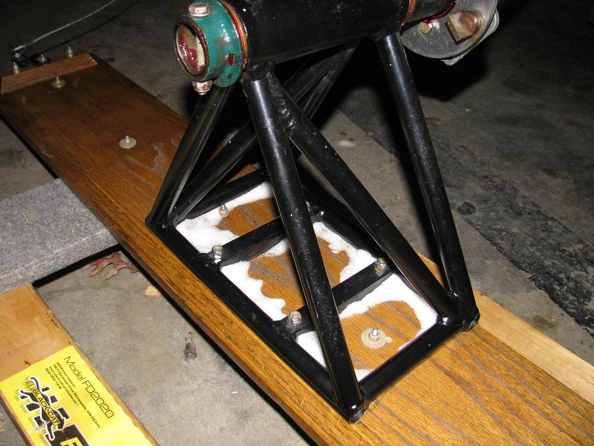

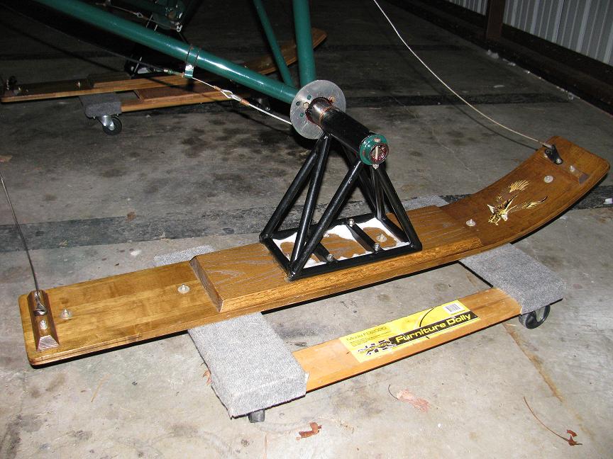

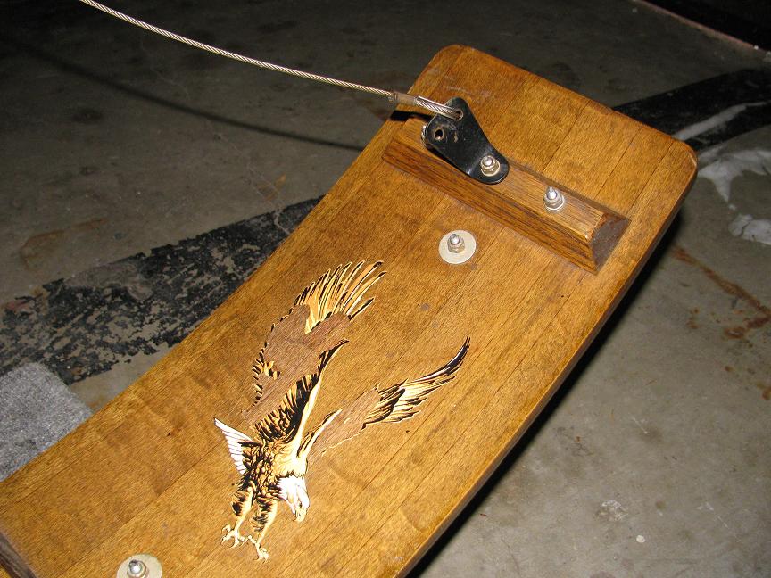

looking forward to some spars
jeff
http://forums.matronics.com/viewtopic.php?p=328770#328770
http://forums.matronics.com//files/emount_590.jpg
"what size plywood web is that?"
I used 3/8 for the web. 1/4 for the fillers.
Chuck Borsuk=0A=0A=0A

Very nice, Chuck.

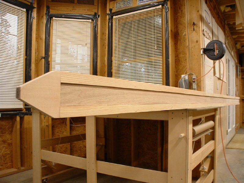

Tell us a little about your spars. What material did you use for the web and
flanges? What are the dimensions?
Greg Cardinal
It smacks a bit of the Mike Cuy method of building a nice spar....
I used a combination of quarter-inch and three-eighth marine ply, doug fir and
spruce. I cut the 3/8 ply to width and scarfed two pieces together. After a lot
of trial and error on getting the scarf joints to work, I came up with a solution
using my table saw. I am very pleased with the result. I can go into more
detail on how I did this if needed. I then ripped the doug fir for the top and
bottom of the spars and scarfed those together. I used the quarter-inch ply
to fill in the middle and end of the spars. I had some left over spruce that
I planed down for the tips.
Results:
Time: This method takes much longer than using solid spruce and routing out the
spars.
Money: I saved a bunch of money. I figure I spent about $300 total for all the
material. I was able to buy the marine ply and doug fir local.
Weight: Based on what I have been able to determine using info in the forum, they
weigh slightly less than the routed spruce spars.
Strength: I am sure this could be debated, but I think they are stronger than the
spruce.
As stated many times in this forum, I find that working with spruce is much more
enjoyable than working with the doug fir. Spruce is just a joy to work with.
With the doug fir plan on many splinters. All my ribs are spruce and I did not
get the first splinter.
Overall, I am very pleased with the way the spars turned out.
Dimensions: Approx 5 inches tall (front spar a bit taller than the aft). 7/8 on
the width.
Chuck
http://forums.matronics.com/viewtopic.php?p=328787#328787
