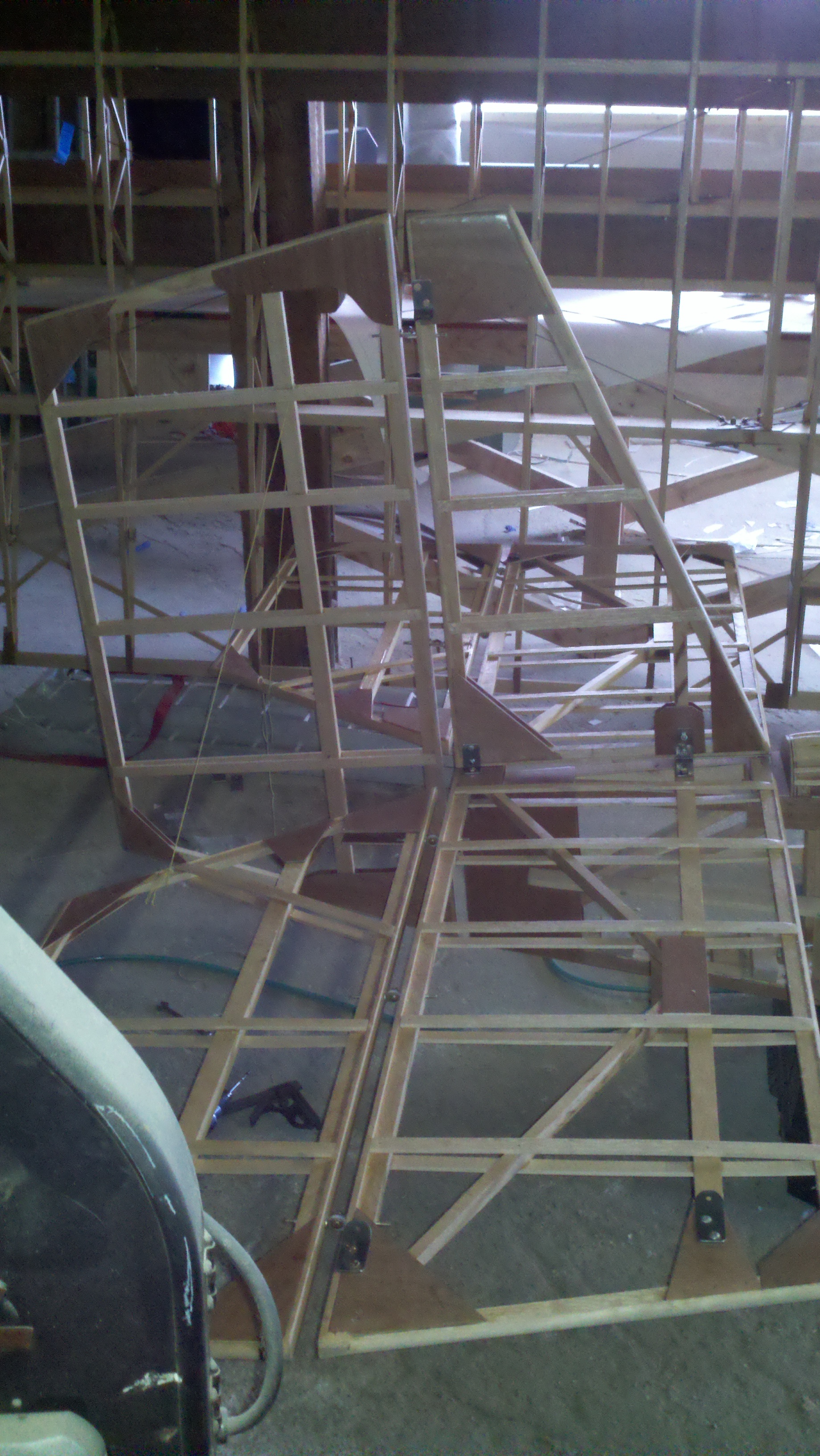

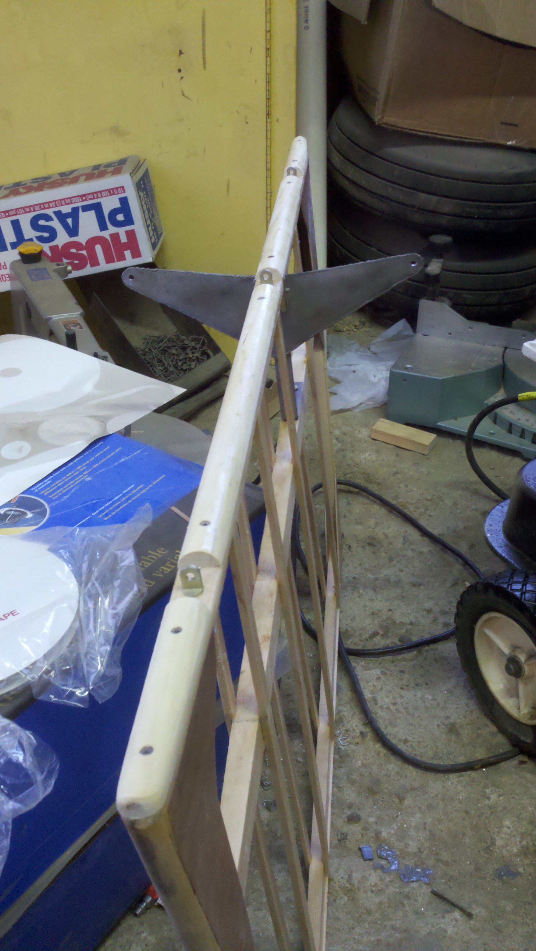

Perry and Dave,
The AS kit is pretty much wrong.You still need 1x1's for the trailing edge of
the fin the leading edge of the rudder.the capstrips are 5/8x3/16 for all the
tailfeathers so it looks like you need to rip the capstrips from the 5/8x1 1/4.One
thing that may make your life easier is to get some 1" dowels and split
them in half and glue the to the leading edges of the elevators and the rudder.Also
if you use 1x1 for the tops and bottom of the fin and rudder and taper them
it will come out alot smoother.Here are a couple of pics.This is just what
I did and I'm sure the are other ways of approching it.Getting started and figuring
out the plans was the best part for me.Dave

Wow, Dan, that's beautiful. After seeing the artistry in your's, mine seems
positively primitive.
Here are some pics of what I did for a step. The length on mine is approx
10 inches, with about half of that extending beyond the side of the
fuselage. It is attached just in front of the forward edge of the
rear seat. The vertical drops are about two inches. I figure it will make
it easier to install the fabric this way. The plate to which the drops are
welded is 0.90 4130. The L-shaped bracket is 0.80 and was cut from a scrap
of rectangular 4130 tubing. All the pieces were from scraps of two sizes of
streamlined tubing from an assortment box that I bought from Wicks years
ago. The wood block is oak; ash would probably be better. Hardware right now
is from Ace. After the metal pieces are cleaned up and painted, the step
will be attached with AN fasteners. Likewise the clothesline isn't
permanent. It is there to check alignment from rudder pedals, etc.
Cheers, Ken
