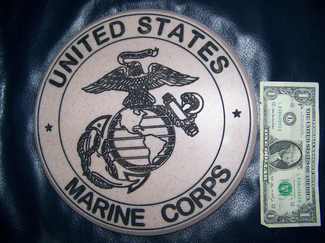

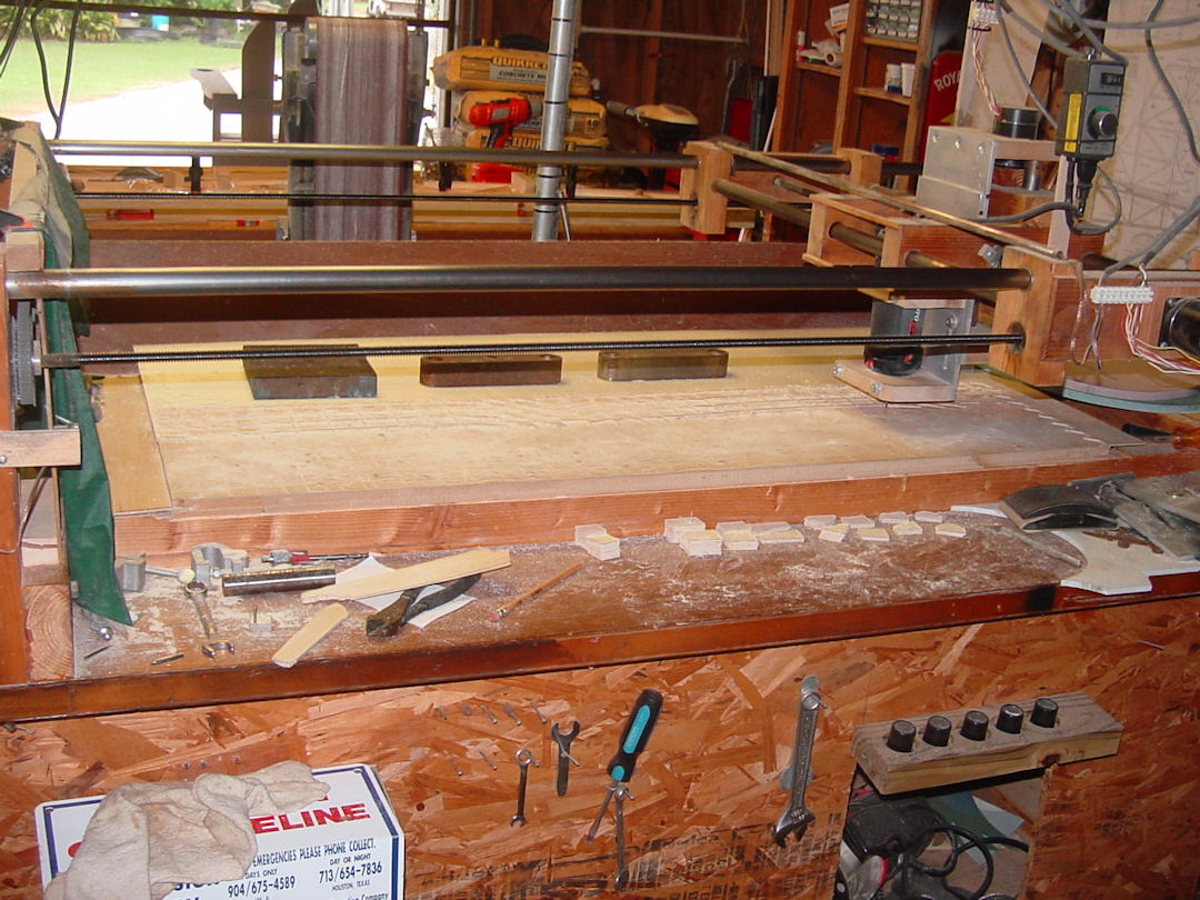

I have a small 18"X48" CNC router. It is pretty crude looking. I built it about
10 years ago from wood to see if the idea would work. The plan was to build it
from steel if it did. It has worked so well I wish I had took more time to make
it look good. It has 0.005" or less repeatability. I cut all the wing rib
gussets and my panel with it. I'm looking for a pretty piece of plywood for my
panels. The one in the picture is just a cheap luan plywood test cut. It only
takes about 5 minutes to cut and drill one. All done with a 1/8" carbide endmill.
The USMC coaster is an engraving gift I made for a Marine currently serving.
It is made from DuPont Corian counter top material.
Jerry Dotson
