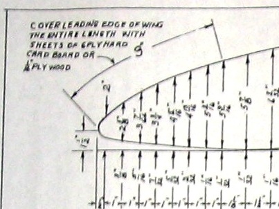

| Subject:  | Re: leading edge plywood |
      Like Jack said,  not per the plans.
      BC
      http://forums.matronics.com/viewtopic.php?p=329636#329636
      http://forums.matronics.com//files/leading_edge_ply_387.jpg

| Subject:  | leading edge plywood |
      Thanks for all the replies on the leading edge - I think I can sort it out
      from what everyone told me.
      Side note in case anyone cares....  I'm working on the center section after
       hastily putting it together in July.  My mother was dying from cancer at t
      he time and we were going to build the CC together.  She ended up getting t
      oo weak too quick and I kept pushing to get the CC done while she was still
       here - just to show her.  In my rush=2C I'm paying for some lack of planni
      ng now.  It's nothing beyond repair but it's gonna be a bit of  a pain.  My
       father has offered to help get it completed in honor of my mom.
      I'm happy to be back in the game making some progress on the Piet.  3 steps
       forward 2 steps back I guess.
      Tom B.
      From: catdesigns@att.net
      Subject: RE: Pietenpol-List: leading edge plywood
      Tom
      Near the
      bottom you will find several pictures of how I did the leading edge
      ply.
      http://westcoastpiet.com/images/Chris%20Tracy/Wings.htm
      If you
      look closely you can see I overlapped the plywood onto the leading edge int
      o a
      recess I left for it. The leading edge (poplar) was finished to shape after
      the plywood was installed.
      Chris
      Sacramento=2C Ca
      Westcoastpiet.com
      [mailto:owner-pietenpol-list-server@matronics.com] On Behalf Of TOM
      MICHELLE BRANT
      Sent: Thursday=2C February 03=2C 2011 6:12 PM
      pietenpol-list@matronics.com
      Subject: Pietenpol-List: leading edge
      plywood
      Maybe a stupid question but I can't figure it out (what's that say
      about me??)
      Where do you start the leading edge plywood from?  If
      you start from the bottom of the leading edge=2C how is it held in place wh
      ile
      gluing - are nails used?  Or do you start it from the top of the leading
      edge and sand it into the curve of the wing?   I just don't see anything in
      the plans for this.
      Thanks=2C
      Tom B.
      href="http://www.matronics.com/Navigator?Pietenpol-List">http://www.matro
