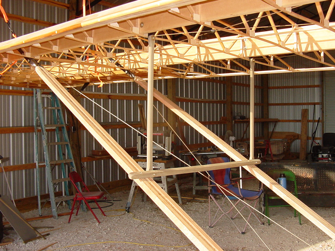

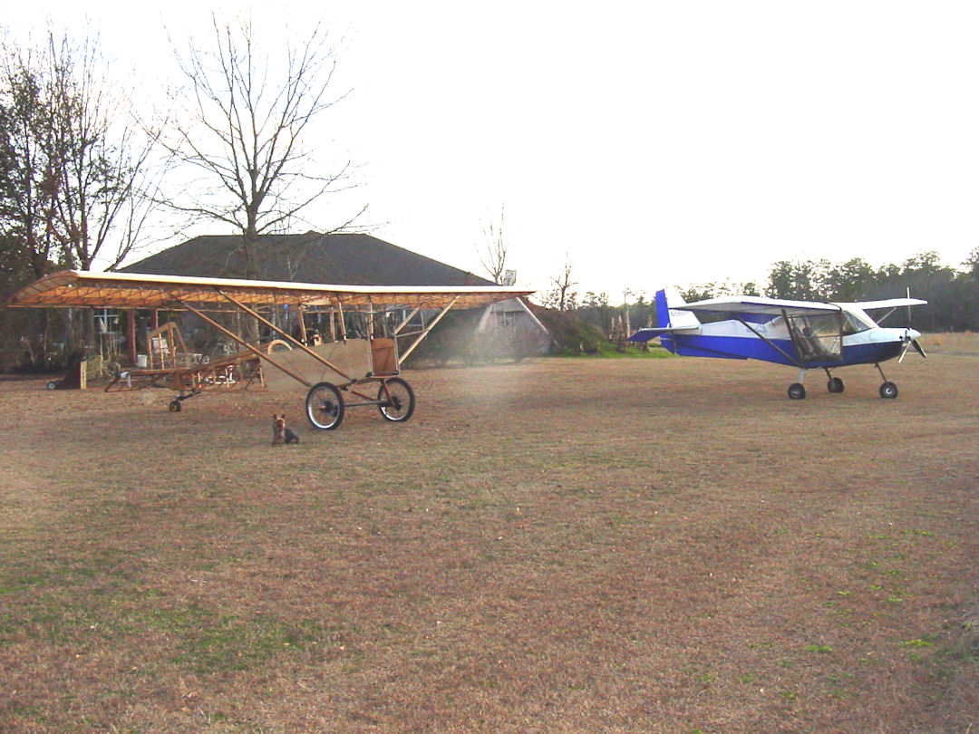

I just can't help my self. We pushed it out this afternoon. Gary Boothe you will
be proud of me. I built the jury struts 100% from poplar.....really it is from
a tulip tree I sawed on my homemade sawmill about 25 or 30 years ago. It looks
just like poplar.
Jerry Dotson

I am proud...and impressed! Is that a Silky Terrier?
Gary

He is a Yorkshire terrier 8 months old. We had an outdoor rat and mouse problem
before "ABE" came on the scene. PETA would not like him. He kills every one he
can find.
