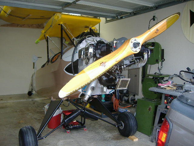

Finally had to get a used prop on Barnstormers. Zeus approves. Hope to be airborne
soon. Sensenich has back order, since government is taking priority for the
UAV's.
Larry.. (Dallas theatre of operations)
http://forums.matronics.com/viewtopic.php?p=332941#332941
http://forums.matronics.com//files/dscf4279_517.jpg
http://forums.matronics.com//files/dscf4271_599.jpg

Jay Anderson, Cloudcars props......hot rod performance, and damn good
looking....
> airborne soon. Sensenich has back order, since government is taking priority
> for the UAV's.

Beautiful, Larry! ...and the prop, too!
Gary
-----Original Message-----
[mailto:owner-pietenpol-list-server@matronics.com] On Behalf Of TriScout
Sent: Sunday, March 06, 2011 2:48 PM
Subject: Pietenpol-List: Piets & Yorkies
for the UAV's.
