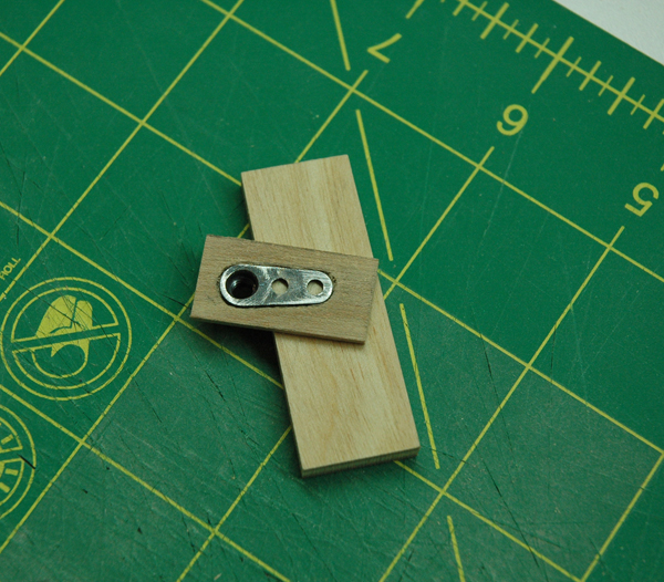

      Hi Everybody-
      Ok- this would have been easier if i would have a noticed it before
      the doubler's were glued in but....
      Any way since I can't get to the outer most hinge screws on the horizontal
      stab. because of the diagonal brace i am wondering if this would work.
      I have recessed an anchor nut into 16th ply and was going to epoxy
      the ply to the back side of the hinge doubler (already glued in  :x !)
      I thought that might be better than trying to get a regular blind nut
      in there or just gluing in a nut.
      thanks for the help-AGAIN!
      Earl
      Earl Brown
      I may not have gone where I intended to go, but I think I have ended up where I
      intended to be.
      http://forums.matronics.com/viewtopic.php?p=333663#333663
      http://forums.matronics.com//files/anchornutd_468.jpg

      Earl,
      I drilled an 1" access hole in mine on one side...same problem.
      Gary Boothe

      I also cut holes that were about an inch around on one side.  I
      elected to cut the holes on what would become the bottom of the
      H-stab, as there is no point in having nice new drain  holes that
      point up. Ken
