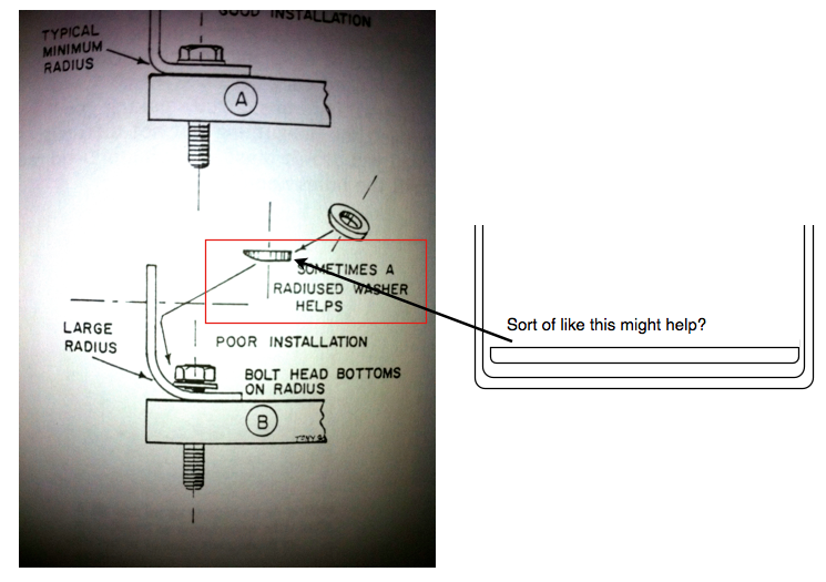

      Last night I began making my cabane fittings for the center section.  After reading
      how to bend the u-shaped material and the minimum radius needed, I proceeded
      to make a fitting.  With this u-shaped piece fitting over the spar, I have
      a good gap in the wood to metal area because of the radiused metal and sharped
      edged wood.  Do most of you sand the wood in that area to fit the radius of
      the metal?
      John

      John, I would recomend not sanding the spar to shape (I could be wrong).-
       My reason for saying that is because the spar "caps" top and bottom edges
      are the most critical, load bearing areas.- Someone else chime in here if
       I am completly wrong, but that is why you can get away with routing out th
      e solid spars in the center, to make the routed I beam.- One possible sol
      ution, is to add a rounded 1/8, or so plywood block to the top of the spar
      to snug up the fit, this would also keep the fitting from cutting into the
      spar cap.- Just make sure to leave the fitting long enough on the bottom
      side to make up for the plywood block thickness.

      I have attached a snapshot taken from one of Tony Bingelis' book showing how to
      deal with radius' corners in metal. I also added a drawing showing how you might
      adapt the idea to your situation. You could cut a metal piece, radius the
      corners, and put it in as a spacer. Does that make sense? Maybe some of the way-more
      experienced builders can comment (I am just starting, so I really know
      next to nothing), but I saw it in Tony's book and thought it might help.
      Semper Fi,

      jarheadpilot82 wrote:
      > John,
      to deal with radius' corners in metal. I also added a drawing showing how you
      might adapt the idea to your situation. You could cut a metal piece, radius the
      way-more experienced builders can comment (I am just starting, so I really know
      next to nothing), but I saw it in Tony's book and thought it might help. I think
      that Shad and I are saying the same thing - I am suggesting metal and I think
      he is suggesting a wood spacer.

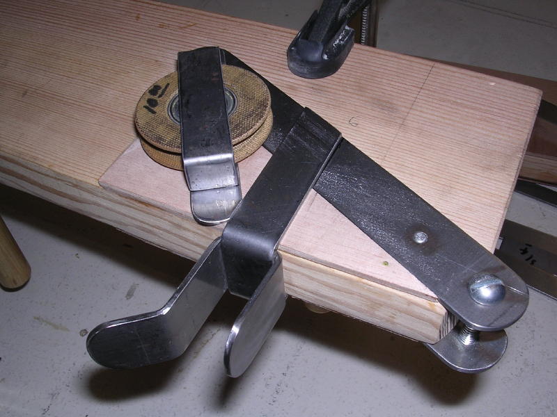

      Perhaps I will use this method as posted by Jack Textor.  With the bending radius
      of the lower piece I may have a hard time holding the 3/4 dimension as per
      the print for the cabane attachment.

      http://forums.matronics.com/viewtopic.php?p=336741#336741
      http://forums.matronics.com//files/mat_pic_480.jpg

      You guys do remember there's another piece of
      U shaped metal that goes in there? Right?
      Clif :-)

      > <jarheadpilot82@hotmail.com>
      > John,
      > how to deal with radius' corners in metal. I also added a drawing showing
      > how you might adapt the idea to your situation. You could cut a metal
      > piece, radius the corners, and put it in as a spacer. Does that make
      > sense? Maybe some of the way-more experienced builders can comment (I am
      > just starting, so I really know next to nothing), but I saw it in Tony's
      > Semper Fi,
      > Terry
      > http://forums.matronics.com/viewtopic.php?p=336726#336726
