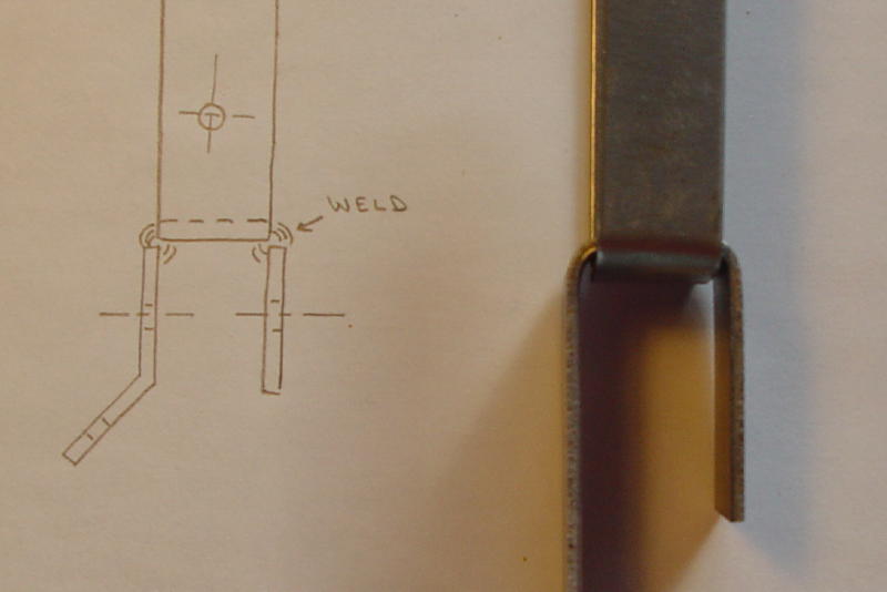

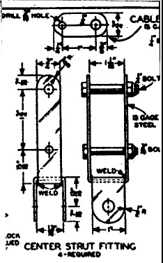

      Let me first make it clear that all of your comments are very appreciated and I
      probably would not be building this aircraft if I did not have the expertise
      and support of this group.  I blame myself for not being clear on the original
      question and will ask it again as the conversation has drifted to wood grain,
      motor mounts and wallpaper.  Please review the attached pic and tell me if is
      okay to modify the cabane fittings as I have seen others do.  The left drawing
      is the way called for in the plans and the right fitting is how I have seen
      others do it.
      Thanks so much
      John
      http://forums.matronics.com/viewtopic.php?p=336992#336992

| Subject:  | Re: Cabane Fittings |
      John,
      I made mine like the ones you've proposed, not as they are shown in
      the plans.  I wasn't comfortable with the welded tabs, as called out
      in the plans. That puts the welds in tension.  By bending two U's to
      intersect, the welds really aren't carrying much, if any, loads.  I
      placed the weld on the undersides, where the cabanes attach to the
      drop down fitting.  The welds are there mostly to keep the two
      U-shaped pieces together.
      The one difference on mine is that the U fitting that attaches to the
      spar wasn't crimped in.  My spars are 1" in width.  I suspect from the
      drawings your's must be 3/4".  I don't see a problem with how you've
      got your's bent -- just a bit more work.
      My best, Ken

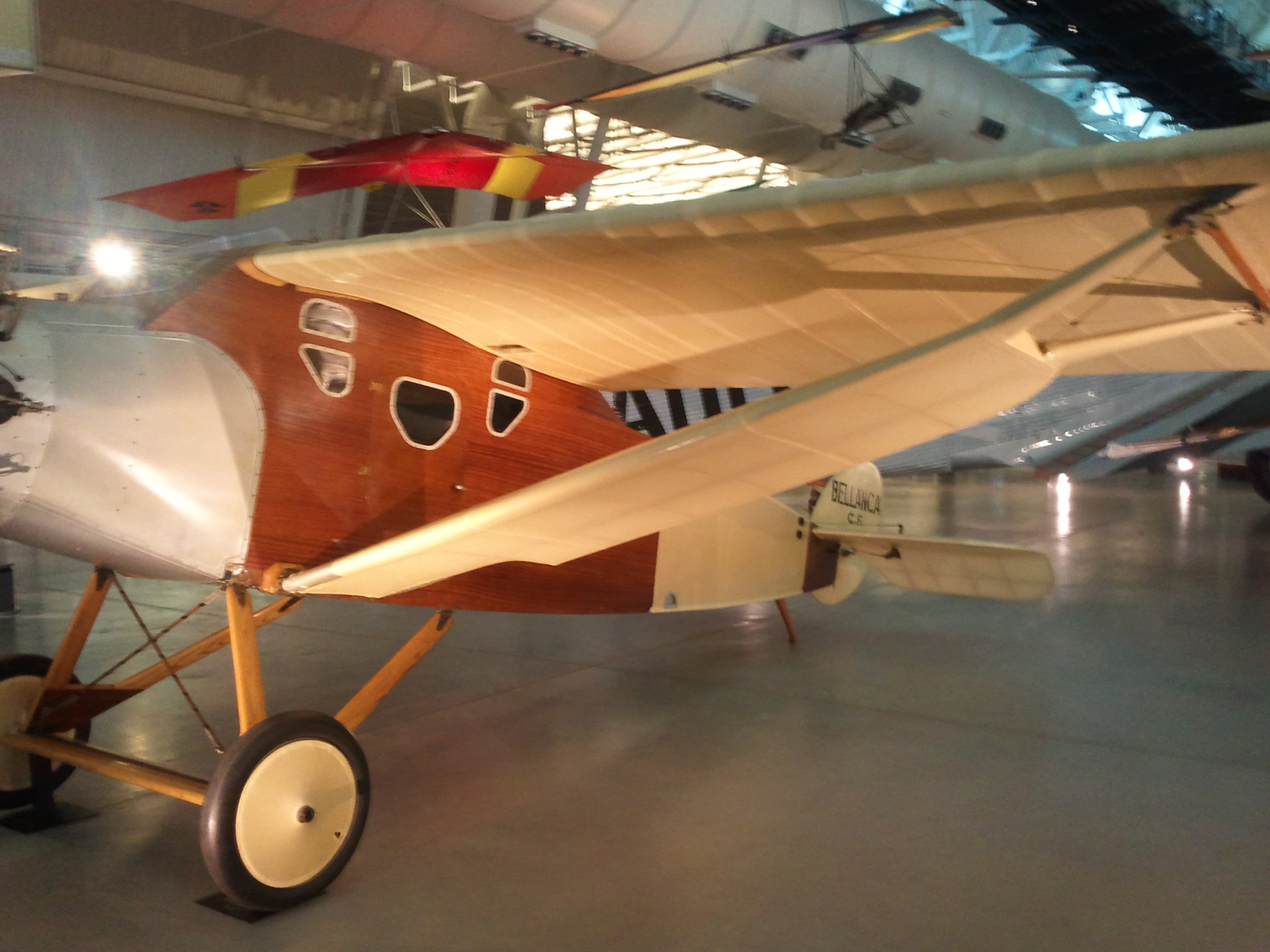

      Saw it at the National Aerospace Museum
      http://forums.matronics.com/viewtopic.php?p=336996#336996

      Thanks Ken,  I'm thinking the same way you are.  My spars are 3/4".  I will get
      some more strips sheared this morning as I have the grain running the wrong way
      on the top pieces....dang!
      John
      John,
      I just looked back through the thread, and the only question you asked was whether
      most builders sand the spar to suit the radius of the metal. I don't think
      you ever asked the question you are now asking, and THAT'S probably why nobody
      answered it.  :)
      Anyway, to answer your question; yes, the method you have shown will work just
      fine. Remember to allow for the extra metal thickness added by overlapping the
      two pieces.
      Ken,
      I don't follow your comments about the U fitting that attaches to the spar being
      "crimped in". The photo looks like a simple 90 degree bend. I don't see any
      crimping.
      Bill C.
      http://forums.matronics.com/viewtopic.php?p=337001#337001
      Bill, it may be the way the picture looks on my monitor.  But to me it
      looks like the top, upward pointing U that attaches to the spar is
      closed back in a little before the vertical pieces start their
      verticality.  I wasn't intending any editorial comment, other than
      that would require abit more work.  Assuming what I think I'm seeing
      is what I'm seeing (try to say that three times), it might be easier,
      if starting from scratch, to use plywood shims on the spar, so that
      the U that attaches to the spars are essentially three straight
      pieces: the two sides and the bottom. Ken

      All are simple 90 degree bends.  Thanks guys, i just got back from the weld shop
      with my new strips sheared to size.  That should give me enough work to do this
      weekend.
      John
      http://forums.matronics.com/viewtopic.php?p=337009#337009

      Hi John,
      I did my cabane strut fittings just as you show; two interlocking "U's". I think
      they are stronger and you are not putting the weld in tension.
      John
      Using two U-shaped pieces was specifically mentioned by Mr. Pietenpol in the original
      Air Camper article in the Flying and Glider magazine. I have always wondered
      why it changes to a three piece design on the Improved Air Camper plans.
       My fittings are the same as your proposing.
      Chris
      Chris
      Sacramento, CA
      WestCoastPiet.com
      http://forums.matronics.com/viewtopic.php?p=337025#337025
Message 14
      John, the guy who did my fittings did them according to the plans, but he
      said that if he had it to do again he would make the fitting out of one
      piece of metal and make 4 bends in it.  Seems that that would be wasteful,
      but it's an idea if you want it.  Chuck
      ----- Original Message -----
      From: "Kringle" <Mrkringles@msn.com>
      Sent: Friday, April 15, 2011 8:44 AM
      Subject: Pietenpol-List: Re: Cabane Fittings
      > and I probably would not be building this aircraft if I did not have the
      > expertise and support of this group.  I blame myself for not being clear
      > on the original question and will ask it again as the conversation has
      > drifted to wood grain, motor mounts and wallpaper.  Please review the
      > attached pic and tell me if is okay to modify the cabane fittings as I
      > have seen others do.  The left drawing is the way called for in the plans
      > and the right fitting is how I have seen others do it.
      > Thanks so much
      > John
      > http://forums.matronics.com//files/rear_cabane_fitting_885.jpg
Message 15
      Chuck,
      I'm no engineer but I think that would work and be just as strong as the plan fittings.
      Now I have to quit talking about it and get to work.
      John
      John
      http://forums.matronics.com/viewtopic.php?p=337051#337051
Message 16
| Subject:  | Re: Has this been tried on a Piet? |
      Looks like it might work, but I don't like the looks of it.  C  Do not
      archive
      From: "Tom Bernie" <tsbernie@earthlink.net>
      Sent: Friday, April 15, 2011 9:19 AM
      Subject: Pietenpol-List: Has this been tried on a Piet?
      > http://forums.matronics.com//files/2011_03_15_123016_141.jpg
Message 17
      Chris,
      You are right about the FGM. The article mentions these brackets, and the plans
      from the FGM also show it that way.
      Another thing that makes me scratch my head is the fact that these brackets are
      drawn and detailed twice in the plans (on drawing #4 and again on drawing #5).
      My guess is that when the tab was added to tie in the diagonal cable bracing, the
      "blank" that would need to be cut out for the lower U channel would become
      a lot more difficult to fabricate. By making the lower ears as separate pieces,
      and welding them to the upper U channel, the parts are a lot simpler to cut
      out.
      However, when the diagonal cable bracing is replaced by the diagonal tube bracing,
      the need for the tab is eliminated, making the bottom U channel easy to cut
      once again.
      >From a strength and safety point of view, the two U channels is superior to the
      welded tabs.
      I'll be making mine from two U channels.
      Bill C.
      http://forums.matronics.com/viewtopic.php?p=337054#337054
      http://forums.matronics.com//files/fgm_fitting_200.jpg
      Has WHAT been tried on a Piet?
      enclosed passenger cabin?
      crazy wooden tailskid?
      flying a hang glider overhead?
      or is it the airfoil shaped struts?
      I believe this model (CF) was Bellanca's first of his many designs to use the "flying
      struts".
      Look at the undercamber on that wing!
      Bill C.
      http://forums.matronics.com/viewtopic.php?p=337058#337058
Message 19
      John
      Build mine as shown on the right, two "U" shaped pieces hooked together and
      welded. Several others with flying Piets have done the same. Seems a lot
      stronger and not much harder to make.
      rick
      > expertise and support of this group.  I blame myself for not being clear on
      > the original question and will ask it again as the conversation has drifted
      > to wood grain, motor mounts and wallpaper.  Please review the attached pic
      > and tell me if is okay to modify the cabane fittings as I have seen others
      > do.  The left drawing is the way called for in the plans and the right
      > Thanks so much
      > John
      Rick Holland
      Castle Rock, Colorado
      NX6819Z
      "Logic is a wreath of pretty flowers, that smell bad"
Message 20
      Nice to see all this good ifitting inormation....
      Sorry John to divert down a bunny trail there in the middle of the thread - I could
      not figure how to re-post the photo to a new thread from my Droid.

Message 21
      I wondered that too but kinda figured you were taking about the struts.- makes
      me wonder how strong they are to resist bending if they actually contribute much
      lift without any jury struts. do not archive
      http://forums.matronics.com/viewtopic.php?p=337067#337067

Message 27
      The interlocking U-shape is how it was done on NX18235 and is good for peace
      of mind if you are an inexperienced welder.
      I would suggest using a Scotchbrite deburring wheel to soften the sharp
      edges of the fittings where they come in contact.
      It is also good practice to polish the edges of the steel prior to bending.
      This will make the fittings less prone to cracking.
      Greg Cardinal
      Sent: Friday, April 15, 2011 7:44 AM
      > Thanks so much
      > John

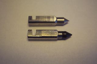

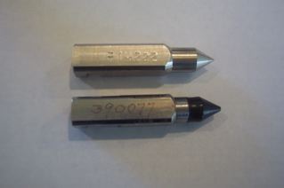

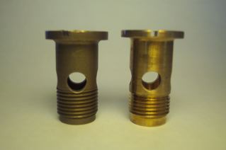

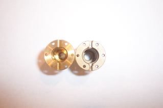

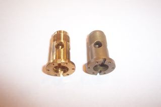

| Subject:  | stromberg Carb - Seat and Needle |
      During my rebuild of my Stromberg carb, I learned a lot about them from
      this forum and elsewhere on the Internet. I wanted to share a few things I
      learned about mine in particular.
      It appears to have originally been a NA-S3A1 that was modified to a NA-
      S3B by using a file and a stamp on the housing. It has the correct
      venturi size for my C85, and the jet was drilled out to the correct size.
      and noted on the jet. The B is not supposed to have a mixture control,
      mine does.
      It also had a neoprene needle but the seat doesn't have a part number so
      I wasn't 100% it was the rounded seat. I went ahead and ordered a
      stainless steel seat to compare.  The seats are very similar and with the
      naked eye is difficult to tell the difference.  Externally, the length of
      threaded area  is longer on the rounded seat and internally, it doesn't
      appear to be rounded, but an extra chamfered area for the needle to
      rest on.
      I attached a bunch of photos and I hope they will help anyone who may
      be working on one.
