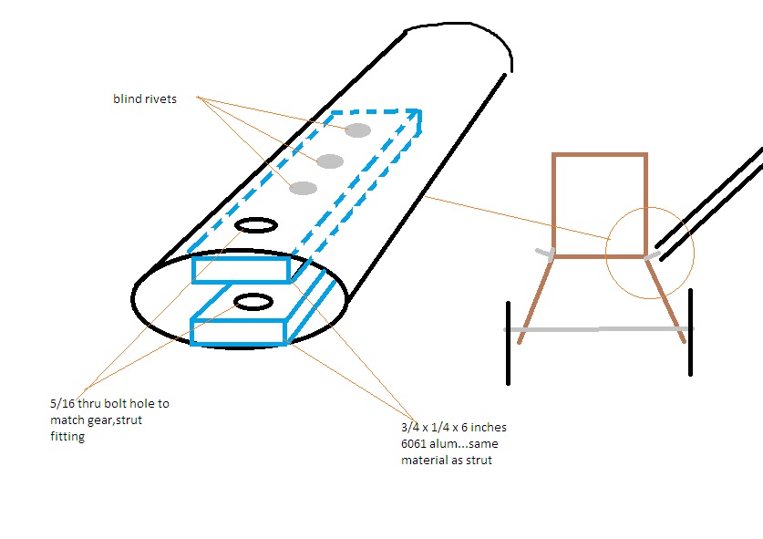

| Subject:  | aluminum lower strut fitting |
      Hey guys....
      I made my struts yesterday using the same aluminum as a few others here.. i used
      the 7075 bar in the upper end like Dan did.. looks great to me.. the lower end
      i was trying to keep simple.  no adjustable forks.. just a bolt thru install..
      my thoughts to spread the load were as such..
      aluminum bar 6 inches long with structural rivets to attach the bar to the inside
      flats on the struts... that leave just enough room to slide this over the tabs
      on the gear/strut attach point..
      any thoughts ?
      jeff
      I would be afraid of rivets.  Why not bolt through.  This is the way its do
      ne on seaplane struts.  However=2C I am not an engineer=2C so you milage ma
      y vary.
      Doug Dever
      In beautiful Stow Ohio
      > Subject: Pietenpol-List: aluminum lower strut fitting
      > From: jfaith@solairusaviation.com
      > Date: Tue=2C 3 May 2011 07:06:47 -0700
      om>
      > Hey guys....
       i used the 7075 bar in the upper end like Dan did.. looks great to me.. th
      e lower end i was trying to keep simple. no adjustable forks.. just a bolt
      thru install..
      e inside flats on the struts... that leave just enough room to slide this o
      ver the tabs on the gear/strut attach point..
      > any thoughts ?
      > jeff
      > http://forums.matronics.com/viewtopic.php?p=338748#338748

Message 34
| Subject:  | Re: aluminum lower strut fitting |
      Hey Jeff,
      I am sure this will work. Those structural rivets will be just fine. With f
      our struts the load is spread out. I would maybe tighten-down on the lower
      strut attach bolts so there is no movement; no chance of elongation of alum
      inum holes.
      Dan Helsper
      Puryear, TN
      -----Original Message-----
      From: bender <jfaith@solairusaviation.com>
      Sent: Tue, May 3, 2011 9:10 am
      Hey guys....
      used
      nd i
      nside flats on the struts... that leave just enough room to slide this over
       the
      any thoughts ?
      jeff
      ead this topic online here:
      ttachments:
      http://forums.matronics.com//files/alum_strut_attach_171.jpg
