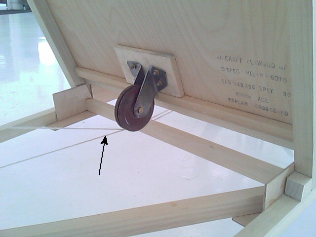

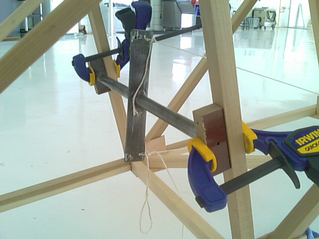

Looks good Jeff, I think I see two pulleys and I assume you will fit with a
cable guard. I'm doing the rudder cable routing now which can go many
different ways.
Jack

hey guys... i feel like i've seen a few pictures of plane with pulleys just
behind the drivers seat... is this pretty normal ??
i was playing with my controls today and came up with this...
jeff

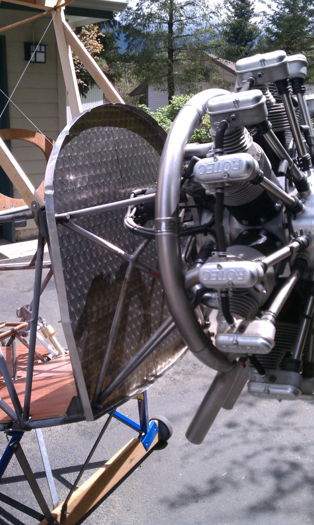

Over the past several weeks, it felt like I was not making much direct
progress on my Pietenpol - direct progress that is because for the past
three Saturdays I was in a class on "vintage radial aircraft engines." It
was taught through a local community college and the Historic Flight
Foundation (That's a museum North of Seattle where they fly all their
vintage planes - amazing place.) Because I had not been as familiar with the
differences between the radial and other aircraft engines as I would have
liked - and because I am mounting a Rotec radial on my Piet - this class
came along at just the right time. It felt, however, like I was not working
on the plane for weeks at a time. But I really WAS working on the plane - by
working on my knowledge of my powerplant...!
Anyway, back to the forum topic.... A couple days ago I got the firewall
back from a metal-forming specialist who formed the flanges on my
stainless-steel firewall (thanks Danny - Creative Billet.) I burnished the
panel myself prior to him forming it but I didn't have a heavy-duty
shrinker/stretcher (or the experience) to form the flanges - so I hired out
that operation.
Now I can keep movin' on - funnn stufff..............

Rick- same on mine. Lower pulley barely moves.
Dan Helsper

Looks good, one pulley is enough, I did 2 and the lower cable pulley barely
gets enough friction to move.
On Mon, May 9, 2011 at 2:46 PM, bender <jfaith@solairusaviation.com> wrote:

Can I ask what size of pully you are using?
KMHeide

all but the two behind the seat are 2 inch... the ones behind the seat are 3 inches...
just because had them around
workin on the rudder bar today.. tryin not to bleed on stuff too much. i hate when
the drill press grabs
jeff

I'm trying to understand what is going on here (see photo)... I can see that there
is a deflection because the line doesn't remain straight, and I understand
that you are pointing out that there is limited friction involved with the bottom
cable, but is this cable routed below the fuse cross member or is there some
kind of rub block mounted to the other side of the pulley? I know that it
must be contacting something, just not sure how you are doing this.
Mark Chouinard
Wings, Center Section and Empannage framed up - Working on Fuselage
http://forums.matronics.com/viewtopic.php?p=339450#339450
http://forums.matronics.com//files/cables_150.jpg
Message 14
the elevator cables from the rear control stick torque to the bellcrank won't clear
the bottom seat crossmember so i added those two pulley to keep the cables
off of that crossmember..quite a deflection from the upper cable.... not so
much from the lower
jeff
http://forums.matronics.com/viewtopic.php?p=339458#339458
Message 15
Mark,
If you look closely, you'll see that there are two pulleys there, side by side.
Bill C.
http://forums.matronics.com/viewtopic.php?p=339459#339459

Message 18
Wow Dave,
She's beautiful and what a work of art, if she fly's half as good as she
looks you be stuck suffering from that menacing problem the that afflicts
only a select few of the airplane builders in the county, "perpetual smile
disorder".
Best of luck and enjoy!
John
In a message dated 5/9/2011 8:28:44 P.M. Eastern Daylight Time,
dsornbor@aol.com writes:
--> Pietenpol-List message posted by: "Dangerous Dave" <dsornbor@aol.com>
Howdy,she's done.Will be inspected on the 17th and in the air shortly
therafter.Highspeed taxi tests have been great,runs like a top.Can't wait!dave
taking to hangar
http://forums.matronics.com/viewtopic.php?p=339371#339371
http://forums.matronics.com//files/2011_05_08_12_26_43_427__copy_230.jpg
http://forums.matronics.com//files/2011_05_08_12_26_23_262__copy_645.jpg
http://forums.matronics.com//files/2011_05_08_12_25_50_425__copy_151.jpg

Alright, that makes more sense. Where is the "like" button?
Bill Church wrote:
> Mark,
> Bill C.
Mark Chouinard
http://forums.matronics.com/viewtopic.php?p=339464#339464
