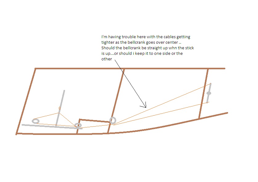

      Jeff,
      It's my understanding that some slack is good.  There is an alternative
      bellcrank design by Ken Perkins, you can see a picture here
      http://textors.com/DSCN4226_640x480.jpg not far enough along to say it works
      but Ken is a fantastic builder.  His contact info,
      Kenandvernaperkins@sbcglobal.net
      913-764-6949
      -----Original Message-----
      [mailto:owner-pietenpol-list-server@matronics.com] On Behalf Of bender
      Sent: Wednesday, May 11, 2011 3:08 PM
      Subject:  Pietenpol-List: bellcrank geometry
      Ok .... i'm dying here
      i've read the post about the slack in the elevator cables...
      i'm confused
      the cables from the control stick to the bellcrank loose tension as i move
      the stick fore and aft.... pressure in the middle and way slack at the up
      and down positions...i don't get it...
      this can't be right
      i can see where a tube with a rod end is nice
      i thought this was going to be the easy part
      jeff

      i understand the aft cable issue...
      as i move the stick...no cables aft of the bellcrank the cables go from loose to
      tight to loose again
      my problem is up front... i see from mr Cuys photos that 2 inches of travel at
      the location of his stop is all thats required and that would help but i'm wondering
      if the bellcrank going overcenter is the problem
      i really thought this closed loop in the front was a no brainer
      now i feel like i'm missing a brain myself
      jeff

      I use the push/pull tube setup on my plane so I can't help you with the cab
      le slack/tight problem. However, it would be wise to position the bellcrank
       to be vertical when the control stick is neutral. This will give you the s
      ame stick "feel" when you move the stick from neutral forward and neutral a
      ft. Also, it will give the controls the same amount a travel in both direct
      ions. (which if needed can be limited by stops.)
      You will find the same cable issues with the rudder.

      thanks...
      i was just out in the hangar messing with it.... if i leave the cables just tight
      enough not to sag then it actually feels ok.. it just seems weird to be that
      loose..
      the wooden block under the seat instead of the pulley would work great too , no
      real friction with loose cables
      in unison now... " stick to the plans "
      jeff

      Jeff, again, I'm not past this point but my understanding is it helps
      forward of the bellcrank also.
      Jack
      DSM
      Sent: Thursday, May 12, 2011 9:32 AM
      Subject:  Pietenpol-List: Re: bellcrank geometry
      loose to tight to loose again
      at the location of his stop is all thats required and that would help but
      i'm wondering if the bellcrank going overcenter is the problem
      jeff
      http://forums.matronics.com/viewtopic.php?p=339676#339676
