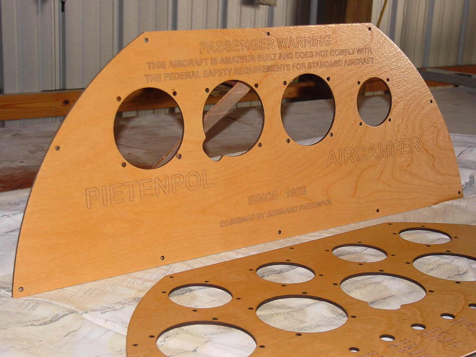

Message 4
| Subject: | Laser cut my instrument panels today |
I got a friend to cut and engrave my front and rear panels this morning with his
CNC laser. I can't get a picture to really show it off right but couldn't resist
posting.
Jerry Dotson
59 Daniel Johnson Rd
Baker, FL 32531
Started building NX510JD July, 2009
wing, tailfeathers done, fuselage rolling
using Lycoming O-235
http://forums.matronics.com/viewtopic.php?p=339864#339864

Message 6
| Subject: | Re: Laser cut my instrument panels today |
That's fantastic, Jerry. I sure hope you can fly your Piet to Brodhead, next year.
Dan
