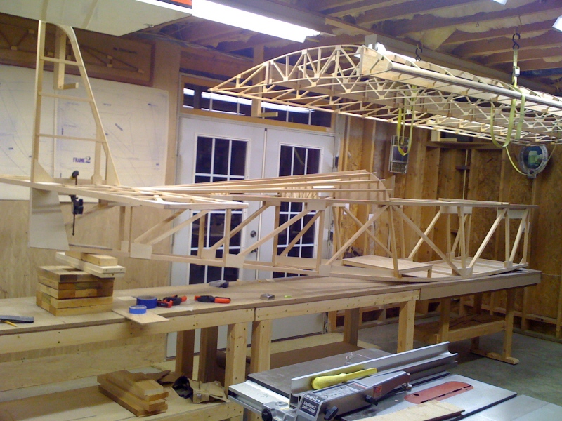

       Chuck,

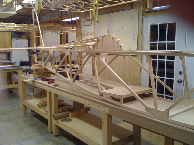

       Did you drop the seat or raise the fuselage sides or is it just a trick
       of the camera?  Your shoulders are below the top of the turtledeck...

      >  Sat in my AirCamper yesterday for the first time! All big thank you for
      all
       the great advice on the turtle deck. I used a combination of the methods
       received. I am pleased with the results. This is a great list with a bunch
       of
       great people. I could not do this without this resource and of course
       WestCoastPiet.com.
      >  Chuck (in Raleigh)
      >  989CB

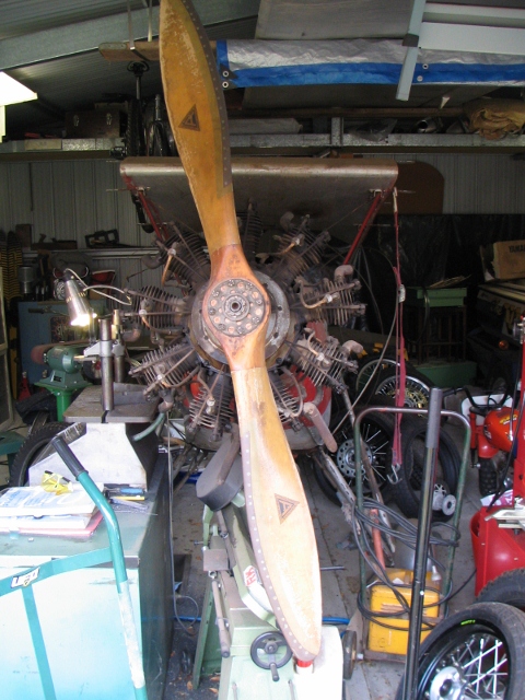

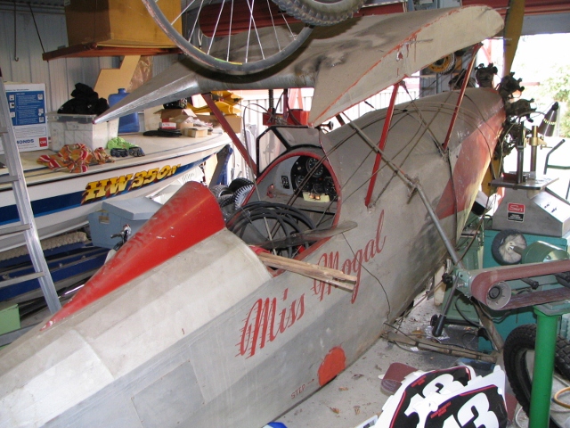

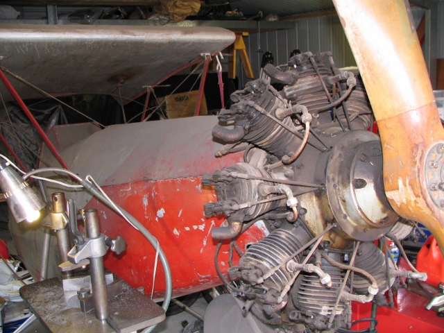

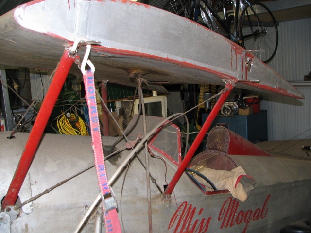

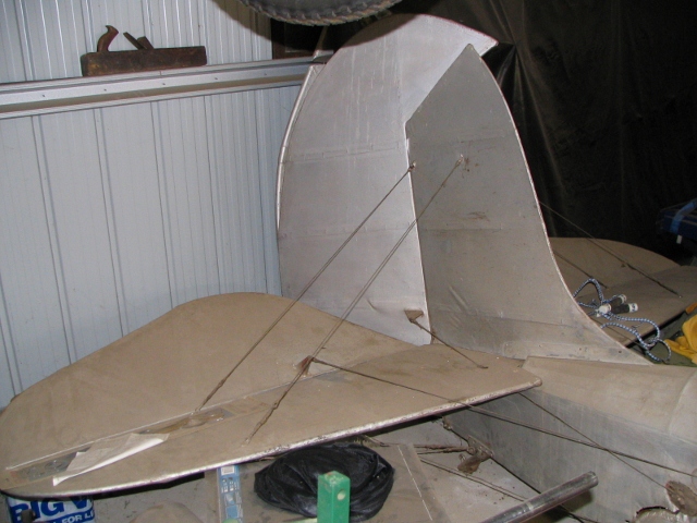

      Here are more of the pics I took.
      Scotty
      Tamworth, Australia
      Building a Corvair Powered Pietenpol Air Camper
      www.scottyspietenpol.com
      Rudder, Vert stab, Elevators and 28 Ribs built...

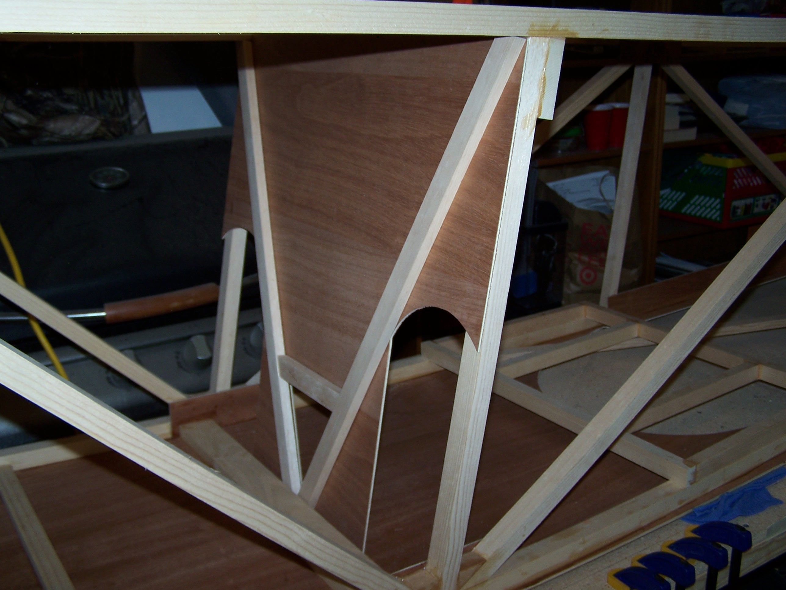

      Hey all, just a question about construction of the plywood seat backs.  Last night
      (way too late) I measured and cut the front seat back and outlined the position
      of the 1" X 1/2" spruce spacers.  The plywood back fits nicely in the fuse,
      and I planned to cut the spacers out today and get things epoxied.
      My plan (and according to the plans as I interpret them) show the braces epoxied/nailed
      to the front of the seat back and therefore are in the passenger cockpit.
      Of course, the first picture I looked at on-line (and from my Oshkosh pics
      last year) show the braces on the back-side of the plywood and inside the pilot's
      cockpit.  More pictures from various sources show it both ways.  This leads
      me to believe it probably doesn't matter, but. . . to plans, the braces go
      in front (in the passenger cockpit), right?  Is there an advantage or disadvantage
      to either or does it just mean there are as many nuances to each Piet as
      there are builders?
      Thanks.
      Tom

      Tom,
      The short answer is :  it just doesn't matter.  I put mine on the back,
      thinking that those braces would be uncomfortable for the front cockpit
      passenger.  But unless that person is VERY strangely built, they would never
      touch the braces.  Do as you wish.  If you are a purist, put them where the
      plans show them.

      Thanks for the input.  I don't know that I consider myself a "purist", exactly;
      truth is, I've never done anything like this and I'm more concerned about doing
      something incorrectly and not being able to easily fix it.  I'd hate to glue
      the spacers in and find out a few weeks from now that they might interfere with
      a cable or metal fitting or something else.
      As a newbie to the list I try more to read and learn from all the "old hands" and
      I appreciate the help.  (I've groaned at more than one of the questions I've
      asked, myself.)
      Anyway, thanks again.  I've included a few pics of the roughed-in seat back and
      spacers.  (Now maybe someone can tell me how to make the pictures smaller so
      they are easier to see!)
      Tom
      http://forums.matronics.com/viewtopic.php?p=342793#342793
      http://forums.matronics.com//files/piet_pics_june_040_818.jpg
      http://forums.matronics.com//files/piet_pics_june_043_166.jpg
      http://forums.matronics.com//files/piet_pics_june_042_125.jpg
Message 9
| Subject:  | Re: Seat back question |
      Tom,
      Your woodwork looks nice and clean...and you have the rear ash x-member
      correctly positioned!! Carry on....
      Gary

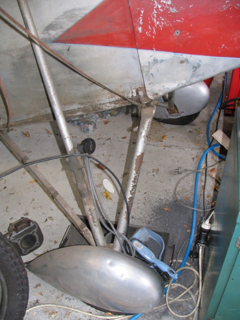

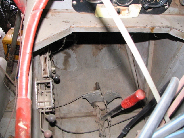

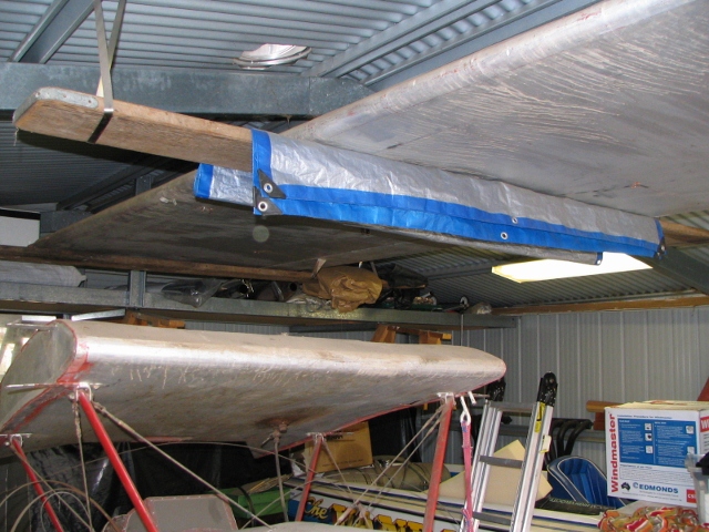

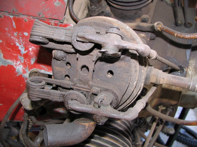

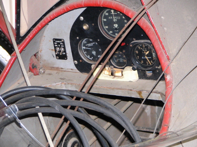

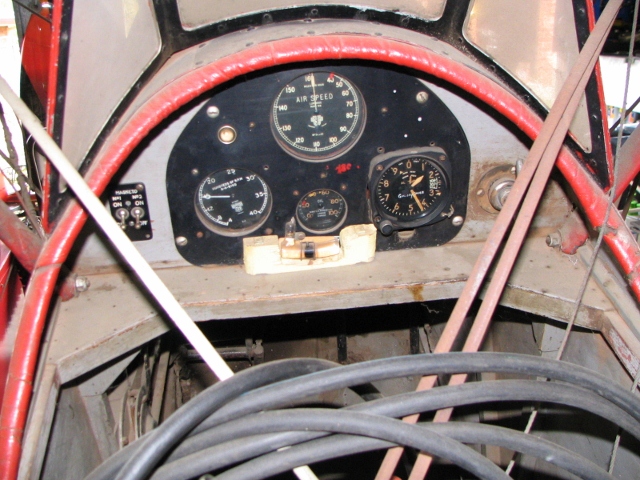

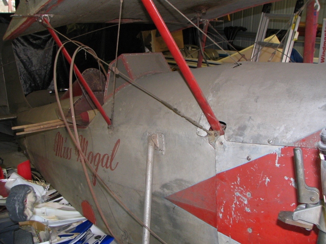

      Scotty,
      I would certainly appreciate more photos, since I am slowly building a Sky
      Scout.  You can send them to me directly at: Raykrause@frontiernet.net.
      Thanks for the effort, sure do appreciate it.
      Thanks and fly SAFELY,
      Ray Krause
      Waiex 51YX, Jabiru 3300 (1197), Sensenich wood prop, AeroCarb (#2 needle
      modified), Dynon D-180, Garmin SL 30 NavCom,  Garmin 327 transponder, Garmin
      Aera 560,  nav and strobe lights: 246 hrs.
      ----- Original Message -----
      From: "bubbleboy" <scott.dawson3@bigpond.com>
      Sent: Saturday, June 11, 2011 4:16 AM
      Subject: Pietenpol-List: Re: Pietenpol Scout discovery in Australia!
      > With camera in hand I went and had a look at the Pietenpol Scout living in
      > the next suburb from me! It has a Salmson AD9 9 cylinder radial engine. If
      > its of any interest I have some more pics but wont load them up if no one
      > wants.
      > Scotty
      > Tamworth, Australia
      > Rudder, Vert stab, Elevators and 26 Ribs built...
      > http://forums.matronics.com/viewtopic.php?p=342710#342710
      > http://forums.matronics.com//files/img_1328_640x480_206.jpg
      > http://forums.matronics.com//files/img_1304_640x480_111.jpg
      > http://forums.matronics.com//files/img_1298_640x480_550.jpg

      ight (way too late) I measured and cut the front seat back and outlined the
      osition of the 1" X 1/2" spruce spacers.  The plywood back fits nicely in
      he fuse, and I planned to cut the spacers out today and get things epoxied.
      poxied/nailed to the front of the seat back and therefore are in the
      assenger cockpit.  Of course, the first picture I looked at on-line (and
      rom my Oshkosh pics last year) show the braces on the back-side of the
      lywood and inside the pilot's cockpit.  More pictures from various sources
      how it both ways.  This leads me to believe it probably doesn't matter,
      ut. . . to plans, the braces go in front (in the passenger cockpit), right?
      s there an advantage or disadvantage to either or does it just mean there
      re as many nuances to each Piet as there are builders?
      Thanks.
      Tom

      Would the placement of the braces as plan spec,allowed for some seat back
      padding.

      Let me put it another way.If the braces were to form a shallow pan to hold a
      thin pad in place it would make a lot of sense to me.

      Tom, Your work looks great. You may want to consider cutting the top of the
      pilot leg holes higher. Almost for sure you will want them higher the first
      time you sit in the pilot seat and they will be easier to cut now, I
      learned that the hard way.
      Skip
      exactly; truth is, I've never done anything like this and I'm more
      concerned about doing something incorrectly and not being able to easily
      fix it.  I'd hate to glue the spacers in and find out a few weeks from now
      that they might interfere with a cable or metal fitting or something else.
      hands" and I appreciate the help.  (I've groaned at more than one of the
      questions I've asked, myself.)
      back and spacers.  (Now maybe someone can tell me how to make the pictures
      smaller so they are easier to see!)
      > Tom

      Skip (and Gary),
      Thanks for the compliment and advice.  I cut the rudder pedal openings to plans
      but have read enough on this forum to wonder if I should lengthen them.  I used
      my wife's collander to mark the upper curve (she was asleep); maybe she has
      a pie-tin I can use to lengthen them (which I am thinking of doing on your advice).
      Tom
