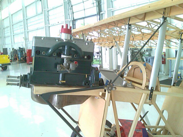

      Jeff,
      Very nice, and I see no reason why that wedge won't work. I bought my whole
       induction system finished from Ken Perkins, so mine was done for me. That
      looks like a model B carb?
      Dan Helsper
      Puryear, TN

| Subject:  | Re: engine mounted |
      Its a Tillotson model X carb... an aftermarket A carb..
      i have a Marvel atermarket carb too... they are both aluminum..or pot metal, a
      lot lighter than the Zenith A or B
      i figured i'd try all the carbs i had.. i have a Zenith on the AA truck that would
      fly just fine too
      Walt Bowe has a wedge in his too... i was looking at photos of his plane and picked
      it out.. looks like he has a tillotson carb..or a marvel.. not sure
      i know they are both popular for "drivers" not show cars
      i set the engine up there thinking about weather or not to cut the crank and water
      pump down.. it looks good so i'm leaving them stock..
      i have a water pump housing painted ready for new parts... i have a local place
      called the Old Car Parts House... the guy just deals in A and T parts.. its a
      great resource... and the guy knows a lot
      its easy to run to his place and pick up parts
      jeff
