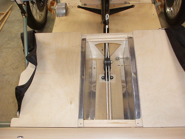

The aft seat bottom in my Piet is divided into three sections also. The center
is screwed down with aluminum dividers so things stored on either side can not
travel inboard and conflict with the cables.

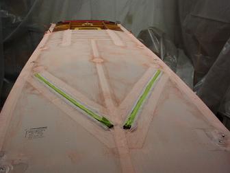

For aft inspections, I plan on using a technique I utilized on construction of
a Boredom Fighter where two zippers are sewn onto the bottom fabric and finishing
tapes are applied during covering. Masking tape is applied over the teeth
during covering and painting then when finished, the masking tape is removed,
the zippers opened and the fabric cut with a razor blade. The end result is
a triangular flap that can be zipped up during use and unzipped when wanting access.
Worked very well with the Stitts process well see how the latex handles

Bill,
I decided to stay a little closer to the plans. The holes are made of 2
layers of 1/8 ply the bottom layer hole being 1/2" smaller than the top
layer. Plan to use the middle hole for maintance access and the outer holes
will have canvas cargo bags, still have to figure a way to keep the canvas
from fouling the rudder cables. Plan to use leather hindges and hope to be
able to slide my butt to access cargo in flight. The hole in the pac seat
is just for inspection/maintance.
Skip
