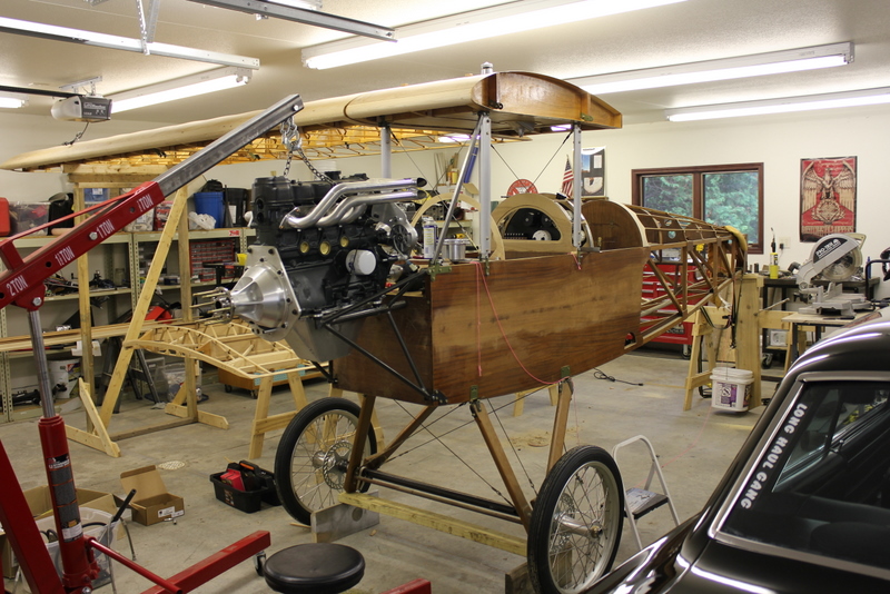

      Set the Mits engine in place for the first time.......i think it looks pretty cool!

      Chris,
      Is there a thrust bearing in your Al shaft adapter housing ? A great installation.
      Looks like it will do the job. Is it direct connected.
      Do I see a blunter leading edge on the wing profile ?, Or is it all Pietenpol ?

      I think it looks WAY cool!  That's pretty neat....it's gonna be fun seeing/hearing
      a prop spin in front of that engine!

      Yes there are two timken bearings and a isolator ring seperating the crank from
      the prop spindle.
      The wing is riblet 612...

      Chris.
      Look me up at Brodhead, I will give you a Riblett ride. I also use a thrust bearing
      between the front main and the prop. With a prop extension a quick prop change
      is valuable to find the proper pitch and diameter.
      Pieti Lowell
