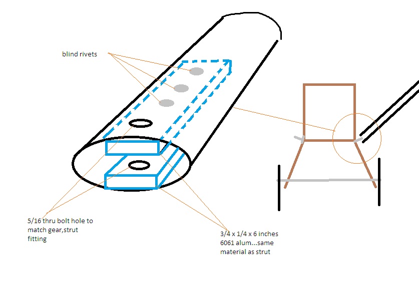

Message 26
| Subject:  | Re: skytek struts |
      i did something similar but put the straps on the inside..7 inches long i believe...and
      3/4" wide and 1/4" thick 6060 t6.. 4, 3/16 stainless structural rivets
      on each side...leaves just enough room for the as drawn fittings to slide inside..
      not flying but my math says it will hold and an engineer buddy liked it
      too
      btw ..small struts from carlson
      jeff
      http://forums.matronics.com/viewtopic.php?p=348314#348314
      http://forums.matronics.com//files/alum_strut_attach_163.jpg
      http://forums.matronics.com//files/strut_111.jpg
