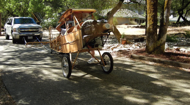

Yesterday was the First Annual Nor-Cal Truck Pull. With a record crowd,
from as far as Texas and cheers from the horse stables, first time entrant,
Gary Boothe's mighty Corvair powered AirCamper ran flawlessly. With
260 lbs of thrust, it strained against the ropes trying to tame it. Without
actually moving the truck, He was easily the winner!
Upon post-run inspection, it was discovered, that Gary's pilot, Curt put his
weight into the pull. While holding the brakes to prevent the clip-winged
Piet from getting airborne, he pushed his dairy-air too hard into the back
of the seat. Gary now has a Broke Back Piet. With some reinforcement,
posting of pictures, detailed description and sketch-up drawings, he'll be
ready for another run in less time that it takes Kevin to change a broken
spoke.
