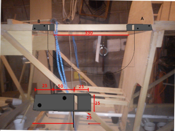

Message 2
| Subject: | Re: Idea about front cockpit side door |
Could Keri Ann's design be incorporated in a fuselage that is basically
complete except for the side plywood and turtle deck? How can I get a
set of her plans? C

Message 3
| Subject: | Re: Different thot about door |

Message 4
Charles,
I once asked her if it was possible to incorporate it into a fuse with
the sides already on & she said yes, but with some difficulty and the
finished product might not be as good as if starting from scratch.
I'd think it would be a lot easier if you don't have the plywood on
yet. Hopefully, you haven't varnished anything yet either.
She posts to the list on a regular basis, so her contact info is in
the archive.
Kip Gardner

Message 5
womenfly2 wrote:
> giacummo ... what you are doing here is a very unsafe and uncalculated engineered
design.
> ... but what do I know.
Keri-ann, I am not doing anything wrong, I am just puting an idea on the table
to discuss it, analyze it, and may be make functional and safe design; I think
there are lot of members with head enough to resolv this problem.
Regards.
[/i][/u]
Mario Giacummo
http://vgmk1.blogspot.com
http://forums.matronics.com/viewtopic.php?p=349949#349949
Message 6
I do not want to discuss about benefits or not of the door, just the idea and if
it could be possible to do it or not; if no, why, and if yes.. I am intersted
in this because is a fact that it is not easy to go into the front for a lot
of people for many reasons, so, lets think in something for them... an "open
design" of the door, this one or an other one...
So, continuing with this exercise I try to figure how it look in place.
the measures are what they are, measures, without any engineering on it, may be
they could be larger or shorter, thiker or thiner walls, or a bad solution at
all; lets search for a proof of concept.
Regards.
Mario Giacummo
http://forums.matronics.com/viewtopic.php?p=349955#349955

Message 12
Mario,
At one point I was all set to install the front pit door, had it roughed in
and supported with a design that made sense and transferred the loads both
down and around the proposed opening, not doing the math or analysis
planned as a next step. Before fully committing to the door I stopped and I
decided against it, for the following reasons:
There are 4 longerons that pretty much support the length of the airframe,
cutting one and reducing that strength by 25% made no sense, and to tell
you the truth frightened me to a point that I would have no piece of mind
wondering if the other longerons were able to support the load and flexing
moments placed on them. Just too scary for me to want to fly with
Making that major structural change for an occasional passenger that may
be too large to fit or may weigh too much to fit didn't make sense either.
plenty of smaller people that want to ride and require no doors or reasonable
accommodations, ADA compliant
The occasional large passenger vs a permanent structural change that may
weaken the airframe, I plan to fly it all the time and take passengers on
occasion, why make that sacrifice of strong airframe integrity for the
occasional passenger. Makes no sense here either
There are plenty small, light weight and flexible folks that can and do fit
easily into the front pit, why change the airframe to accommodate the
unfitting few? repeat of the point
I just can seem to justify cutting a major structural component,
compromising the integrity of the airframe to accommodate the once or twice rider.
makes no sense
here either
I am a full size person, a builder and a damn good pilot, I don't ask for
nor do I expect to be offered a ride, my size and weight preclude that. I
understand it, I accept it and I make no excuses for it. That's the way it
is and I make no bones about it. Weight and balance, flying over gross are
just two of the important aspects of consideration in aviation. Why mess
with something that needs not be compromised ?
I am certain any rider you plan to take in your Piet will greatly
appreciate the ride over the fence on take off rather that going through it on
an
attempted takeoff.
Compromises in safety are not compromises at all but the commitment of
poor judgments and dumb acts made by foolish people. And the opinion of the
writer bearing no value to anyone determined to kill themselves or others
though poor decision making.
John
Safe in the morning
In a message dated 8/19/2011 10:40:53 A.M. Eastern Daylight Time,
mario.giacummo@gmail.com writes:
--> Pietenpol-List message posted by: "giacummo"
<mario.giacummo@gmail.com>
and if it could be possible to do it or not; if no, why, and if yes.. I am
intersted in this because is a fact that it is not easy to go into the
front for a lot of people for many reasons, so, lets think in something for
them... an "open design" of the door, this one or an other one...
may be they could be larger or shorter, thiker or thiner walls, or a bad
solution at all; lets search for a proof of concept.
Regards.
Mario Giacummo
http://forums.matronics.com//files/puerta2_192.jpg
Message 13
If you're bound and determined to put a door in a wood fuselage Piet, then
why not just use the design that has already been done....and flown? There's
your proof of concept:
https://sites.google.com/site/pietenpolplanpackages/pietenpol-plan-packages/suppemental-plan-packages
Ryan

Message 16
With all this talk of doors, I wanted to mention how my Piet was built
by Ed Sampson. He welded a small,simple piece of tube onto the left rear
gear leg facing to the front. It makes getting into the front a complete
non issue. I've taken a 70 year old that weighed 210lbs for a ride, and
he had no trouble getting in the front. I've gotten in the front myself,
very easily and I'm a 6'2" blob at 235lbs.
If you have split, Cub like gear legs, there's an easier way than doors.
Perry Rhoads
N12939

one...
place.
it, may be they could be larger or shorter, thiker or thiner walls, or a
bad solution at all; lets search for a proof of concept.
Regards.
Mario Giacummo

On Fri, Aug 19, 2011 at 11:28 AM, Perry Rhoads <prhoads61@frontiernet.net>wrote:
> With all this talk of doors, I wanted to mention how my Piet was built by
> Ed Sampson. He welded a small,simple piece of tube onto the left rear gear
> leg facing to the front. It makes getting into the front a complete non
> issue. I've taken a 70 year old that weighed 210lbs for a ride, and he had
> no trouble getting in the front. I've gotten in the front myself, very
> Perry Rhoads
> N12939
> do not archive
> ----- Original Message -----
> *From:* AMsafetyC@aol.com
> *To:* pietenpol-list@matronics.com
> *Sent:* Friday, August 19, 2011 10:24 AM
> *Subject:* Re: Pietenpol-List: Re: Idea about front cockpit side door
> Mario,
> down and around the proposed opening, not doing the math or analysis planned
> as a next step. Before fully committing to the door I stopped and I decided
> cutting one and reducing that strength by 25% made no sense, and to tell you
> Making that major structural change for an occasional passenger that may be
> reasonable accommodations, ADA compliant
> rider. makes no sense
> here either
> on an attempted takeoff.
> others though poor decision making.
> John
> Safe in the morning
> intersted in this because is a fact that it is not easy to go into the front
> Regards.
> Mario Giacummo
> href="http://www.matronics.com/Navigator?Pietenpol-List">http://www.matronics.com/Navigator?Pietenpol-List
> href="http://forums.matronics.com">http://forums.matronics.com
> href="http://www.matronics.com/contribution">http://www.matronics.com/c*

Message 20
Dan Yocum has something like that too. I am thinking of doing it with
502Rocket this winter.
John Hofmann
Vice-President, Information Technology
The Rees Group, Inc.
2424 American Lane
Madison, WI 53704
Phone: 608.443.2468 ext 150
Fax: 608.443.2474
Email: jhofmann@reesgroupinc.com
doors.
> Perry Rhoads
> N12939
> do not archive
> From: AMsafetyC@aol.com
> Sent: Friday, August 19, 2011 10:24 AM
> Subject: Re: Pietenpol-List: Re: Idea about front cockpit side door
> Mario,
roughed in and supported with a design that made sense and transferred
the loads both down and around the proposed opening, not doing the math
or analysis planned as a next step. Before fully committing to the door
I stopped and I decided against it, for the following reasons:
airframe, cutting one and reducing that strength by 25% made no sense,
and to tell you the truth frightened me to a point that I would have no
piece of mind wondering if the other longerons were able to support the
load and flexing moments placed on them. Just too scary for me to want
to fly with
may be too large to fit or may weigh too much to fit didn't make sense
either. plenty of smaller people that want to ride and require no doors
or reasonable accommodations, ADA compliant
may weaken the airframe, I plan to fly it all the time and take
passengers on occasion, why make that sacrifice of strong airframe
integrity for the occasional passenger. Makes no sense here either
do fit easily into the front pit, why change the airframe to accommodate
the unfitting few? repeat of the point
twice rider. makes no sense
> here either
for nor do I expect to be offered a ride, my size and weight preclude
that. I understand it, I accept it and I make no excuses for it. That's
the way it is and I make no bones about it. Weight and balance, flying
over gross are just two of the important aspects of consideration in
aviation. Why mess with something that needs not be compromised ?
it on an attempted takeoff.
of poor judgments and dumb acts made by foolish people. And the opinion
of the writer bearing no value to anyone determined to kill themselves
or others though poor decision making.
> John
> Safe in the morning
idea and if it could be possible to do it or not; if no, why, and if
yes.. I am intersted in this because is a fact that it is not easy to go
into the front for a lot of people for many reasons, so, lets think in
something for them... an "open design" of the door, this one or an other
one...
place.
> Regards.
> Mario Giacummo
Perry,
Got a picture of that ? Always worth a look for a good idea!
John
In a message dated 8/19/2011 12:32:22 P.M. Eastern Daylight Time,
prhoads61@frontiernet.net writes:
issue. I've taken a 70 year old that weighed 210lbs for a ride, and he had no
trouble getting in the front. I've gotten in the front myself, very easily
Perry Rhoads
N12939
From: _AMsafetyC@aol.com_ (mailto:AMsafetyC@aol.com)
Mario,
in and supported with a design that made sense and transferred the loads
both down and around the proposed opening, not doing the math or analysis
Regards.
Mario Giacummo
to fly with
that may be too large to fit or may weigh too much to fit didn't make
sense either. plenty of smaller people that want to ride and require no
doors or reasonable accommodations, ADA compliant
that may weaken the airframe, I plan to fly it all the time and take
and do fit easily into the front pit, why change the airframe to
accommodate the unfitting few? repeat of the point
here either
ask for nor do I expect to be offered a ride, my size and weight
preclude that. I understand it, I accept it and I make no excuses for
it. That's the way it is and I make no bones about it. Weight and
balance, flying over gross are just two of the important aspects of
consideration in aviation. Why mess with something that needs not be
compromised ?
commitment of poor judgments and dumb acts made by foolish people. And
the opinion of the writer bearing no value to anyone determined to kill
themselves or others though poor decision making.
John
the idea and if it could be possible to do it or not; if no, why, and if
one...
place.
engineering on it, may be they could be larger or shorter, thiker or
thiner walls, or a bad solution at all; lets search for a proof of
concept.
Regards.
Mario Giacummo
> > roughed in and
> > transferred the
> > not doing the
> math or analysis planned as a next step. Before
> > fully committing
> to the door I stopped and I decided against it,
> > for the
> following reasons:
> > There are 4
> > airframe,
> > sense, and to
> > would have no
> > were able to
> support the load and flexing moments placed on
> > them. Just too
> > Making that
> > that may be too
> > make sense
> > and require no
> > The occasional
> > that may weaken
> > take passengers
> > airframe
> > here either
> > There are plenty
> > and do fit
> > accommodate the
> > I just can seem
> > compromising the
> > once or twice
> > here either
> > I am a full size
> > don't ask for
> > weight preclude
> > excuses for it.
> > it. Weight and
> > important
> aspects of consideration in aviation. Why mess with
> > something that
> > I am certain any
> > greatly
> > that going
> through it on an attempted takeoff.
> > Compromises in
> > commitment of
> > people. And the
> > determined to
> kill themselves or others though poor decision making.
> > John
> just the idea and if it could be possible
> to do it or not;
> > if
> no, why, and if yes.. I am intersted in this because is a
> front for a lot of
> something for
> one or an other
> one...
> figure how it
> look in place.
> without any
> larger or shorter,
> at all; lets
> Regards.
> Mario Giacummo
Dan=2C I guess I've never noticed it before=2C but don't EVER step on a str
ut with a fork at the lower end!!!!!!!!!!!!!!!!!!!!!!!!!!!!!!!!!!!!!!!! It
doesn't matter if it has flown 5000 hours like that=2C the next one could
be your last. I would suggest having that fork magnafluxed immediately and
cut that step off! You have no idea how many people have died in Cubs whe
n the fork let go!!!!
Gene

> https://picasaweb.google.com/100843558075002483077/N8031#5596569232677724
546
> Dan
> On 08/19/2011 11:41 AM=2C AMsafetyC@aol.com wrote:
> > Perry=2C
> > John
> > In a message dated 8/19/2011 12:32:22 P.M. Eastern Daylight Time=2C
> > With all this talk of doors=2C I wanted to mention how my Piet was
> > built by Ed Sampson. He welded a small=2Csimple piece of tube onto the
> > left rear gear leg facing to the front. It makes getting into the
> > front a complete non issue. I've taken a 70 year old that weighed
> > 210lbs for a ride=2C and he had no trouble getting in the front. I've
> > gotten in the front myself=2C very easily and I'm a 6'2" blob at 235lbs
> > If you have split=2C Cub like gear legs=2C there's an easier way than d
oors.
> > Perry Rhoads
> > N12939
> > do not archive
> > *From:* AMsafetyC@aol.com <mailto:AMsafetyC@aol.com>
> > <mailto:pietenpol-list@matronics.com>
> > *Sent:* Friday=2C August 19=2C 2011 10:24 AM
> > door
> > Mario=2C
> > At one point I was all set to install the front pit door=2C had it
> > transferred the loads both down and around the proposed opening=2C
> > not doing the math or analysis planned as a next step. Before
> > fully committing to the door I stopped and I decided against it=2C
> > airframe=2C cutting one and reducing that strength by 25% made no
> > sense=2C and to tell you the truth frightened me to a point that I
> > would have no piece of mind wondering if the other longerons
> > were able to support the load and flexing moments placed on
> > make sense either. plenty of smaller people that want to ride
> > and require no doors or reasonable accommodations=2C ADA compliant
> > that may weaken the airframe=2C I plan to fly it all the time and
> > take passengers on occasion=2C why make that sacrifice of strong
> > airframe integrity for the occasional passenger. Makes no sense
> > here either
> > There are plenty small=2C light weight and flexible folks that can
> > and do fit easily into the front pit=2C why change the airframe to
> > I just can seem to justify cutting a major structural component=2C
> > once or twice rider. makes no sense
> > here either
> > I am a full size person=2C a builder and a damn good pilot=2C I
> > don't ask for nor do I expect to be offered a ride=2C my size and
> > weight preclude that. I understand it=2C I accept it and I make no
> > excuses for it. That's the way it is and I make no bones about
> > it. Weight and balance=2C flying over gross are just two of the
> > important aspects of consideration in aviation. Why mess with
> > greatly appreciate the ride over the fence on take off rather
> > that going through it on an attempted takeoff.
> > people. And the opinion of the writer bearing no value to anyone
> > determined to kill themselves or others though poor decision making.
> > John
> > Safe in the morning
> > Time=2C mario.giacummo@gmail.com writes:
> > I do not want to discuss about benefits or not of the door=2C
> > just the idea and if it could be possible to do it or not=3B
> > if no=2C why=2C and if yes.. I am intersted in this because is a
> > fact that it is not easy to go into the front for a lot of
> > people for many reasons=2C so=2C lets think in something for
> > them... an "open design" of the door=2C this one or an other
> > one...
> > So=2C continuing with this exercise I try to figure how it
> > look in place.
> > the measures are what they are=2C measures=2C without any
> > engineering on it=2C may be they could be larger or shorter=2C
> > thiker or thiner walls=2C or a bad solution at all=3B lets
> > Regards.
> > Mario Giacummo
> > Read this topic online here:
/c
> > s.matronics.com/">http://forums.matronics.com
> > p://www.matronics.com/contribution">http://www.matronics.com/contributi
on
> > ______________________________________________________________________
> > This email has been scanned by the MessageLabs Email Security System.
> > For more information please visit http://www.messagelabs.com/email
> Dan Yocum
> Fermilab 630.840.6509
> yocum@fnal.gov=2C http://fermigrid.fnal.gov
> "I fly because it releases my mind from the tyranny of petty things."

Makes me wonder how the cessna struts attach. All the time I've spent arou
nd them you'd think I'd know. All Cessnas with floats have a step about 3f
t up the strut for fueling. Hummmm. I think our PA-22 seaplane did too.
Makes ya think.
Doug Dever
> > one...
> > look in place.
> > Regards.
> > Mario Giacummo

> I agree with you=2C open and closing with bolts it's an uncomfortable ide
a=2C but I think (I did't see any statistic about) that the major time the
piets fly with just the pilot.. about dimenssions=2C of course=2C it just a
n idea=2C not a design.
> I do not messure anything yet=2C i am going to do it.. so from yours thre
e points I am going to see 2=2C the lenght of the fitting=2C and how to fix
the square tube to the wood without damage to much de longeron.
> Mario Giacummo

> > Mario=2C
> > here either
> > here either
> > John
> > one...
> > look in place.
> > Regards.
> > Mario Giacummo
> > built by Ed Sampson. He welded a small,simple piece of tube onto the
> > 210lbs for a ride, and he had no trouble getting in the front. I've
> > gotten in the front myself, very easily and I'm a 6'2" blob at 235lbs.
> > Perry Rhoads
> > N12939
> > Time, mario.giacummo@gmail.com writes:
> > just the idea and if it could be possible to do it or not;
> > if no, why, and if yes.. I am intersted in this because is a
> > one...
> > look in place.
> > thiker or thiner walls, or a bad solution at all; lets
> > Regards.
> > Mario Giacummo

Message 40
Hmmm.I agree with Gene, Dan. I had never noticed this either but I don't
like it at all. Those forks (which as Gene pointed out, have failed and
killed a lot of Cub pilots), are designed to take tension loads, not the
bending loads that the step is imposing on them. Cut off the step and have
the fork magnafluxed.
Jack Phillips
NX899JP
Smith Mountain Lake, Virginia
_____
[mailto:owner-pietenpol-list-server@matronics.com] On Behalf Of Gene Rambo
Sent: Friday, August 19, 2011 6:00 PM
Subject: RE: Pietenpol-List: Re: Idea about front cockpit side door
Dan, I guess I've never noticed it before, but don't EVER step on a strut
doesn't matter if it has flown 5000 hours like that, the next one could be
your last. I would suggest having that fork magnafluxed immediately and cut
that step off! You have no idea how many people have died in Cubs when the
fork let go!!!!
Gene

> Here's a picture of the foot step on N8031. I cringe whenever anyone
> steps on it, but the plane's been flying for 500+ hours so it must be
> pretty good.
https://picasaweb.google.com/100843558075002483077/N8031#5596569232677724546
> Dan

The struts don't look strong enough to step on but people refer to doing
so.Glad you pointed that out and I'll always remember not to. I see some of
the Piets have the little toe steps and I'm wondering how well they work? As
far as doors go they will be out of the question for me.Some think the
Pietenpol may even be a bad design choice for my needs. They may
unfortunately be right. But before I start building some of the guys trying
the Riblett 612 should be up and flying. So I have my fingers crossed and
hope it performs well. Cutting down on all the weight and drag,that is safe
to do with the right engine and prop might I think do it. I'd like to hear
more about drag on the different types of landing gear if any of you guys
have the time. Thanks
> fork let go!!!!

> > > Mario,
> > > transferred the loads both down and around the proposed opening,
> > > fully committing to the door I stopped and I decided against it,
> > > sense, and to tell you the truth frightened me to a point that I
> > > and require no doors or reasonable accommodations, ADA compliant
> > > take passengers on occasion, why make that sacrifice of strong
> > > here either
> > > here either
> > > don't ask for nor do I expect to be offered a ride, my size and
> > > weight preclude that. I understand it, I accept it and I make no
> > > it. Weight and balance, flying over gross are just two of the
> > here either
> > here either
> > John
> > Safe in the morning
> > one...
> > look in place.
> > Regards.
> > Mario Giacummo
/c
on
546
> Dan
oors.
> > Perry Rhoads
> > N12939

> > door
> > Mario=2C
> > here either
> > here either
> > John
> > Safe in the morning
> > one...
> > look in place.
> > Regards.
> > Mario Giacummo
