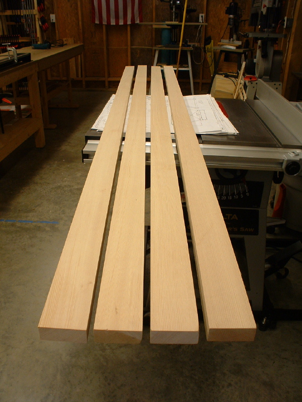

Message 4
| Subject: | Wooden Lift Struts |
As mentioned in an earlier post, Jim Markle and I are gathering the materials necessary
to construct our lift struts out of wood. I've done a little research
on the matter and have found that several people have done this with good results...
the latest being Axel Purtee, but others such as Douwe Blumberg, Wil
Graf, Keri Ann Price, Paul Poulin and Allan Weise have also chosen this method.
Before I push my shopping cart full of high dollar wood to the checkout lane...
any thoughts on this approach?
Mark Chouinard
Wings, Center Section and Empannage framed up - Working on Fuselage
http://forums.matronics.com/viewtopic.php?p=350315#350315

| Subject: | Re: Wooden Lift Struts |
Mark,
As you know, I'm not flying yet, but mine are laminated hickory. By ripping the
boards and turning the grain pattern, you only need to find boards with close,
straight grain. At home, I have a very thoughtful response from Cliff Dawson,
about the strength of wood, that totally assuaged all my concerns.
Gary From Cool
Thanks Gary... if you or Clif wouldn't mind, could you forward that information
to me so I can read his notes too? I've already e-mailed Clif directly with
a few more details on our proposed construction... perhaps he will see this and
share those thoughts.
I won't be home 'till Thursday...I'll send it then.
Gary
-----Original Message-----
[mailto:owner-pietenpol-list-server@matronics.com] On Behalf Of K5YAC
Sent: Tuesday, August 23, 2011 9:07 AM
Subject: Pietenpol-List: Re: Wooden Lift Struts
information to me so I can read his notes too? I've already e-mailed Clif
directly with a few more details on our proposed construction... perhaps he
will see this and share those thoughts.
gboothe5(at)comcast.net wrote:
> Mark,
ripping the boards and turning the grain pattern, you only need to find
boards with close, straight grain. At home, I have a very thoughtful
response from Cliff Dawson, about the strength of wood, that totally
> Gary From Cool
Mark Chouinard
http://forums.matronics.com/viewtopic.php?p=350325#350325

Message 34
Mark,
I am glad you asked the question. The picture below is the solid spruce I would
like to use for my struts. Any thoughts from all the good people??
Chuck in Raleigh NC
N899CB
http://forums.matronics.com/viewtopic.php?p=350380#350380
http://forums.matronics.com//files/spruce_struts_873.jpg
Message 35

Message 37
Chuck,
First I'm not an Engineer, A&P, IA or an authority on wood stress
properties. I built a laminated spar because those that did know about
these properties told me it was stronger than a solid spar. Again, not an
authority, I was concerned about hidden flaws in the wood and the laminated
spar helped with that concern.
Jack
DSM
[mailto:owner-pietenpol-list-server@matronics.com] On Behalf Of cjborsuk
Sent: Tuesday, August 23, 2011 7:27 PM
Mark,
would like to use for my struts. Any thoughts from all the good people??
Chuck in Raleigh NC
N899CB

At home, I have a very thoughtful response from Cliff Dawson, about the
> Gary From Cool
> materials necessary to construct our lift struts out of wood. > Before I
> push my shopping cart full of high dollar wood to the checkout lane... any
> Mark Chouinard
Message 44
| Subject: | spruce alternatives |
Go here and down the page about 3/4.
Two charts on wood properties.
http://www.clifdawson.ca/Homepage4-10-06/Tools_and_Tips.html
Message 45
Yeah, please do that when you get time Gary.
cdawson5854(at)shaw.ca wrote:
> It's a good thing you still have it because my 'pooter has disappeared the thing!
> How about sending it on to Mark for me.
Cool Gary wrote:
> At home, I have a very thoughtful response from Cliff Dawson, about the strength
Mark Chouinard
http://forums.matronics.com/viewtopic.php?p=350402#350402
