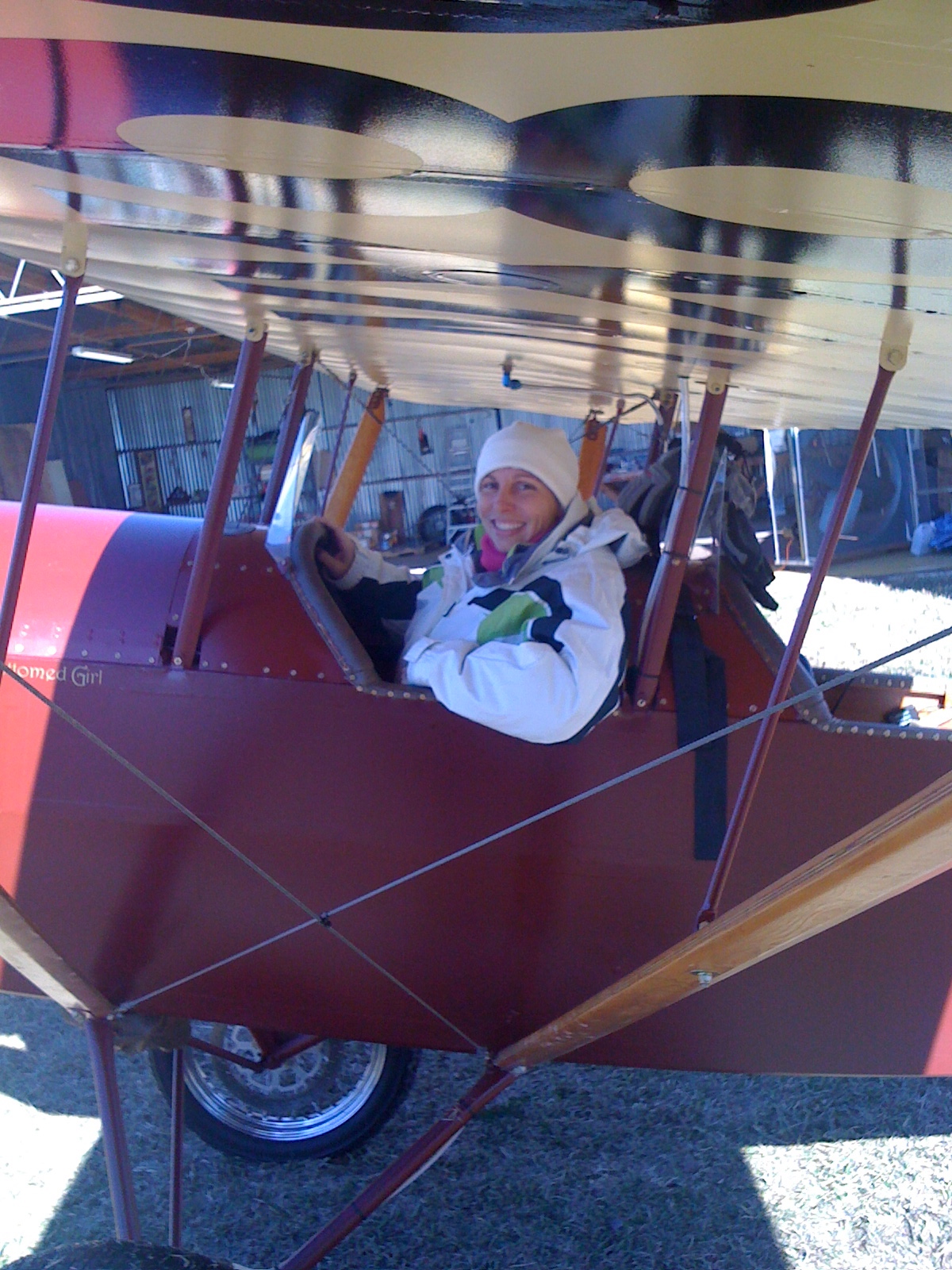

| Subject: | Windscreen sizing |
Folks,
I've searched the archives and found lots of discussions through the
years about windscreens, but didn't see a thread on the sizing of
windscreens. On the motorcycle forums, I found mentions that the top
edge of windscreens optimally should lie between the tip and bridge of
the rider's nose. Any thoughts, especially positive experiences, on
the optimal height and sizing of windscreens for Pietenpols?
Thanks, Ken
Message 6
Ken,
I think you would want it higher than that, and frankly, I'd make it as tall
as possible without looking "funny". Mine are about 10" tall and I wish I
had made them a couple inches taller. Here is a picture of my installation:
The windshields on John Hofmann's "502 Rocket" are taller, and you can
comfortably fly behind them with no goggles or sunglasses, as shown below:
Hope this helps,
Jack Phillips
NX899JP
Smith Mountain Lake, Virginia

Message 7
| Subject: | Re: Windscreen sizing |
Hope you get good responses on this. I kinda took the easy route and cut a couple
old motorcycle windshields down to fit my fuselage and guessed at having them
about even with the top of my head. I haven't got many hours on it but it generally
ok as long as I sit directly behind it and I can even fly with a ball
cap on and it stays but you better not raise up any or lean very far to the side.
I had a headset on one day and twisted around just a little for something
and got it in the slipstream and that sucker was gone.no doubt bigger is better.
I have not ridden in the front seat yet or has anyone else.Raymond
Jack, this is helpful. My sense, however, is that you are considerably
taller than me. I'm wondering, if you were to use yourself as a metric,
where is the top of your windscreen relative to your facial features?
Again thanks, Ken

Message 9
If possible, I would wait until you can sit in the pilot's seat, with the engine/prop
running, and experiment. Probably won't be a perfect answer but close.
So why not wait on the windscreen design/sizing until after the engine is installed?
Cut some different sizes and hold them up while the prop is producing wind......angle
it, tilt it, resize it....I would think that would get you pretty close....
Jim

Message 19
Kevin just recently made new windshields, and I requested the front windshield
to be about an inch higher. At the height in this picture, the wind really pushed
around my headgear. Since the adjustment, I can get out of the airplane
looking freshly coiffed. As many of you know, my hair is quite long, so being
able to keep it from flying around is paramount. IMHO I think you will make your
wife or and female front seat passenger more comfortable with a higher windshield.
Shelley Tumino
IT Girl
wife of "Axel"
NX899KP
DO NOT ARCHIVE
http://forums.matronics.com/viewtopic.php?p=350962#350962
http://forums.matronics.com//files/img_0036_129.jpg
Message 20
Sure.... Tell me more about your hair.... Lol! The smile says it all
KMH Sent from my iPhone
pushed around my headgear. Since the adjustment, I can get out of the airplane
your wife or and female front seat passenger more comfortable with a higher windshield.
> Shelley Tumino
> IT Girl
> wife of "Axel"
> NX899KP
> DO NOT ARCHIVE

Message 22
As Ike Turner was known to say ".Wimmins be thinkin' too much"
Jack Phillips
NX899JP
-----Original Message-----
[mailto:owner-pietenpol-list-server@matronics.com] On Behalf Of IT Girl
Sent: Monday, August 29, 2011 6:43 PM
Subject: Pietenpol-List: Re: Windscreen sizing
windshield to be about an inch higher. At the height in this picture, the
wind really pushed around my headgear. Since the adjustment, I can get out
of the airplane looking freshly coiffed. As many of you know, my hair is
quite long, so being able to keep it from flying around is paramount. IMHO I
think you will make your wife or and female front seat passenger more
Shelley Tumino
IT Girl
wife of "Axel"
NX899KP
DO NOT ARCHIVE
