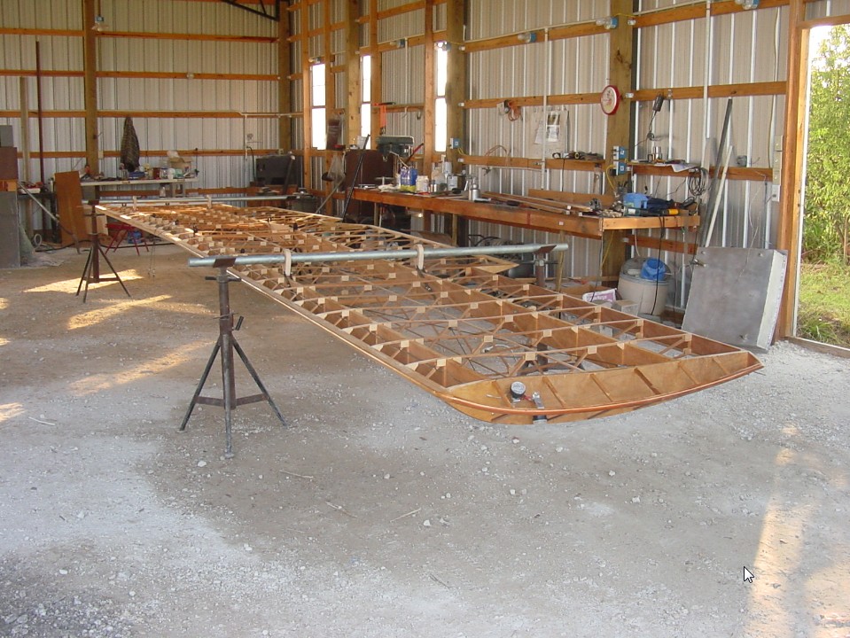

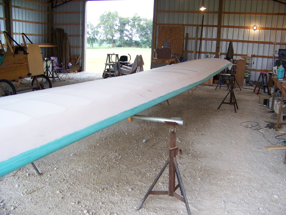

What Jack P said. I built the one piece wing and have a 40 X 50 hangar. It is 32.5
feet. I just finished covering it. Without a fancy jig to hold it you will
need 4 people total to turn it over safely. Dan Helsper built the fancy jig.
I did not. I have turned it 3 times so far. Now the finishing (painting and sanding
starts) and turning starts. I figure to turn it at least 4 more times. I
am fortunate to have family and friends that can come over after work to help.
Jerry Dotson
59 Daniel Johnson Rd
Baker, FL 32531
Started building NX510JD July, 2009
now covering
21" wheels

With the one-piece wing, you will almost always need help turning it over d
uring the building process. It is difficult to paint, because there are ver
y few places to grab on while turning. Also, If you ever needed to move the
airplane with a truck or trailer it be a very long truck or trailer. But b
eing a purist, I had no choice but to do it.
Dan Helsper
Puryear, TN

http://forums.matronics.com//files/2011_09_25_08_56_37_736_998.jpg

Yep, that's the way. I found it easiest to make a nice fitting set of master parts
and duplicate 32 times for each. Much more efficient than walking back and
forth to the band saw and disc sander for each rib. These aren't all my parts,
but you get the idea.
Same goes for the gussets. Regardless of the style you choose to make, make them
all and press on.
