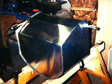

Michael another caution for you. Make sure you leave plenty of clearance
for tank fit. I thought I did and it fits tighter than I would like.
Jack

Thanks Jim. When I use a break for my other thin metal bending, I use some
thin AL. on top of the bend as you describe. This also negates any tool
mark/ scratches.
Michael Perez

> If you're going to put sharp bends in the sheet, spend a
> few minutes and find out what the minimum bend radius should
> be for your chosen material and its thickness. Smaller than
> this, you risk cracking the corners. I just found a chart in
> AC43-13 online at:
http://www2.tech.purdue.edu/at/courses/at308/Technical_Links/Ac43-13-1B/CH4_
4.pdf
> Interestingly, 5052-H32 at thicknesses .032 and smaller
> have zero minimum on this chart. .064 says 1/2-1 times the
> thickess of the sheet. Not having a table entry for .040,
> I'd err on the conservative and go with the .063 number, and
> I'd probably go more conservative and use the 1x radius
> instead of the 1/2x, leaving me with a minimum radius of
> .040.
> Keep in mind, it's the minimum, so your results don't have
> to be accurate to that radius, just larger than the minimum.
> If you're bending these corners with a brake, lots of folks
> slide a piece of scrap sheet or cardboard on top of the
> sheet you care about to establish the radius. A drill bit
> laid inside the bend makes for a quick gauge of the radius.
> Jim Ash

> >The 5052 is very nice to work with. I made a nose tank
> that holds 14.5 gallons. I used exterior flanges of about
> 3/8", mainly because it is easier to hold together for
> welding. Just two pieces. Kinda like two clam shells. First
> welded a nice pretty seam and had leaks. The went back over
> it with a big ugly seam and have never had a leak. One very
> important consideration is to keep it high enough to clear a
> persons feet in the front cockpit. This will also keep it
> high enough for head pressure. These are old "pre digital
> camera days" pictures.
> >Don Emch

Thank you all for the help. I am going to re-template the tank from scratch
to incorporate flanges for the weld areas and to make it more "bend" frien
dly...to do fewer welds.- From what I gather, most can handle being in th
eir planes around 3 hours, so as long as I can get-at least-15 gals. or
so out of it, that should be good.
Michael Perez
