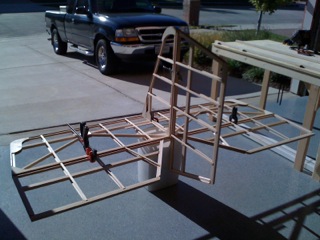

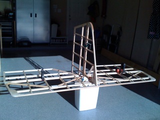

Message 23
| Subject: | Re: Work table thoughts, and rib jig done! |
Early in my Piet project I made one large 4 X 16 feet table on casters.
It has been extended by 2 more feet for my next project.
With casters it easy to roll around with or without project on top.
Of course your workspace might limit the size of your table.
I do recommend plate mounted casters I beleive got them cheap at harbour fr
eight
No need to screw in to the end grain if you do it my way, see pic.
Hans
NX15KV

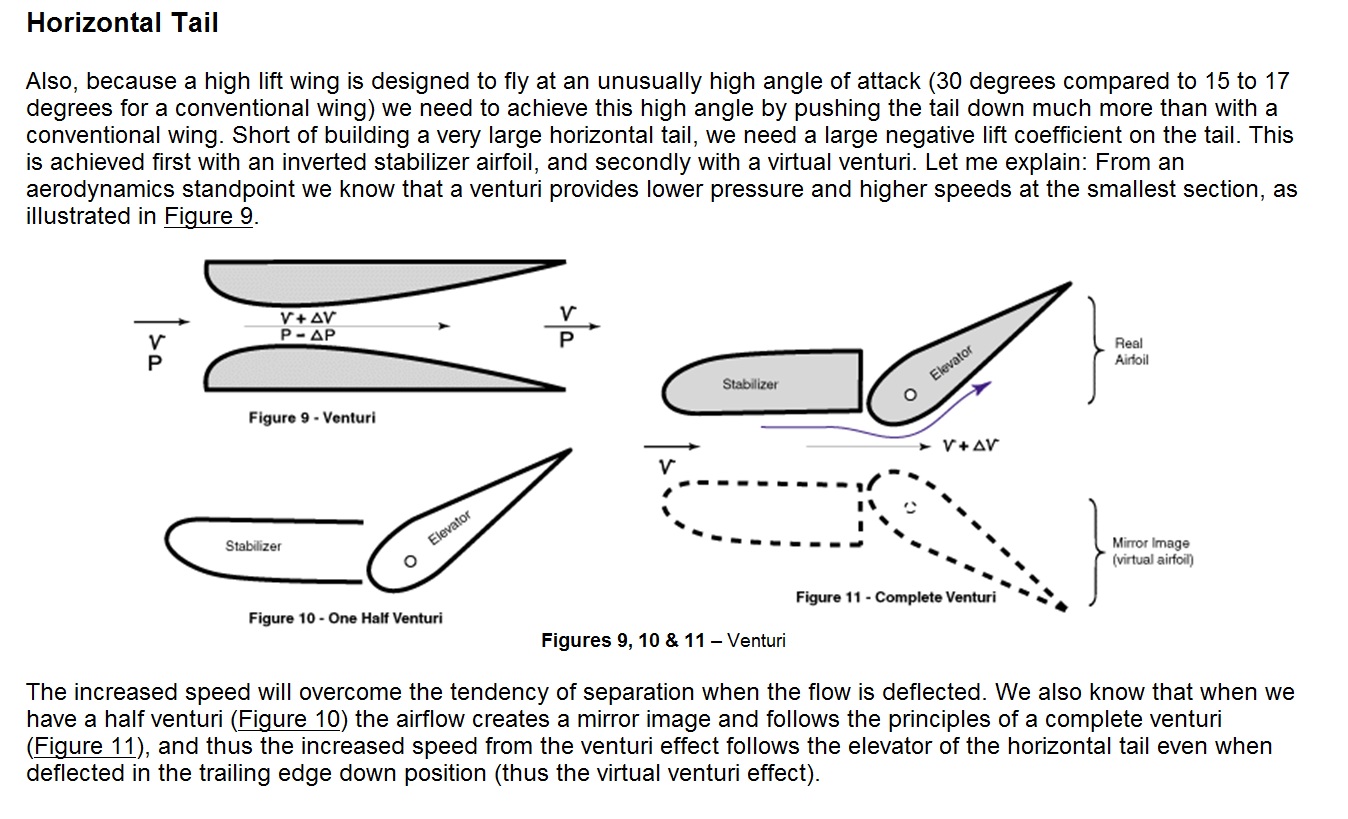

Message 24
| Subject: | Pietenpol Tail Aerodynamics |
I have seen on the web, (although I could not find a picture just now to post)
of planes (STOL type) with a large upside-down looking airfoil shape on the horizontal
stabilizer. Perhaps this idea can help with the tail heavy woes of the
Pietenpol that I hear about.
Michael Perez

Message 27
| Subject: | Re: Pietenpol Tail Aerodynamics |
Upside down airfoil would make the airplane more tail heavy, wouldn't
it?
----- Original Message -----
From: Michael Perez
To: pietenpol-list@matronics.com
Sent: Friday, December 09, 2011 12:41 PM
Subject: Pietenpol-List: Pietenpol Tail Aerodynamics
just now to post) of planes (STOL type) with a large upside-down looking
airfoil shape on the horizontal stabilizer. Perhaps this idea can help
with the tail heavy woes of the Pietenpol that I hear about.
Michael Perez
Karetaker Aero
www.karetakeraero.com
Message 28
The Zenith 701 has a inverted stabiliser.
http://www.zenithair.com/stolch701/index1.html
Gerry

Here's Chris Heintz's reason for the inverted airfoil on the horizontal stab of
his 701 STOL design, and an explanation of how it works.
Obviously, if it works on that plane, it would also be a good idea for the Pietenpol...
;) (just kidding).
Aircraft design isn't all cut and dried. It can be very complicated stuff. That's
why I choose not to mess around with it. The Air Camper has a known characteristic
of flying with a slightly drooping elevator in level flight. I'm okay
with that. I'm sticking to the plans.
Bill C.
http://forums.matronics.com/viewtopic.php?p=360558#360558
http://forums.matronics.com//files/zenith_hstab_301.jpg

You're confusing static CG with aerodynamics. Unless in motion through the
air, the horizontal/elevator will always exert the same weight in a level
attitude. And yes, the "upside down airfoil" would make the tail be
"heavy" in flight. This, as mentioned earlier, will offset the normal
relationship of CG vs. Center of Lift where the CG is forward of the Center
of Lift, there by making the airplane, in flight, think it is nose heavy.
See this video:
