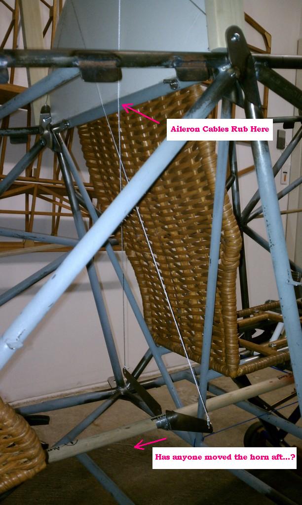

Hello List,
I have mocked up the flight controls in my Piet and am finding that if the cabaine
struts are vertical then the aileron cables rub on the fuselage frame per
the attached image. (Many Piets have their cabaine struts slanted aft a few inches
for weight-and-balance, but I want to protect for some adjustment and allow
them to be vertical without control cable rubbing problems.)
Question: Has anyone ever moved the aileron control horn aft on the control bar
to help alleviate this problem... or does this just cause some other problem
I am not aware of.....?!?!? (I am considering 1 & 1/2 inches aft)
Moving the horn aft would also mean that I would have to move the forward pulley
(which is on the control bar) aft and I am not sure if that would be a problem
as well......!?!??!
.....or is there some other fix that people have done....?!?!?!?
It also seems like the aileron control cables are awfully close to rubbing on the
cross brace cables for the cabaine struts....!?!?!?
Thanks in advance for any help............

I could move my aileron horn without moving the pulley (except that mine are
already welded. If I wanted to move the horn I would have to start over).
Why do you think you would have to move the pulley? They are completely
seperate items.

Guess I just figure I could beef them up a tad and separate them but per the plans
it looks like they integrate/work together structurally nicely when they are
welded as a set....??!!?!?!?

As I recall, my aileron cables had some interference, which I eliminated by
judicious application of a hammer on the control horns on the torque tube.
Do what you've got to do.
