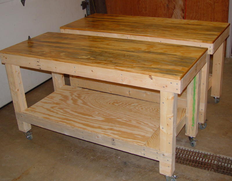

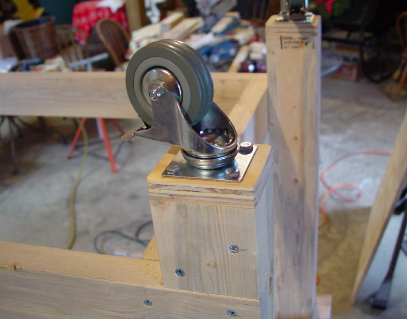

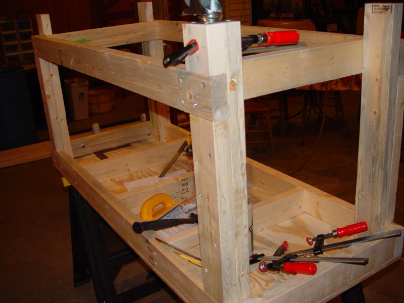

Message 8
      I decided to build the standard EAA workbenches with locking casters.  I have two
      done and two to go.  I ended up using lag bolts through plywood end pieces
      to hold the casters in place.
      John
      http://forums.matronics.com/viewtopic.php?p=361431#361431
