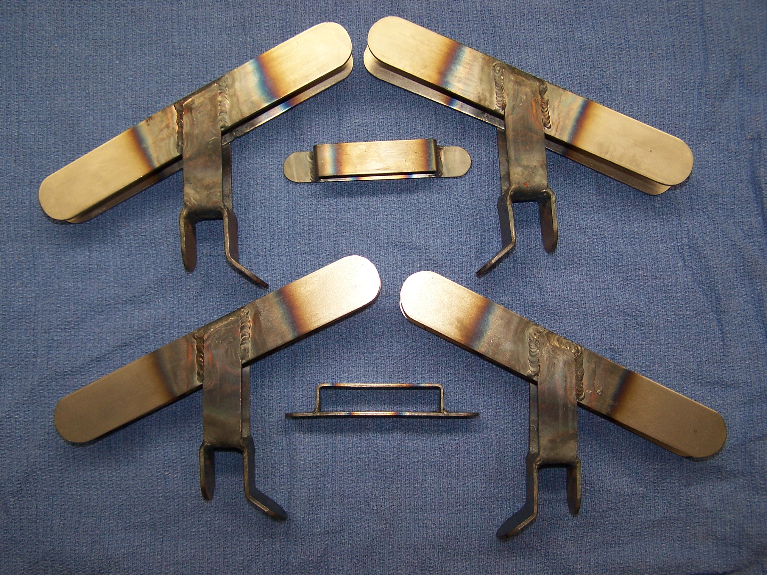

Last time I painted anything aircraft I used Epoxy Zinc Chromate.
Doug Dever
In beautiful Stow Ohio
> Subject: Pietenpol-List: Metal primer
> From: tdudley@umn.edu
> Date: Thu=2C 22 Dec 2011 19:04:51 -0800
> Like a few others on the list I've got a few holiday "days" off. I'm goin
g to weld my wing cabane fittings and want to get them primed.
> I know Bingelis says zinc chromate for priming the metal. I've found it a
vailable at Aircraft Spruce and Wicks=2C but was wondering if it was an ite
m I might find (or substitute) locally. I live in a small town but it has 3
autobody shops that have auto metal primers=2C but the ones I've seen don'
t have zinc chromate as an ingredient.
> Is it okay to use a metal primer (such as for autos) that doesn't have zi
nc chromate (or phosphate) as a component? Or is this something I need to o
rder from an aircraft supply company (like I've done for all wood=2C metals
=2C glues=2C bolts=2C cables=2C etc.)
> Thanks=2C
> Tom
> http://forums.matronics.com/viewtopic.php?p=361513#361513

I don't think you can buy REAL zinc chromate primer any longer thanks to the
EPA. Maybe Chromium is a toxic heavy metal? The "new" stuff seems to be no
better than weak green paint.
Jack Phillips has the correct answer, just use a self-etching epoxy primer
available at any auto paint store. The brand we use is Variprime. It works
great and gives great "tooth" for the topcoat to stick to.
Barry
-----Original Message-----
[mailto:owner-pietenpol-list-server@matronics.com] On Behalf Of
tdudley@umn.edu
Sent: Thursday, December 22, 2011 10:05 PM
--> <tdudley@umn.edu>
Like a few others on the list I've got a few holiday "days" off. I'm going
available at Aircraft Spruce and Wicks, but was wondering if it was an item
autobody shops that have auto metal primers, but the ones I've seen don't
Is it okay to use a metal primer (such as for autos) that doesn't have zinc
order from an aircraft supply company (like I've done for all wood, metals,
glues, bolts, cables, etc.)
Tom

Thanks for all the input. I hope to put it to good use. I did check the local
NAPA today and found an etching primer and a primer coat (in a rattle-bottle).
I also saw the two part epoxy. Powder coating the metal seems like a great
idea, but I don't have a "garage" oven available.
I guess I'll end up ordering primer from AS or Wick's to keep everything as "safe"
as I can. Besides, I worked pretty hard today and wouldn't want to ruin these
things:
(I have never figured out how to make the pictures smaller, but I have tried.)
Thanks again,
Tom
