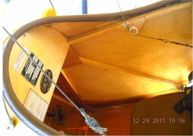

Looks like someone got a deal (the purchaser - not the seller).
The only oddity I see is a very odd aileron cable routing. From the photos it appears
that the aileron control cables have been rerouted so that they don't pass
through the instrument area. That could be a nice feature, BUT... the new
route has the cables seriously impeding access to the front seat. Not sure how
anyone would manage to get in that front seat.

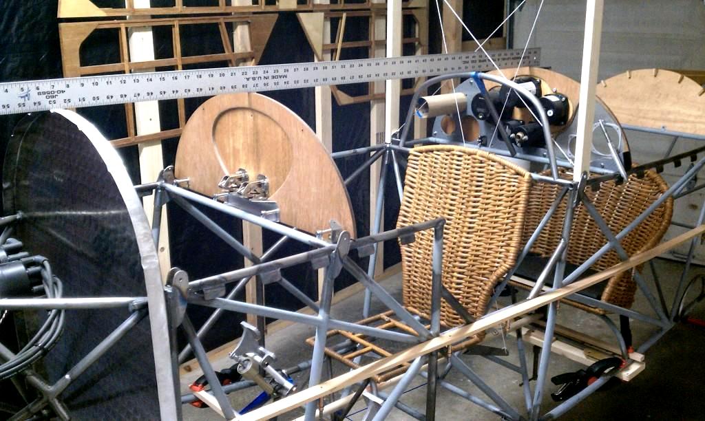

Hello good Piet-ple...
Thought Id post an update on my project
I was able to spend 8 of the 9 days off during the holiday break in my workshop
mostly fabricating small pieces and parts. There are lots more to go and yet
Im fine with that as I am enjoying the adventure/experience/journey.

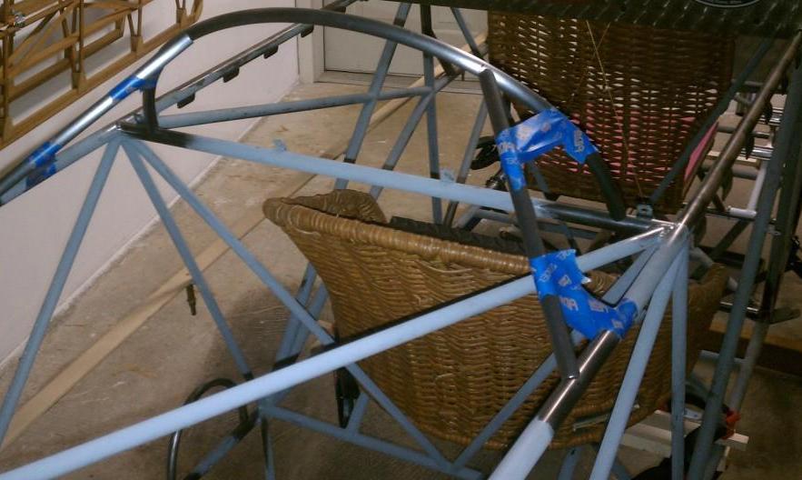

Part of the challenge with the Pietenpol design, especially with the steel-tube
fuselage version, is that so much of it is not defined on the plans. I therefore
spend a great deal more time designing certain elements than I actually do
fabricating the parts. An example of this is where the shoulder harness and seat
belts attach to the frame.
The photos show that my solution in this area has been to form a 4130 steel tube
bow behind the pilot and passenger seats. The nylon shoulder harness straps
will wrap around these tubes and should not interfere with the other things that
share that same volume such as the back of the instruments, the cross bracing,
aileron control cables, and instrument wires & pitot tubing. Mocking the area
up with string and cardboard parts has really helped to visualize this volume.
The pilots shoulder harness may still route back to fittings under the turtle
deck aft of the seat, but the bow will share the load and provide support
under the turtledeck structure in case someone sits on it while climbing into
the pilots seat.
I have been asked how much of the design I changed from the original plans. My
best answer may be to say that from the side view, it is dimensionally EXACTLY
the short fuselage steel-tube Pietenpol dimensions taken directly from an original
copy of the 1932 Flying and Glider Manual. The fuselage was made two inches
wider than plans and I increased the diameter and number of tubing segments
to carry structural loads around the area of my left side door cutout.
Ive included a screen shot of the fuselage truss I created in CAD which shows the
exact lengths of the cross members (centerline-to-centerline dimensions) because
when you make the fuselage two inches wider than plans, all the dimensions
in the tapered (aft fuselage) section are different than the plans.
In addition, I have installed more structure than that image shows to attach things
like rudder pedals, seats, and control bar fittings. Everywhere a critical
part mounts to the airplane, there will be a tab welded to the frame so all
critical parts are attached to the structure itself, not secondary structure such
as the plywood floor.
All this redesign adds some weight but the tubing itself is surprisingly light
(overall lighter than the wood fuselage by about 30 pounds if my numbers are correct)
and the few times I may add a bit of weight to my airplane I want it to
be for a conscious purpose.
Note: As a caveat, I have not yet completed this plane, so all things at this
point (January 2012) are just my current solutions/thinking and are subject to
change(!)

I don't know whether I'd like the aileron cables routed that way...Just my opinion.

The pictures do not do justice to the great work you have done. Very nice.
To those reading- I have been to the Newport Way Air Museum (His house), and I
can attest to the really nice work Jake has done. I can't wait to see his finished
aircraft when he makes his Jake-Across-The-USA tour.
Again, nicely done.

Thanks Jake. The pictures and work are great, and I can see the amount of designing
you have incorporated so far, such as the brakes, rudder pedals and seats.
I came home today, and my plans were in the mail box. I have lurked about the
site for many years, and met several piet folks over the last year. I have been
interested in building a steel tube piet with possibly an 0-200 for power.
I was thinking of using a form of the long fuselage by stretching the steel tube
planand possibly increseing the tube size.. Keep up the great work!
