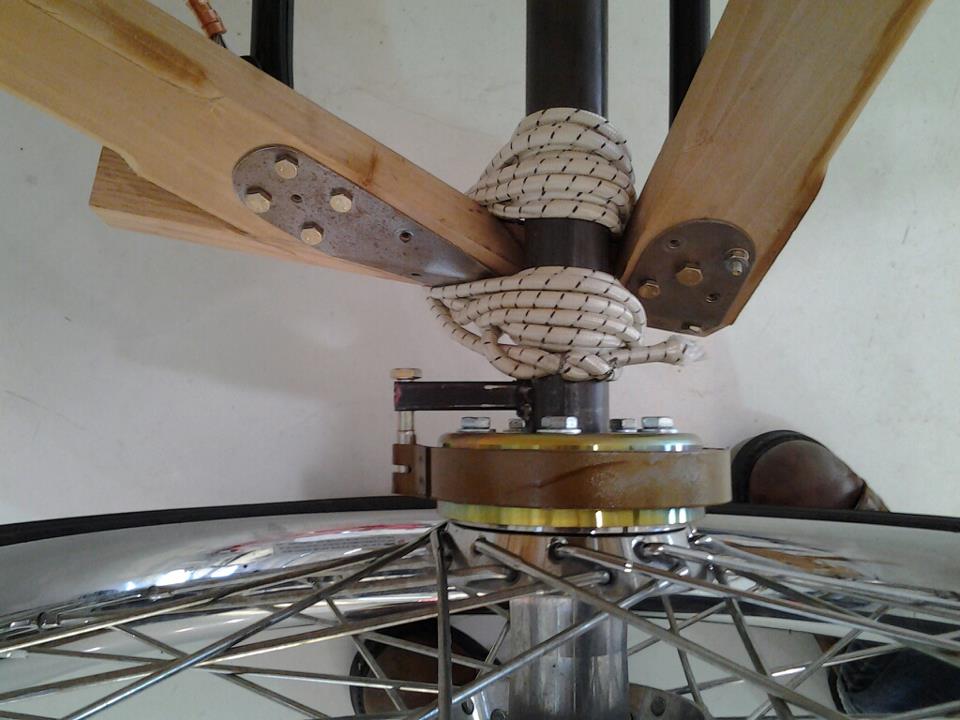

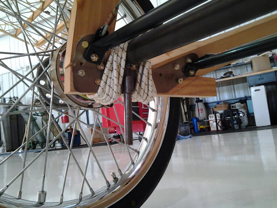

      thanks gentleman...
      did some welding..here it is
      i had some 5/16 bungee around so i put 14 feet on each side just to check things
      out...easier to preload it won't move with just me on board..
      jeff

      Looks cool Jeff............
      Dan Helsper

      Will you be installing anything to prevent chafing of the bungee's on
      the fasteners?
      The bungees on NX18235 were being replaced annually (my least favorite
      job) until we installed a leather cuff to protect the bungees.
      Greg Cardinal
