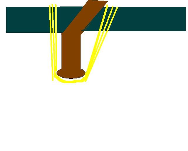

      Do you have a photo of that leather cuff? My bungees also get chafed by get
      ting pinched by the spruce "V" pieces during routine stretching during taxi
      , landing etc.

      Will you be installing anything to prevent chafing of the bungee's on the f
      asteners?
      The bungees on NX18235 were being replaced annually (my least favorite job)
       until we installed a leather cuff to protect the bungees.

      actually i plan to rivet the lower brackets together and i will either make a new
      lower ash piece or glue more to the bottom in a rounded shape extending slightly
      out to keep the bungee off of the metal..
      the legs are still rough
      jeff

      I don't have photo but I will try to come up with a drawing later today.

      Attached is a drawing of the anti chafe cuff.
      I purchased the leather from a local saddle shop. It was referred to as
      "sole leather" because it is relatively thick, about 1/8". It was very
      stiff but leather can be formed easily by soaking it in water for a few
      minutes.
      It is attached to the bottom of the ash block with a couple of small
      screws but the bungees keep it held in place.
      Round headed rivets per the original plans instead of threaded fasteners
      in this location would most likely eliminate the need for the leather
      cuff.
      Greg Cardinal
      Minneapolis

        Greg,
      by getting pinched by the spruce "V" pieces during routine stretching
      during taxi, landing etc.
        Dan Helsper
        Puryear, TN

        Jeff,
      the fasteners?
      job) until we installed a leather cuff to protect the bungees.
        Greg Cardinal
        Minneapolis

      I LIKE it!  Great idea, Greg.  I'll do this when I replace the bungees on
      mine this April, during the Condition Inspection.
      Jack Phillips
      NX899JP
      Smith Mountain Lake, Virginia
