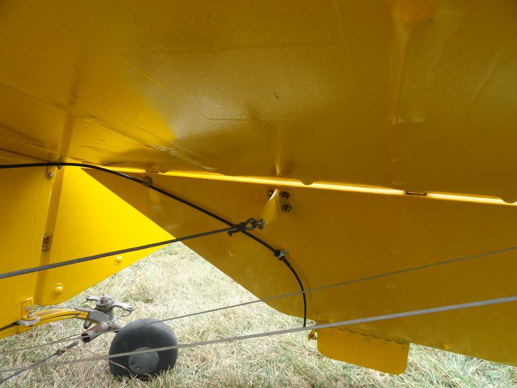

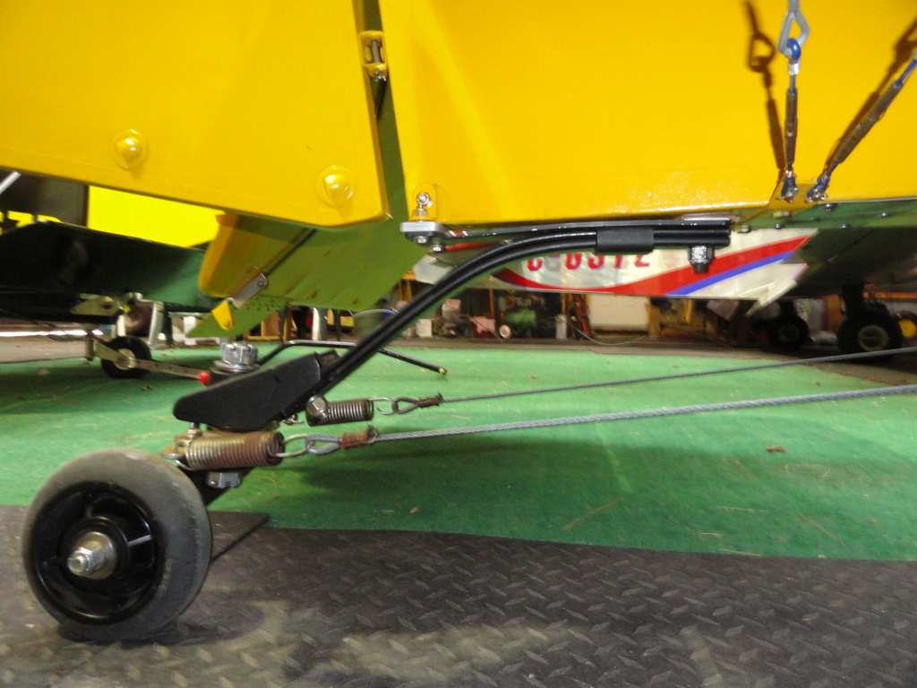

Message 9
| Subject:  | Re: leaf springs for tailwheels |
      As Mike mentioned, the best setup appears to be a combination of two leaf springs.
      My original setup had a spring  that was too stiff and not enough arch to
      give proper ground clearance. The original tail wheel was a Maule which was worn
      out and no longer was plumb with the aircraft causing some exciting moments
      on some landings.
      Replace the spring with one from ASS PN 0-614200 designed for a Cub. Removed the
      short spring and fabricated a new bracket to accept the existing mount points.
      Replaced the tail wheel with a Matco 6" which proved to work very well with
      much better ground clearance.
      Adrian M
      Winnipeg, MB
      Canada
      http://forums.matronics.com/viewtopic.php?p=363730#363730
