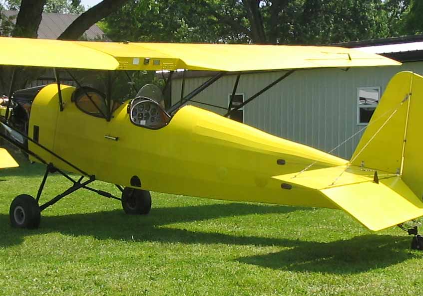

      Y'all are worrying too much again.  We don't know anything about the
      Pietenpol in that picture.  It may have had very thin stringers, or it may
      have been covered with cotton which was glued on too tight, and then over
      time the dope tautened more than anticipated (butyrate dope continues to
      shrink for years).  If you use dacron, follow the manufacturer's guidelines
      for shrinking - not the advice you think you hear on this list.
      Mike Cuy gave good advice to add little pieces between the stringers.  It
      takes little time and adds almost no weight.  I did it on mine, per his
      advice.  Was it necessary?  The only way to know for sure would be to add
      the pieces on one side but not the other and see if the side without
      reinforcement warped.  I wasn't that curious.
      You can see these pieces in this photo:
      Jack Phillips
      NX899JP
      Smith Mountain Lake, Virginia

      Jack is right about not knowing the specifics of the plane in the photo. As I recall
      from when I took the photo several years ago, very little of that Air Camper
      was built "to the plans". For instance, the wings are actually from a different
      aircraft, the cabane strut system is completely different, the aileron
      control cable system was redesigned, there was a beefy passenger door, etc., so
      I would not be surprised if the turtledeck was also "improved". In fact, I'd
      be surprised if it wasn't.
      Bill C.

      Looks to me like the plane might be a modified GN-1.  C
      ----- Original Message -----
      From: "Bill Church" <billspiet@sympatico.ca>
      Sent: Thursday, January 19, 2012 10:31 AM
      Subject: Pietenpol-List: Re: how to reinforce stringers so they don't bend
      when you tight
      > As I recall from when I took the photo several years ago, very little of
      > that Air Camper was built "to the plans". For instance, the wings are
      > actually from a different aircraft, the cabane strut system is completely
      > different, the aileron control cable system was redesigned, there was a
      > beefy passenger door, etc., so I would not be surprised if the turtledeck
      > was also "improved". In fact, I'd be surprised if it wasn't.
      > Bill C.

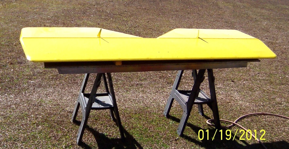

| Subject:  | Bugs in Piet yellow |
      The weather got real nice this morning and I painted the horizontal stabilizer,
      elevators and ailerons. All went well except for 2 flies that love Piet yellow.
      Jerry Dotson

| Subject:  | Re: Bugs in Piet yellow |
      Flying in Florida, you'll always have a few bugs on your leading
      edges....Don't let a few flies slow you down.
      Ben
      There absolutely HAS to be future name for Jerry's Piet hiding in that second pic!
      PAPA MIKE

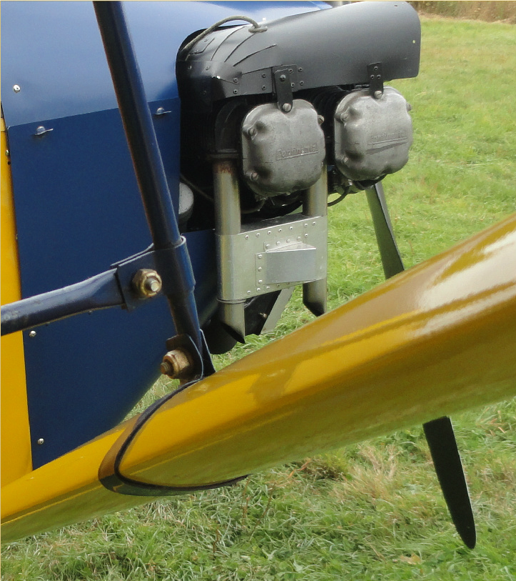

| Subject:  | Photos of jury strut fittings on aluminum struts |
      Greg,
      I finally found these pics you requested. This set-up worked well for me.
      Dan Helsper
      I see more lift

| Subject:  | Re: Photos of jury strut fittings on aluminum struts |
      Here's another similar idea.
      Adrian M
      Winnipeg, MB
      In Florida, once a couple are stuck to your leading edges, you'll need the multi
      rating.
