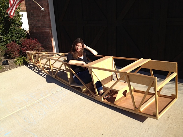

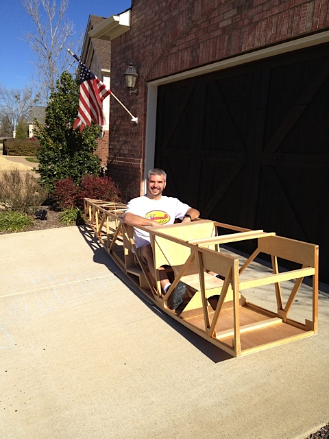

Looking good Curt!

Hi Curt,
Looking good!.....bet you made the official 'airplane noises'??

I finally got to sit in the pilot seat of a Piet!
Curt Merdan
Flower Mound, TX
http://forums.matronics.com/viewtopic.php?p=364374#364374
http://forums.matronics.com//files/img_2849_303.jpg
http://forums.matronics.com//files/img_2850_148.jpg

Looks fantastic....! Your Piet is almost finished....
