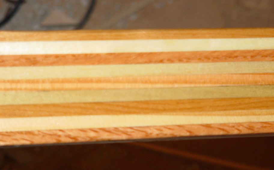

Gary, I can buy a set of T-craft struts that a friend of mine had to
take off his plane and replace with new. He says the old ones are
perfectly sound -- he had to replace because of an STC or something. Do
you think they would be as serviceable as laminated wooden struts? I am
planning to use wooden landing gear legs. Chuck
----- Original Message -----
From: Gboothe5
To: pietenpol-list@matronics.com
Sent: Tuesday, January 24, 2012 9:33 AM
Subject: RE: Pietenpol-List: Wood Lift Struts
Jeff,
I'm no expert, but I have made 3 sets, so far, one of which is
currently flying on Kevin Purtee's Fat Bottom Girl. I do not think that
a solid strut, made from a perfect piece of wood, would be any less
strong.the key word being "perfect." Good luck finding that. Laminating,
allows you to use boards that may have imperfections (knots, grain
variance, warpage, etc) by ripping and using the good portions. In my
case, I bought 7/8" hickory boards, ripped them to 1 1/16", turned them
and glued them so that I created 1 1/16" thick struts, made up of, at
most, 7/8" rips. This allows you to turn a flat grained board into
vertical grain rips, and warpage can be almost eliminated in the gluing
process.
Happy Building,
Gary from Cool
NX308MB
[mailto:owner-pietenpol-list-server@matronics.com] On Behalf Of jeff
wilson
Sent: Tuesday, January 24, 2012 6:12 AM
To: Matronics
Subject: Pietenpol-List: Wood Lift Struts
Hey guys,
Question about the wood struts. I plan on using wood gear and wood
lift struts and the question is about solid versus laminated on the
struts. I am planning on solid. I know many of you like the laminated
look but is it any stronger. I've looked through AC 43-13 some but have
not really found anything recomending one way or the other. I have all
4 of Tony B's books but haven't had time to search through them yet for
comments on the subject. So since I'm wasting time at work checking my
personal email I'll throw this one out there.
What's functionally better for wood lift Struts, solid or laminated.
Jeff Wilson

| Subject: | Wood Lift Struts |
Chuck,
Most Piet builders would love to stumble upon a set of used struts, as you
have! My choice of wood is merely personal. Carry on, young man!!
Gary from Cool
NX308MB
[mailto:owner-pietenpol-list-server@matronics.com] On Behalf Of C N Campbell
Sent: Tuesday, January 24, 2012 7:48 AM
Subject: Re: Pietenpol-List: Wood Lift Struts
Gary, I can buy a set of T-craft struts that a friend of mine had to take
off his plane and replace with new. He says the old ones are perfectly
sound -- he had to replace because of an STC or something. Do you think
they would be as serviceable as laminated wooden struts? I am planning to
From: Gboothe5 <mailto:gboothe5@comcast.net>
Jeff,
I'm no expert, but I have made 3 sets, so far, one of which is currently
flying on Kevin Purtee's Fat Bottom Girl. I do not think that a solid strut,
made from a perfect piece of wood, would be any less strong.the key word
being "perfect." Good luck finding that. Laminating, allows you to use
boards that may have imperfections (knots, grain variance, warpage, etc) by
ripping and using the good portions. In my case, I bought 7/8" hickory
boards, ripped them to 1 1/16", turned them and glued them so that I
created 1 1/16" thick struts, made up of, at most, 7/8" rips. This allows
you to turn a flat grained board into vertical grain rips, and warpage can
be almost eliminated in the gluing process.
Happy Building,
Gary from Cool
NX308MB
[mailto:owner-pietenpol-list-server@matronics.com] On Behalf Of jeff wilson
Hey guys,
Question about the wood struts. I plan on using wood gear and wood lift
struts and the question is about solid versus laminated on the struts. I am
planning on solid. I know many of you like the laminated look but is it any
stronger. I've looked through AC 43-13 some but have not really found
anything recomending one way or the other. I have all 4 of Tony B's books
but haven't had time to search through them yet for comments on the subject.
So since I'm wasting time at work checking my personal email I'll throw this
one out there.
Jeff Wilson
St. Louis
Sackman H49
http://www.matronics.com/Navigator?Pietenpol-List
http://forums.matronics.com
href="http://www.matronics.com/Navigator?Pietenpol-List">http://www.matronic

| Subject: | Re: Wood Lift Struts |
It seems to me that the main issue with wood struts is how you attach the end fittings.
The issue there is preventing elongation of the holes, and minimizing
any structural integrity issues that may arise if they do.
First, nearly all wood/metal interfaces rely on friction between the fitting and
the wood to prevent the penetrating bolts from relying on shear force. The
bolt can handle the shear, the metal fitting can handle the shear, the wood is
clearly the weakest link.
In the case of mounting a wood prop, Sensenich's documentation clearly states that
the bolts should hold the prop to the shaft and crush plates to the point
that the prop can't rotate and put the bolts in shear, which will elongate the
holes in the prop.
In the case of a wood strut, the thing is in tension, so this is especially important.
Wood moves a lot. It grows and shrinks in all three axises with moisture variation.
If a board has the growth rings basically parallel to the face of the board,
it's "flatsawn". It will expand and contract across the width (in percentage)
the most. Next the thickness, and last by a margin is the length.
If you turn a flatsawn board into a quartersawn board (like Gary describes), you
will maximize the stability of the board. The metal fitting will not change
it's width enough to matter. The board will, and will thusly elongate the holes
accordingly (if the bolts are a tight fit). By using quartersawn wood you
minimize this.
The only part of the board that matters where a hole goes through it near the end,
is the little piece between that hole, and the end of the board. In the case
of quartersawn, it seems that it could much more easily be broken out, than
if the board were flatsawn.
If you can hang on to a board well enough, flatly pulling it apart is simply not
the issue. If you can stabilize it well enough, so that column bucking doesn't
come into play, flatly squashing it isn't much of an issue either.
If a board is dried correctly, then milled correctly, warpage, cupage and twist
really aren't a concern (as they are negligable). They don't affect the strength
of the wood anyway enough to matter.
I think if you can't get wood that at least approches aircraft quality (basically
meaning no knots and straight grain without major growth defects) you need
to laminate up a piece. I don't think it matters if you laminate to width or
thickness, just however you like the look or need to for available wood. If you
do have decent quality wood, I think it's fine as a solid piece.
No matter how you do it, properly engineered ends and properly installed, REALLY
REALLY matter.
Tools
http://forums.matronics.com/viewtopic.php?p=364695#364695
Message 16
Oh by the way, if you think you need to laminate, but like the look of solid...
with careful selection of how you orient the wood, you can do A LOT of laminating
that basically isn't noticeable.
When I was a severely broke young lad, I had to rely on gluing up FIVE pieces of
wood for a drawer front that was only about 4 inches tall. You can't tell it's
not one piece of wood.
How the grain is oriented to prevent warps and stuff, really won't matter in a
board as wide as a strut. I routinely glue boards together up to 36" widths and
have never had a problem with them cupping or warping or anything. I've done
this in environments from the dessert to the southeast.
Tools
http://forums.matronics.com/viewtopic.php?p=364697#364697
I do know that laminated spars can be used as a direct replacement for soli
d spars (AC-43-13), but not sure that the strength is any greater than a "p
erfect" solid plank.- I would speculate (just a wild ass guess)-that it
would be pretty darn hard to over stress Kevin's struts in any thing other
than a 10 G pull up (which might require 2 corvairs, and a jato bottle).
- And even then I bet the bolts would shear off first.- I would say to
use whichever medhood looks better to You.- As Jack mentioned, I do like
the fact of cracks being contained to the respective lamination, thus allow
ing time to catch a failure before it happens.
Shad

One other advantage of laminations (as long as the planks are in line
with
the centerline of the airplane) is that it makes sanding them uniformly
very
easy. If you see that the glue lines are not straight and parallel with
each other, you are not sanding evenly. I laminated my gear legs and
this
was an unexpected benefit (see photo below):
Jack Phillips

I laminated my struts from red oak, ash, pecan, poplar, Douglas fir, and Magnolia
bay. I used all the different woods purely for looks. I don't know about ultimate
strength but it is a LOT stiffer than a piece of red oak the same size.
Each layer is 1/4" thick.

They're beautiful, Jerry!!
