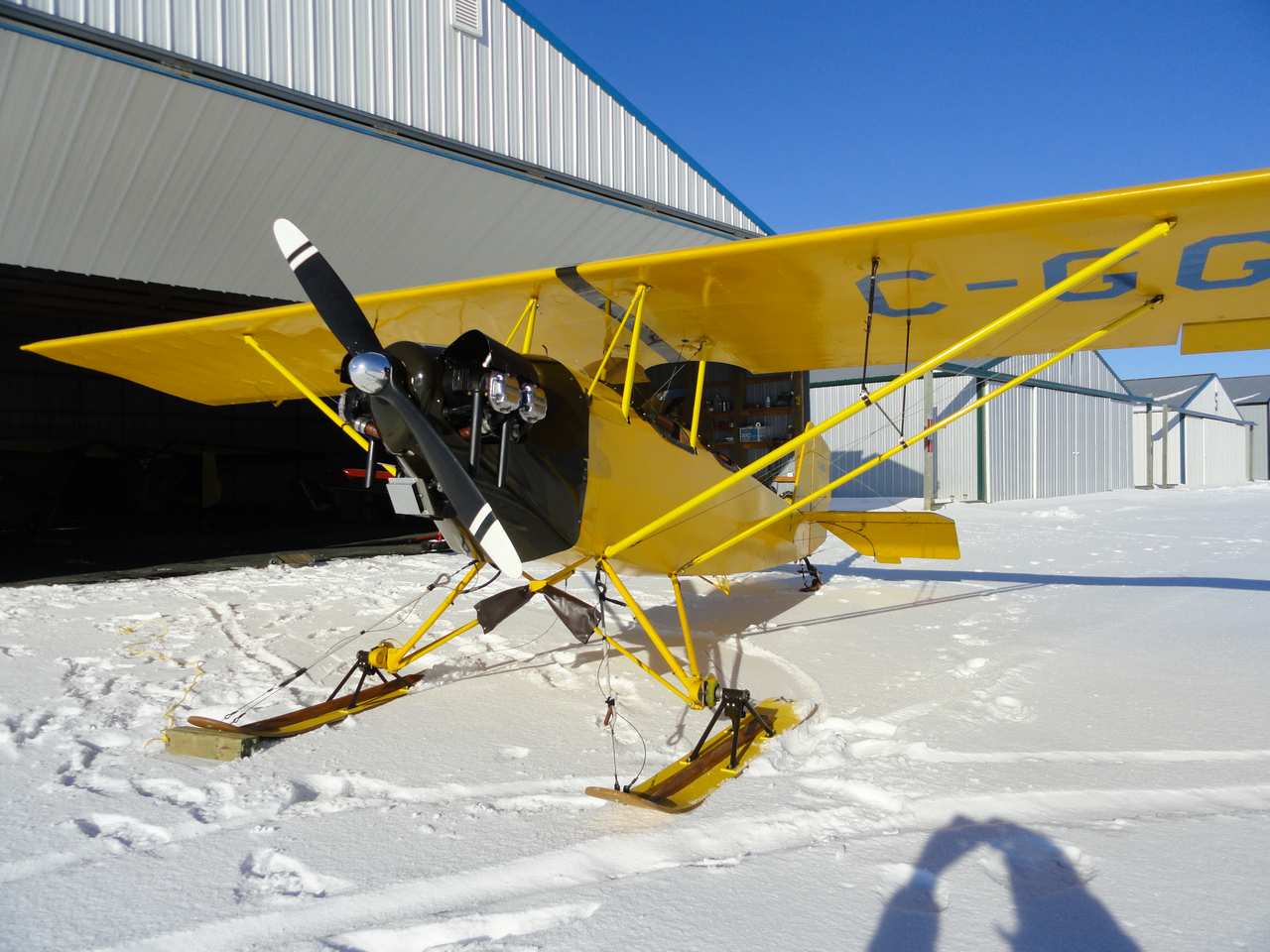

      Dan
      Yes the skis are homebuilt,  they are nothing more than aircraft ply glued up in
      a gig to a thickness of 1/2" than coated with epoxy to provide durability and
      to reduce friction over that white stuff.
      Made up a set of dolly wheels with a shaft that slips into the axles and a pivot
      arm that allows the skis to be raised off the ground in order to maneuver the
      plane in the hanger (dolly visible on hanger floor)
      You must be familiar with that white stuff in Illinois or not??
      Actually this past weekend was the first time this winter that there has been enough
      snow to take the plane out, what a blast!!!
