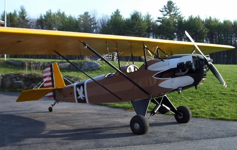

Hey Clif,
How about now?
(although technically, it's a GN-1, rather than a Piet)
Bill C.

Oh, Fooey. I was going to use that scheme. I'll have to think of something
else. C

Ha! Now we're talkin! :-)
Needs wheel pants to complete the scheme though.
Clif
> Hey Clif,
> How about now?
> Bill C.
Message 18
Yeah, but is yours a Piet? or a Grega. :-)
But remember. Hawks came in squadrons,
hundreds of 'em. If those Dawn Patrol guys
can do squadrons then.........?
Just think. You could have your very own
base at Brodhead.
Do formation fly by's. With smoke even. :-)
Drooling yet??
Clif
