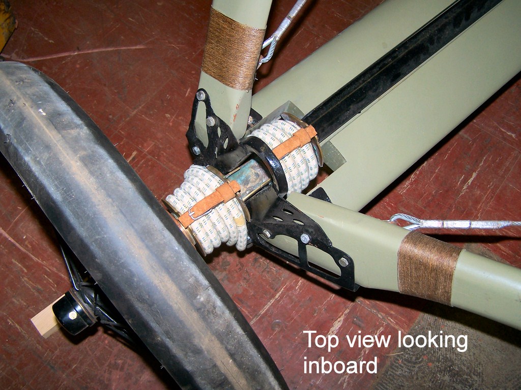

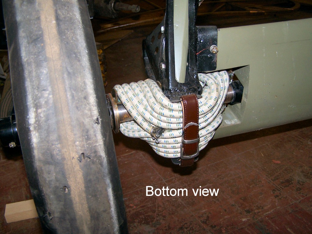

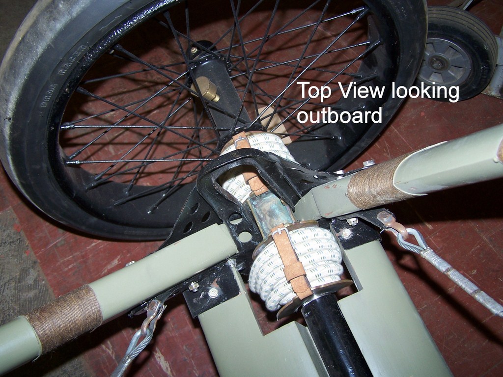

How about adding a small sleeve that will space the bolt away?- see attac
hed drawing for rough idea.- =0A=0A=0AMike Groah=0A=0A=0A=0A_____________
___________________=0A From: Jack <jack@textors.com>=0ATo: pietenpol-list@m
atronics.com =0ASent: Saturday, February 25, 2012 4:36 PM=0ASubject: Pieten
pol-List: Gear Question=0A =0A=0AGear Question =0AHelloallhope you can help
with a question.- If you look at the attached picture you will see the b
olt holding my gear spring assembly together is resting on the bolt head an
d nut.- Should I use a longer bolt (rather not) so the stress is on the b
olt shaft? Or fashion a pin with cotter keys on each end?- If I do that s
hould it be 4130 rod?- I tried to cut the head off an AN bolt tonight and
they are hard!- If I do the pin, should I harden after cutting and drill
ing?-Could it be soft steel?-So many questions, thanks for your experti
se!=0AJack Textor=0ADSM=0ANX1929T=0A<<...>>

Why not leave it as is and let the bolt head be more support. Just my 2 cents
worth--as stupid as it sounds. Gardiner

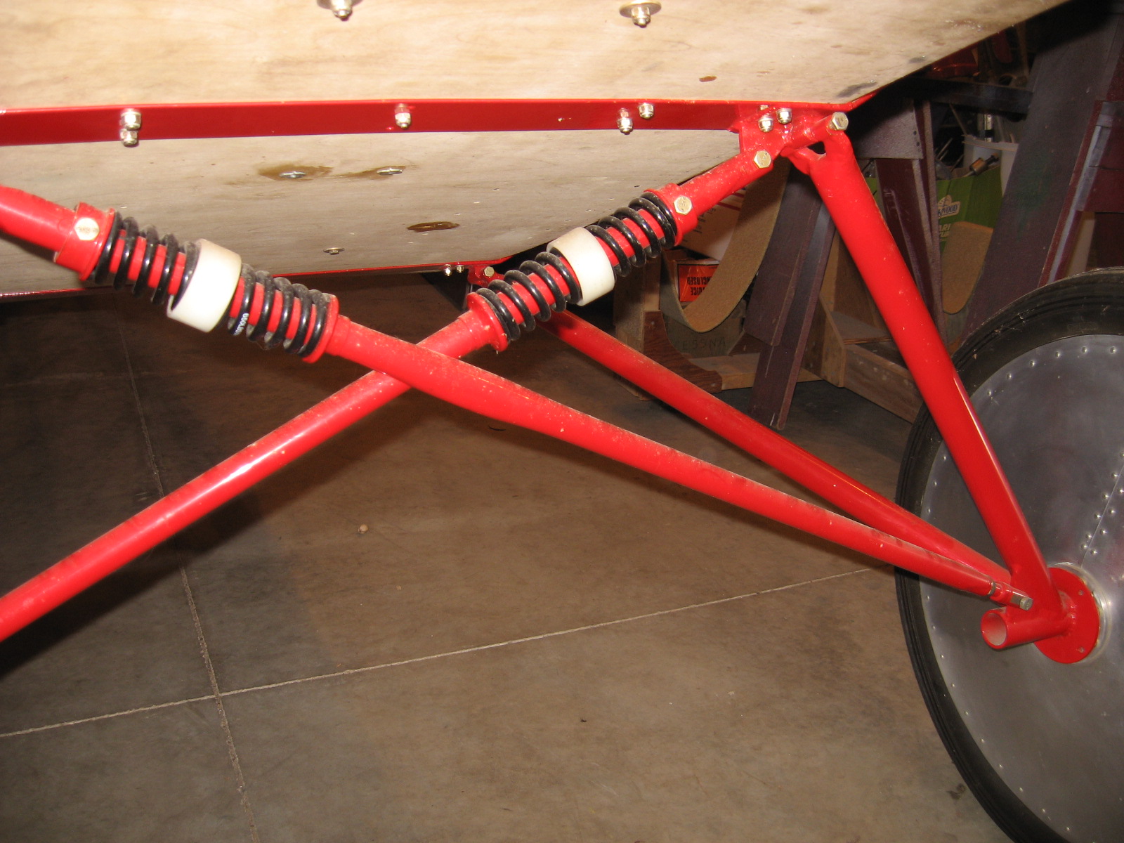

What I did.
PAPA MIKE
http://forums.matronics.com/viewtopic.php?p=367374#367374

| Subject: | Re: Gear Question |
Jack
Is the hole in the washer the size of the smaller tubing in the picture? If so,
the step formed by the larger diameter tubing above the washer and the thickness
of the washer is all that is needed to resists the bending of the washer.
If not, then can you remake the washer to have a smaller diameter hole?
I have looked at your landing gear pictures on your website but I still cant figure
what end we are looking at. I figure it must be the end that slides in the
slot because of the bolt, but then why is it welded to the smaller diameter
tubing? Doesnt the collar need to slide on the small tube? If its the other end
that does not slide, all the plans I have seen for this gear shows the washed
welded to the tube and then why the bolt?
Chris
Jack,
I would say that the arrangement in your photo is not ideal. I'm not crazy about
the idea of that washer acting on the nut and the head of the bolt. Best not
to impose bending loads on the bolt. Would be better to use a longer bolt, like
you say, but what would prevent the bolt from sliding over to one end or the
other?. I much prefer the arrangement shown in Mike's photo, with a sleeve,
and hole located away from the washer. That way the bolt is only loaded in shear.
The two designs (Bingelis and Buckeye) mentioned in this old thread utilize a similar method, with a sleeve. http://forums.matronics.com/viewtopic.php?p=329387#329387
Bill C.
http://forums.matronics.com/viewtopic.php?p=367390#367390

| Subject: | Various parts questions |
We are building a Piet for static display. It has a straight (Jenny style) axle.
We're wondering if any one could email me some photos showing the attachment
of the gear, axle and shock cords along with drawings of the parts needed. we
would like to know how many feet of shock cord we need to buy.
We are in need of a carb, magneto, and an intake manifold for a Model A engine.
[u]None of these parts need to be serviceable[/u]. If you have any, please email
me your price.
My email address is: jimbir@yahoo.com
We have also rebuilt a 1917 Curtiss JN4 and have attached photos of the gear on
it for comparison to what might be on found a Piet.
Thanks, Jim Birke
Niagara Frontier Vintage
Aircraft Group Assisting The
Niagara Aerospace Museum
http://forums.matronics.com/viewtopic.php?p=367403#367403
