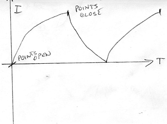

Breaker points short out the condenser (capacitor) when closed. This allows the
battery to directly (through a resistor, technically) 'charge' the coil, using
the dc electricity from the battery to build up a magnetic field in the coil.
In a magneto-driven system, the magnet wizzing by the coil induces an electric
current in the coil when the points are closed, which in turn creates its own
magnetic field. For this part of the discussion the coil behaves like an inductor.
Inductors store energy using a magnetic field.
In either system, it takes time to build up that magnetic field; it doesn't happen
instantly. That's what the dwell is for - To give the system time to store
some energy. In engine terms, this time is not trivial. When the points open,
the condenser (which has been shorted out and is empty) is now a part of the
circuit, in series with the coil/inductor. The magnetic field in the coil induces
an electric current through the condenser, which stores it up (with some real-world
losses). As the magnetic field pours it's energy into the condenser,
it collapses (this is where the coil also behaves like a transformer) and induces
a high voltage in the secondary windings, creating the spark.
But the condenser is much more than a just an added doo-dad to keep your points
from burning out (although it does that, too); it's an integral part of the system.
The catch here is that the coil and the capacitor form a resonant circuit,
known to the electronics types as an LC circuit, or a tank circuit. Mechanically,
picture a weight suspended between two springs of the same size and strength.
If you pull the weight to one side and let go, it will wangle back and
forth at a specific frequency until real-world forces dampen it and stop it.
Same deal with the coil and the condenser; it will cycle back and forth between
storing current in the coil and storing voltage in the cap. If you hooked it
up to an oscilloscope, you'd see a classic dampened harmonic motion. This repeated
cycling induces a lot of alternating voltage at a specific frequency in
the coil secondary over a decent period of time and is really where a good strong
spark comes from. Without the condenser, the voltage in the coil would change
once when the points closed and once when they opened, which, if you're lucky,
might be enough to create a weak spark. The LC resonance is the key.
This process requires that the condenser be matched to the coil to work most effectively.
The coil has a certain inductance and the condenser has a certain capacitance.
Each one of these has its own frequency characteristics. Pairing them
up creates a specific resonant frequency dependent on both components. But
if they're not matched (like a burned-out condenser), the resonant frequency
changes. Picture the spring example with two different springs.

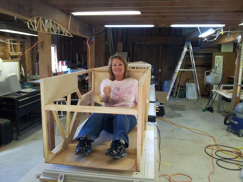

BTW, The Mrs. in the first seat below :o)

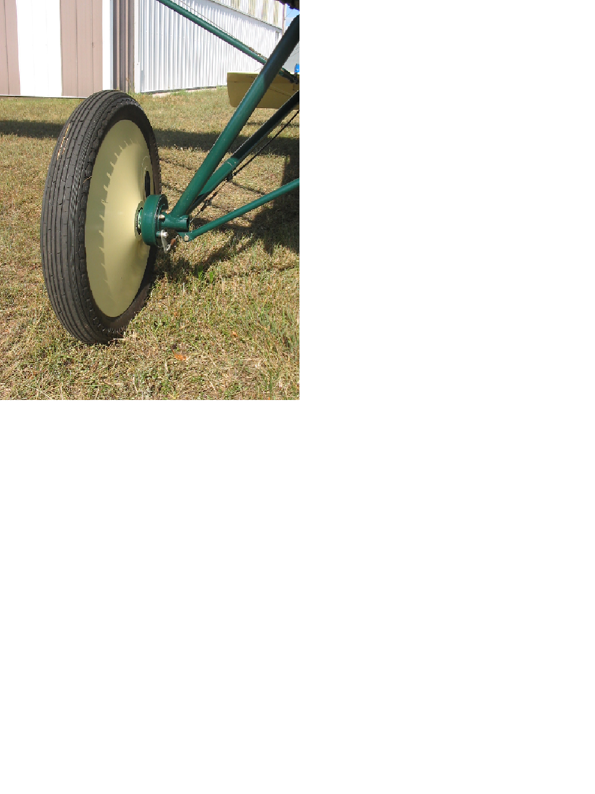

| Subject: | Re: Landing gear type: Pros and Cons, Steel or wood? |

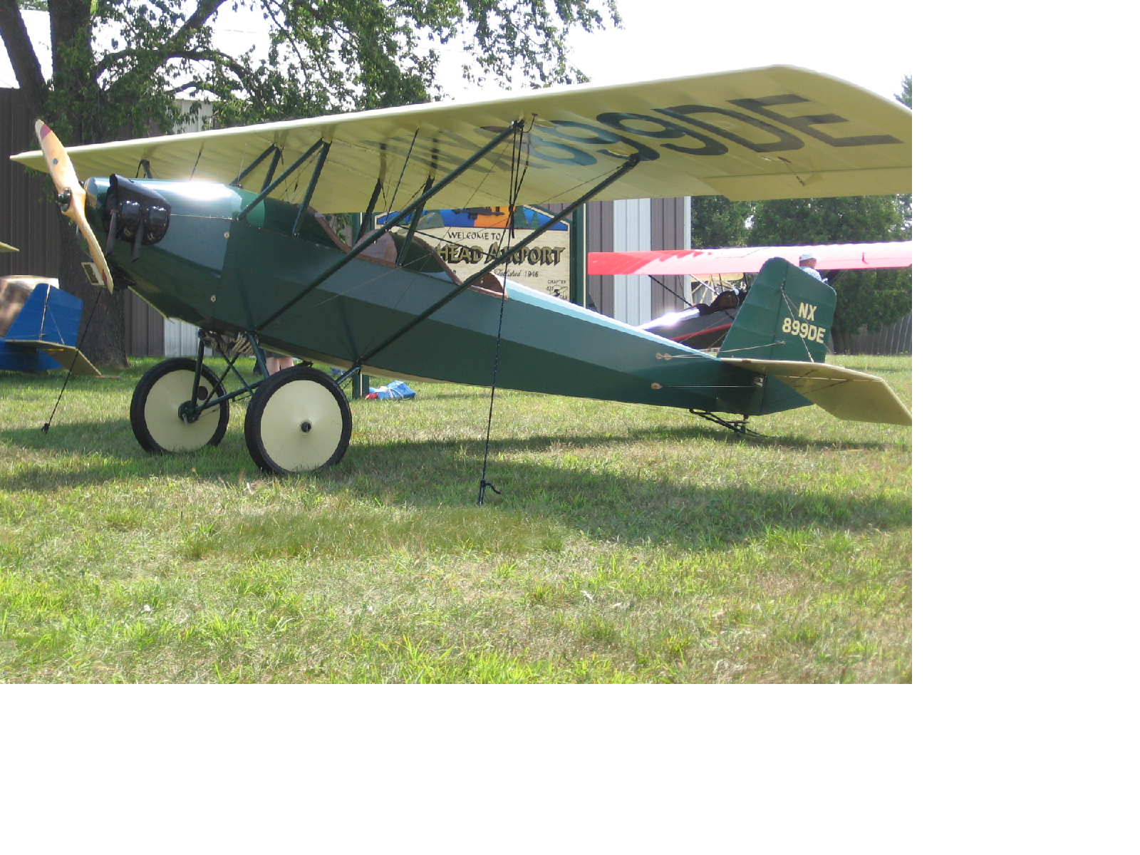

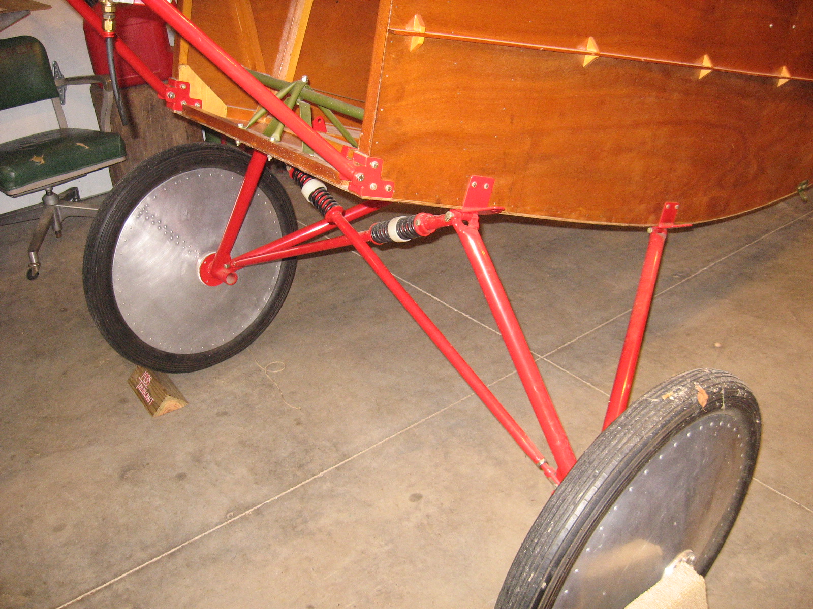

Big Wheels...spokes hiding under covers. My intent was to create a faux Bendix
look.
PAPA MIKE
http://forums.matronics.com/viewtopic.php?p=367935#367935
http://forums.matronics.com//files/img_4163_388.jpg
http://forums.matronics.com//files/img_4168_686.jpg

Mark that is looking good.-- I'm going to have to find some time to com
e up to Fresno and see that thing.- =0A=0A=0AMike Groah=0A=0Ado not archi
ve=0A=0A=0A________________________________=0A From: Mark Roberts <mark.rbr
ts1@gmail.com>=0ATo: pietenpol-list@matronics.com =0ASent: Wednesday, March
7, 2012 10:55 AM=0ASubject: Pietenpol-List: Landing gear type: Pros and Co
s" <mark.rbrts1@gmail.com>=0A=0APlease forgive me if this is redundant. I t
hought I had asked a while back, but my search proved futile. So, I wish to
tap the wisdom of this collected intelligentsia...=0A=0AI am prepping for
the Landing Gear install, thus I need to decide on the style I want. My wif
e and I both like the spoke'd tire look, so those would be the tire style w
e will use. I haven't seen those on a steel gear, so I'm not sure how it wo
uld look, or whether the added size would prove problematic to the gear str
ength.=0A=0AThe main dis-advantage to the wooden gear to me is what I have
heard about the 'wobble' of the axle in the platform that it rides on due t
o the shock cord mount. I have heard the axle will move slightly forward an
d rearward as you turn corners, making it slightly 'wiggly'. Other than tha
t it looks like an easier option to build for me, and cheaper. But, this is
the project of a lifetime, so the added work and money is not as important
as the ultimate usefulness of the choice. I will fly almost exclusively fr
om paved runways (can only think of one grass field I would fly to at the a
nnual west coast piet fly-in...).=0A=0AI am looking for pros and cons, do's
and don'ts, thoughts and suggestions regarding the choice from those that
have thought about such things :o)=0A=0AMany thanks!=0A=0ABTW, The Mrs. in
the first seat below :o)=0A=0AMark=0A=0A=0A=0A=0ARead this topic online her
e:=0A=0Ahttp://forums.matronics.com/viewtopic.php?p=367931#367931=0A=0A

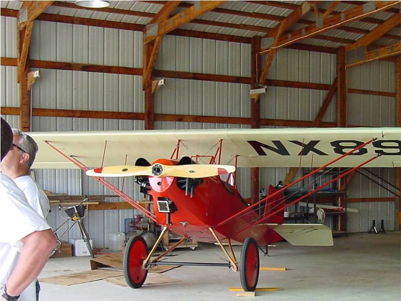

| Subject: | Landing gear type: Pros and Cons, Steel or wood? |
The main disadvantage to the wooden straight axle gear is actually the
weight. That axle is heavy, as are the wire wheels (but if you are doing
wire wheels regardless, then that doesn't matter).
As for "wobble", I've never noticed it in 260 hours of flying. I have guide
pins on my axle to restrain it from rotating when braking, and it does moved
around fore and aft a bit when braking, but nothing that is any problem at
all.
The wooden gear is extremely rugged (which is why Curtiss JN-4's used it).
The biggest advantage to the straight axle is that camber and toe-in
problems simply don't exist.
Jack Phillips
NX899JP

Skip: Yes, Sue and are are planning on being at Sun n Fun the whole time.
Jim: I think the LC resonance frequency is much higher than the system cycle frequency
which is 2 times engine speed and actually needs to be. Ignition systems
are, as you describe, an LC circuit but it isn't in resonance. Look at it
this way. The points close. This discharges the capacitor almost instantly
and current starts flowing in the inductor. Note that the capacitor is not electrically
present since it's shorted. The field builds up. If you put an oscilloscope
on it and watched CURRENT, it would start from 0 and rise on a parabolic
curve to the point where, given enough time, it would hit a maximum determined
by the ohmic resistance of the coil. If there were a large iron core
(picture a wire wrapped around a nail in science class), you'd have an electromagnet.
Some time before this steady state maximum occurs, the points open.
Current flow stops almost instantaneously. With no voltage present, the field
collapses but the energy has to go somewhere. The low voltage winding of the
coil sees a, maybe .016 air gap, but the 14 volts can't jump that. The secondary
coil, on the other hand can generate several thousand volts and can jump
your .032 spark plug gap with ease. It's the path of least resistance. Note
that when the points first open, the gap is VERY small and the collapsing field
from the low voltage winding CAN jump it. The condenser absorbs just enough
of the the current to allow the points to fully open without excessive arcing.
There is no resonance in the "tuned circuit" sense like you find in radios.
The better analogy is that the coil is an AC transformer. If you look at the
current waveform in the low voltage side, it really is a sawtooth but with curved
"sides". The frequency is determined by the physical speed of the rotating
cam opening and closing the points. I'm hoping the drawing attached makes
sense.
Note that as the rpm increases, the amount of time available to build up the field
goes down and the spark gets weaker
You are correct that the condenser and coil must be compatible. If the condenser
is too small, it won't be able to absorb enough energy to allow the points
to open cleanly. If it is too large, the current flowing when the points close
and discharge it will also burn them. Again, it's not a "tuned" circuit.
Hope this helps.
Dave
http://forums.matronics.com/viewtopic.php?p=367946#367946
Papa Mike - very nice looking wheel covers!
Gary

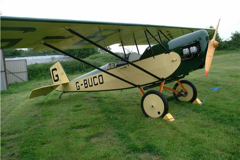

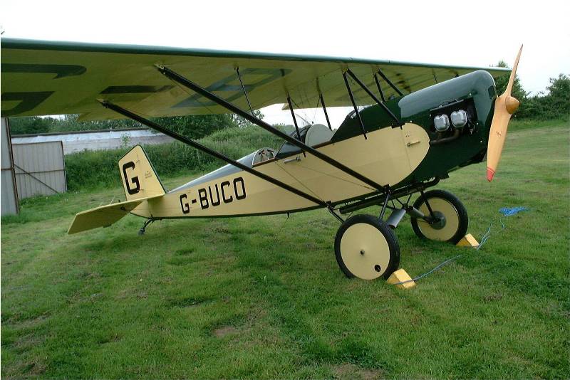

Message 13

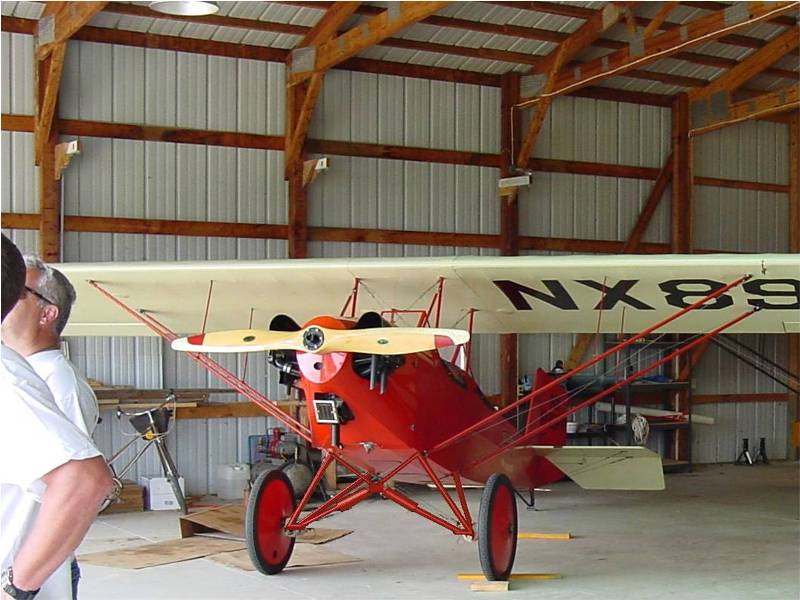

Mark
I was in the same boat as you a few years ago. I did the same kind of mission
evaluation and have a similar paved runway outlook as you. It made me think the
split axle would be better. However, after asking around I could find no reason
not to build the wood gear. One big deciding factor for me was I just didnt
have the confidence to build the steel gear and I needed to get the project
moving as other parts had frustrated me to the point where I wasnt working on
the plane anymore.
While trying to decide between the two I modified the attached pictures to give
me an idea how the landing gear choice would change the overall appearance of
the plane. For me the final look of the plane is very important. Basically I
would pick the one you think looks the best.
Wood Gear Pros:
Vintage look
Unique
No toe in or toe out problems.
Simpler to build.
People question your sanity.
Cons:
The axel and spreader bar are close to the ground and might catch on tall grass

There are quite a few out there that have the wire wheels and the split axle gear.
I chose to cover mine. Mr. Pietenpol went this route with 12988 and left
them uncovered. I'm happy with the set up. Other than changing bungees every
couple of years it works out well.

Mark,
Your getting Mrs. Roberts emotionally invested.smart man! Has she had a ride
yet? Maybe this year with Charlie Miller?
There are a couple ways to steady up the axel, though I have never heard the
complaints you mention (at least, not in the form of a complaint). 'Tools'
brings up a good point, having once suffered the failure of a welded gear
myself. Similar to points vs. electronic ignition on our Corvairs, points
will usually give you symptoms of an upcoming failure, while electronic just
quits.same with welds vs. wood, although Kevin explained a process that he
used to build more reliability into his welded gear. In the end, I think you
have to decide which looks better to you. I am told that pretty women
literally swoon when a wood gear, wire wheeled Piet rolls up.but that may be
a rumor.
Mark

Unfortunately, Don, the straight axle version also requires changing the
bungees every couple of years - my least favorite airplane task in the
world.

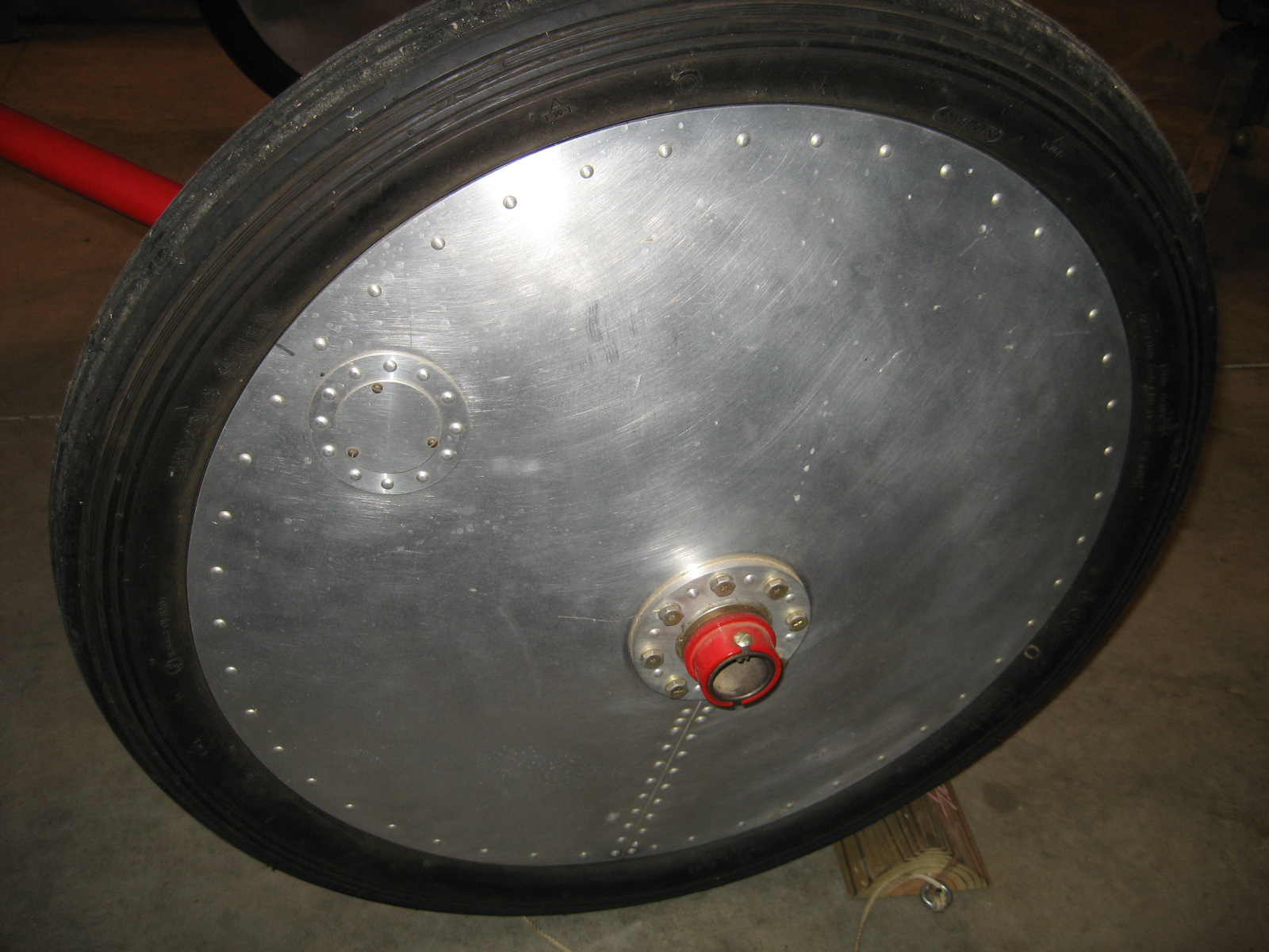

How did you make the wheel covers, and how are they attached to the wheel?
Surely they are not riveted to the rim?
Ray Krause

FWIW. 280 hours since 9/09 including two trips from Austin, TX to Brodhead. Only
issues were the result of my welding. I changed from bungees to springs as
Mike Danforth mentioned, for good, solid reasons.
