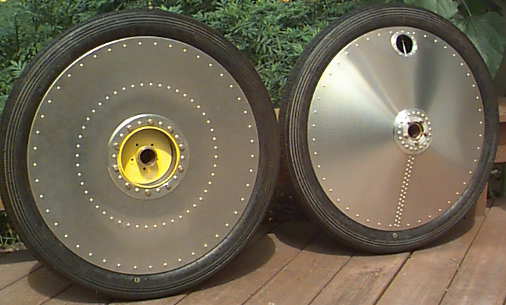

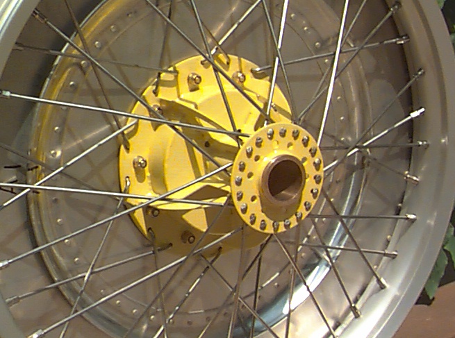

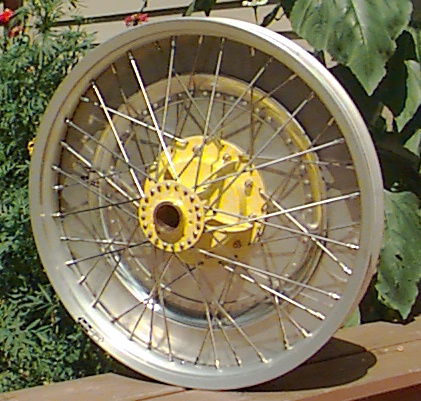

> Papa Mike,
> How did you make the wheel covers, and how are they attached to the wheel?
> Surely they are not riveted to the rim?
> Thanks,
> Ray Krause
> Sky Scout in progress
Ray,
The wheel covers are a conic development. Started with flat sheet and calculated
the diameters to produce the desired "cone". The covers are bolted to the flanges
of the hub. The rivets in the periphery are purely cosmetic. The wheels
shown in the pic were my prototypes. The attached pics show the final version.
A lot of work....but they sure look neat! I designed them to use the early Tri-Pacer
mechanical brakes.
PAPA MIKE

Love the wheel covers too Papa Mike!

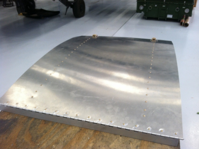

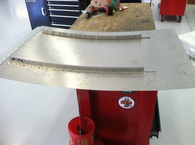

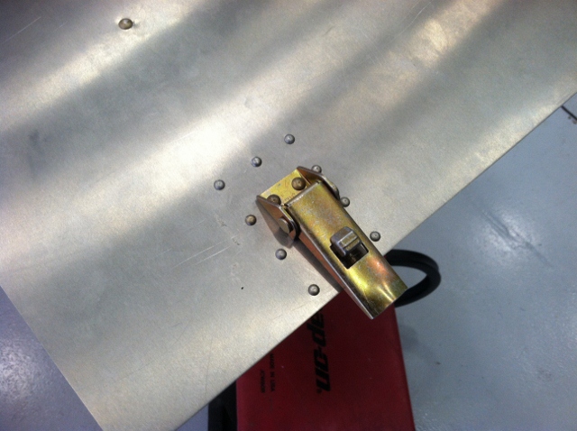

Just would like to thank Mr. Cuy for giving me this idea for the center wing lid.
Here is my version so far..

Thanks, Mike!
Beautiful work. Is that wheel convex on only the outside? In bicycles
that is called "dished", as in the rear wheel with an 8-10 speed cog. Looks
as though only the outside of you disc is convex.
Thanks again for the wonderful pictures. Now I have another project.

> Ray,
> calculated the diameters to produce the desired "cone". The covers are
> bolted to the flanges of the hub. The rivets in the periphery are purely
> cosmetic. The wheels shown in the pic were my prototypes. The attached
> pics show the final version. A lot of work....but they sure look neat! I
> designed them to use the early Tri-Pacer mechanical brakes.
> PAPA MIKE
