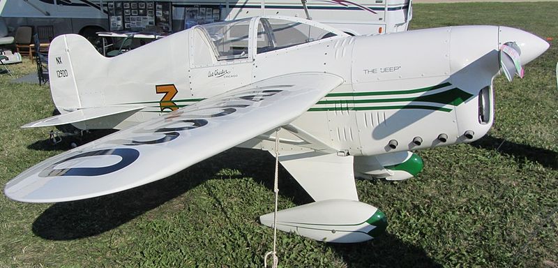

Message 7
| Subject:  | Re: louvers for cowling area |
      Mike,
      I saw Lon Dienst making the louvers on his Art Chester Jeep replica.  As I recall,
      he basically drilled two holes on either end of the louver length and joined
      them with a single cut line and then bent metal.  I am sure it was not as easy
      a task as I made it sound.  I know he pitched a few pieces before getting
      it right.  This picture does not show the louvers all that good, but they are
      visible.  I think the bends are a little less aggressive than you show in your
      sketches.
      Good luck,
      David Gallagher
      Zodiac 601 XL-B: flying, 200+ hours now
      Next project under construction: Aircamper
      http://forums.matronics.com/viewtopic.php?p=369956#369956
      http://forums.matronics.com//files/800px_art_chester_jeep_replica_205.jpg
Message 8
      Mike,
      That's a neat little plane! Any idea what engine?
      Gary Boothe

Message 10
| Subject:  | Re: Jeep Replica |
      Gary,
      According to this video, it's a Menasco D4.
      http://www.youtube.com/watch?v=5xhDs62G6r4
      Bill (not Dave or Mike)
