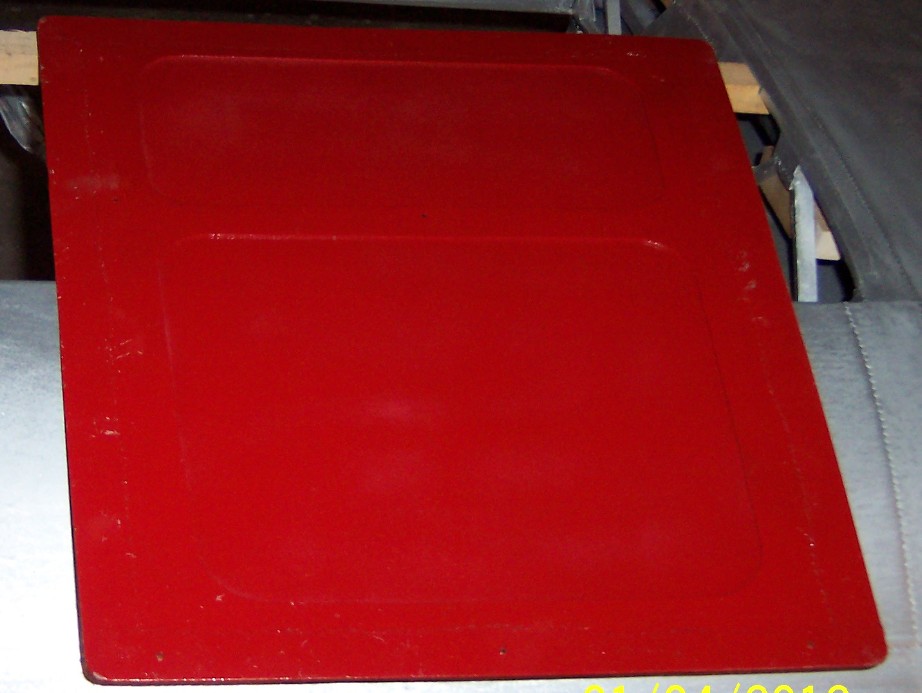

Message 6
| Subject:  | Re: Wouldn't it be better if. . . |
      Jim
      Here is a sketch Mike Cuy drew of his access door.
      http://westcoastpiet.com/images/Mike%20Cuy%20A-65%20Piet/images/Piet_belly_a
      Chris
      Sacramento, Ca
      Westcoastpiet.com
      -----Original Message-----
      [mailto:owner-pietenpol-list-server@matronics.com] On Behalf Of flea
      Sent: Friday, April 06, 2012 11:10 PM
      Subject: Pietenpol-List: Re: Wouldn't it be better if. . .
      Weight is always a concern, and one I have thought about. But like I said,
      or meant to say anyhow, it is very open with it removed. I hadn't thought
      about an aluminum panel on the bottom though, that might well be a better
      idea.
      What prompted the question is that I have studied literally hundreds of
      pictures in every stage of construction, thank you everyone that has
      uploaded to west coast piet. And have never seen that in there. figured
      there must be a reason. Anyway, AL panel on the bottom sounds like a better
      idea. Thanks.
      Jim
      http://forums.matronics.com/viewtopic.php?p=370194#370194

      I made an aluminum sheet frame and cover it with fabric. It is not very heavy and
      seems to work fine. The picture is of the inside showing the frame.
      Jerry Dotson
